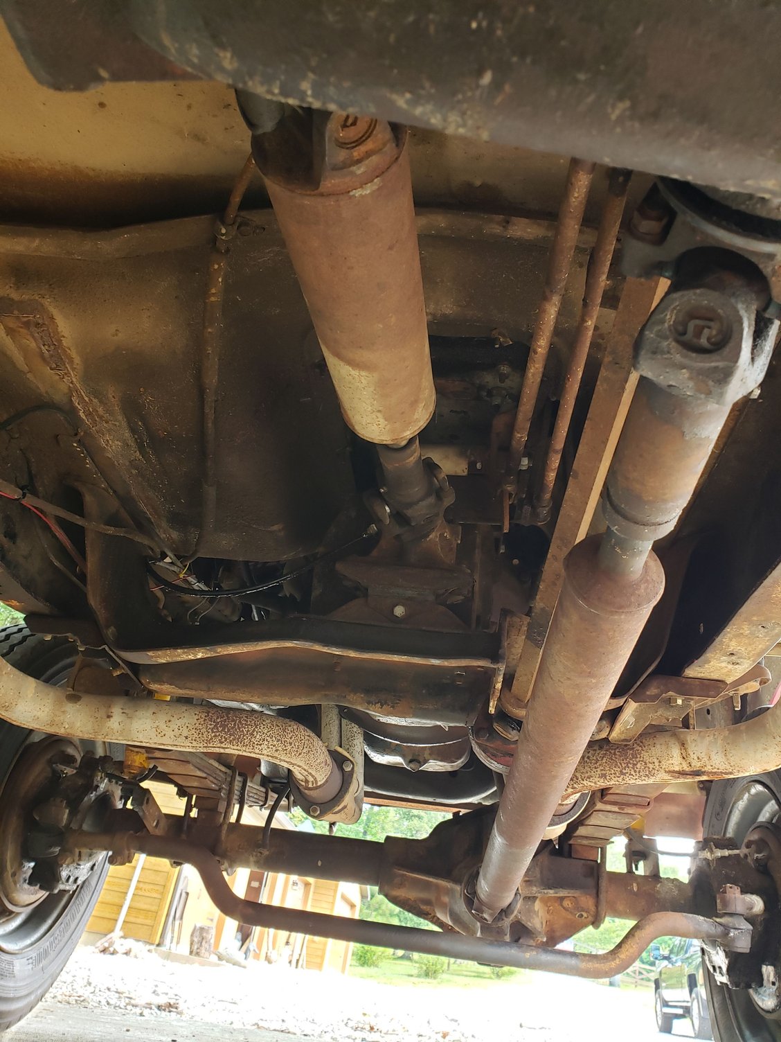

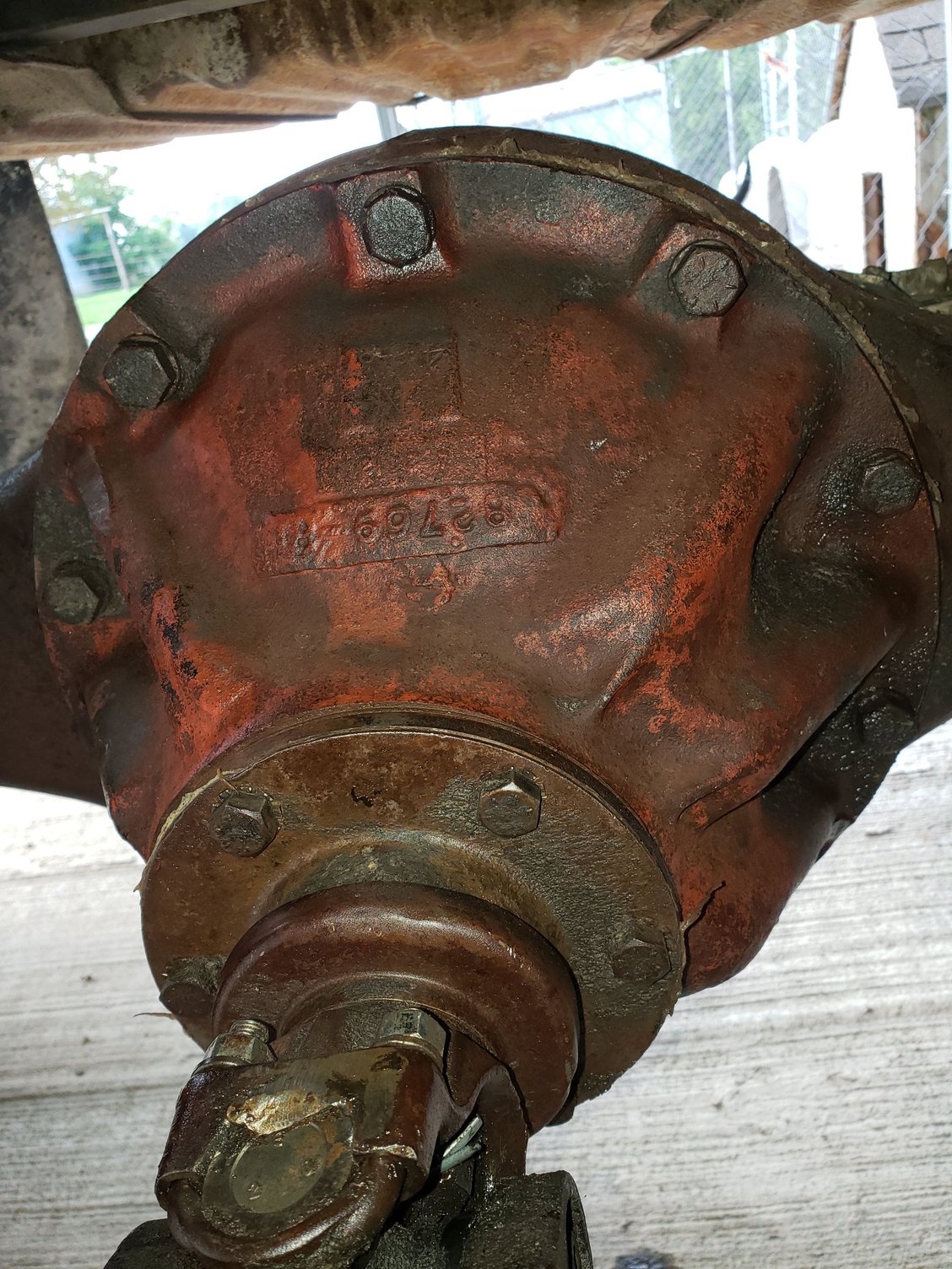

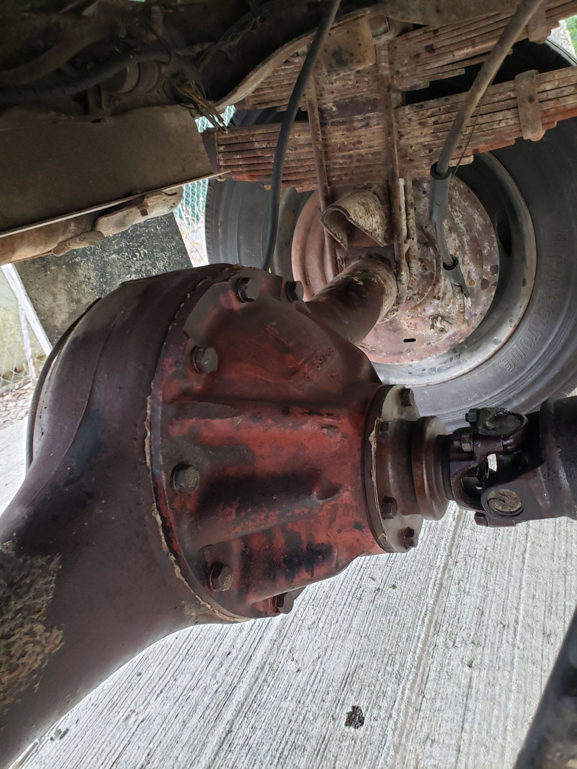

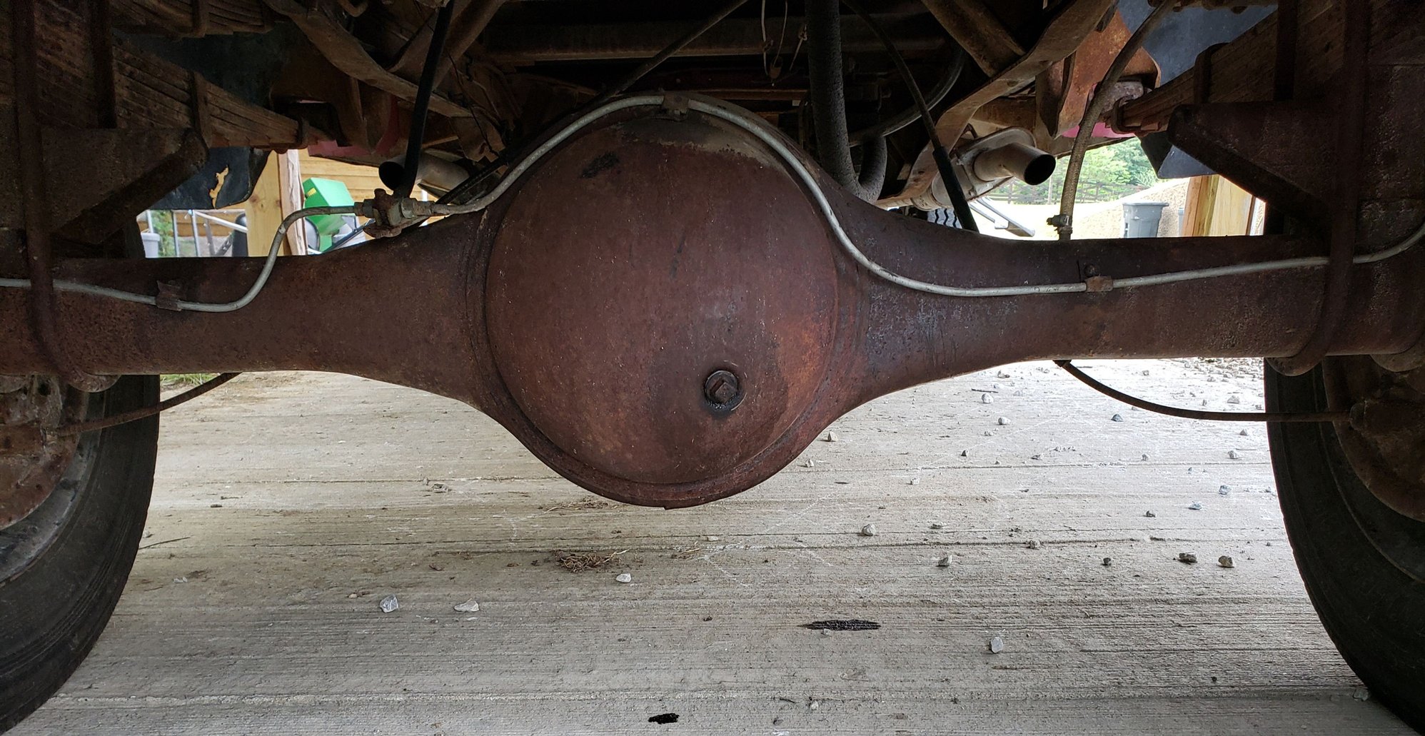

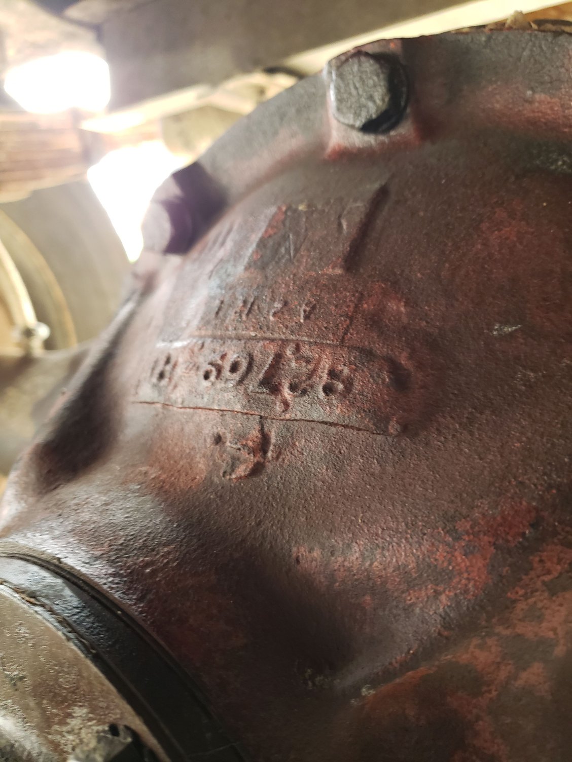

Here's a little history on this truck. I saw it parked at a guys house, I contacted him and he told me it wasn't for sale (of course). So I asked him that if he ever wanted to sell it, let me know. A year later, he called and said he was done hauling gravel and the truck was for sale and I had dibs. HOW MANY TIMES does that EVER work out! I've had High Boys in the past but this one is WAY different. I am thinking it's probably built from 3 or more trucks. The truck is now mine and I am trying to get it all figured out. It runs and drives spectacular and the dump works great. The cab is is from central California, according to the VIN it was a 1979 F-100 4x4. That is for sure not the case now!
It does have a few leaks from seals which will be replaced soon. Here are some pictures, any help would be appreciated.
What chassis is this?
Final answer on the Rearend?
Thank you!
Does the chassis have this cross member?
How long is the wheel base? Is there any signs of the frame being spliced like a diamond shaped plate on the outside of both frame rails?
On the rear axle is there any additional information in the areas designated in the first illustration I posted?
