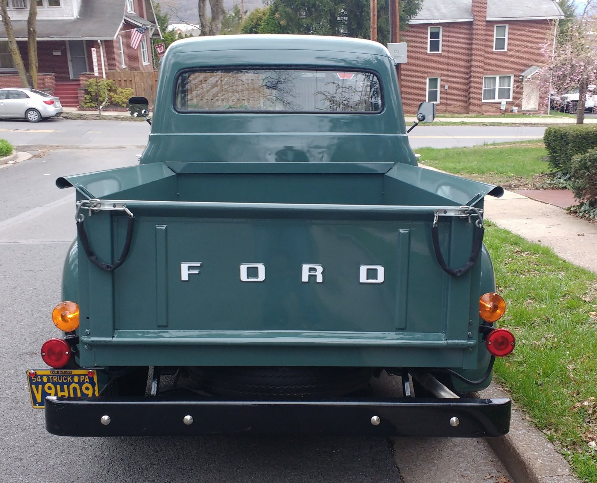

Or just get one of these bumpers and be happy don't worry...
