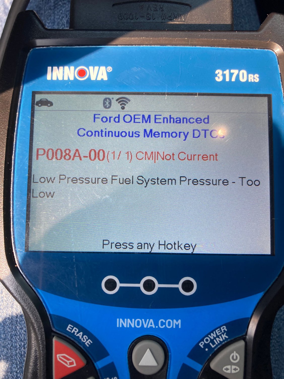

I was able to pull up a code P008A-00.
Also wanted to add the water in fuel sensor never came on last week. I drained about 4 oz’s of water out before I changed the filters.
I’m trying to see if I can scan pressures with this tool. Edit: this scan tool isn’t able to read pressures.

P008A might be the switch but here is some good reading
https://oregonfuelinjection.com/serv...l-diagnostics/

  1. If your scan tool shows low fuel pressure cranking, check the low pressure fuel supply first. This can be done by monitoring the fuel delivery switch on your scan tool. This switch will read “low” if the low fuel pressure is not correct. If the low side pressure is good, it will read “not low”. It is also a good idea to check supply pressure with a gauge. The minimum pressure allowed before the fuel delivery switch engages is 52 PSI. Normal pressure is between 53-73 PSI per Ford.
I know your truck runs, but still a good idea to confirm pressures. Could be just a sensor but weird it's happening at the same time as the WIF light. But with electrical components. anything is possible I guess.
