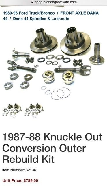

Here is what Bronco Graveyard says you need to convert.
https://shop.broncograveyard.com/198...uctinfo/32136/

That kit isn't too outrageous depending on the bearings. If they're Timken or similar that's decent. If they're a house brand then I'd say that kits a bit expensive.
The axle shafts are about 100 each at Rockauto. Didn't even see the spindle available.
Milemarker hubs are like 150-200 themselves I believe for the premium ones.
But it is nice to have a pick and pull. Get everything for 100 or so maybe. Rotors and joints are cheap.

This site shows several different spindles, and it looks like the top-hat style spindles are significantly different. I would grab a set off the jy donor. Keep in mind at some point Ford went from 6 bolt spindles to 5 bolt for the later trucks. If your knuckles are studded for 6 bolt flanges, you'll want a donor with 6 bolt spindles (or, grab everything knuckles-->out).

Spindles and outer stub shafts are different. As you know the rotors for the top hat hubs are one piece while the other more common style have a two piece rotor and hub. Basically you need everything from the knuckles out. I have never seen where the knuckle had more studs for one type than the other. That would have made it more expensive on the assembly line and if that was the case then you would see new knuckles included in the JBG conversion kit.

Notice the spindles in the conversion kit are 6 bolt mounts, so they'd bolt right up to the knuckles on the top-hat trucks (which are 6 stud knuckles), no need to include knuckles in the conversion. Where you'll run into issues is using later model OBS parts to do the conversion, because they are 5 bolt mounted spindles. Ford probably went from 6 hole spindles to 5 hole spindles to cut production costs. Then in '95 they changed spindles again to use a 2 piece wheel bearing seal (still 5 bolt mount spindles). There's also the ABS cutouts on some, though you can use ABS style spindles on non-ABS trucks (my '96 is this way).
Good call on the different stub shafts, great time to go to the latest Spicer 5-760X U-joints in there too.
