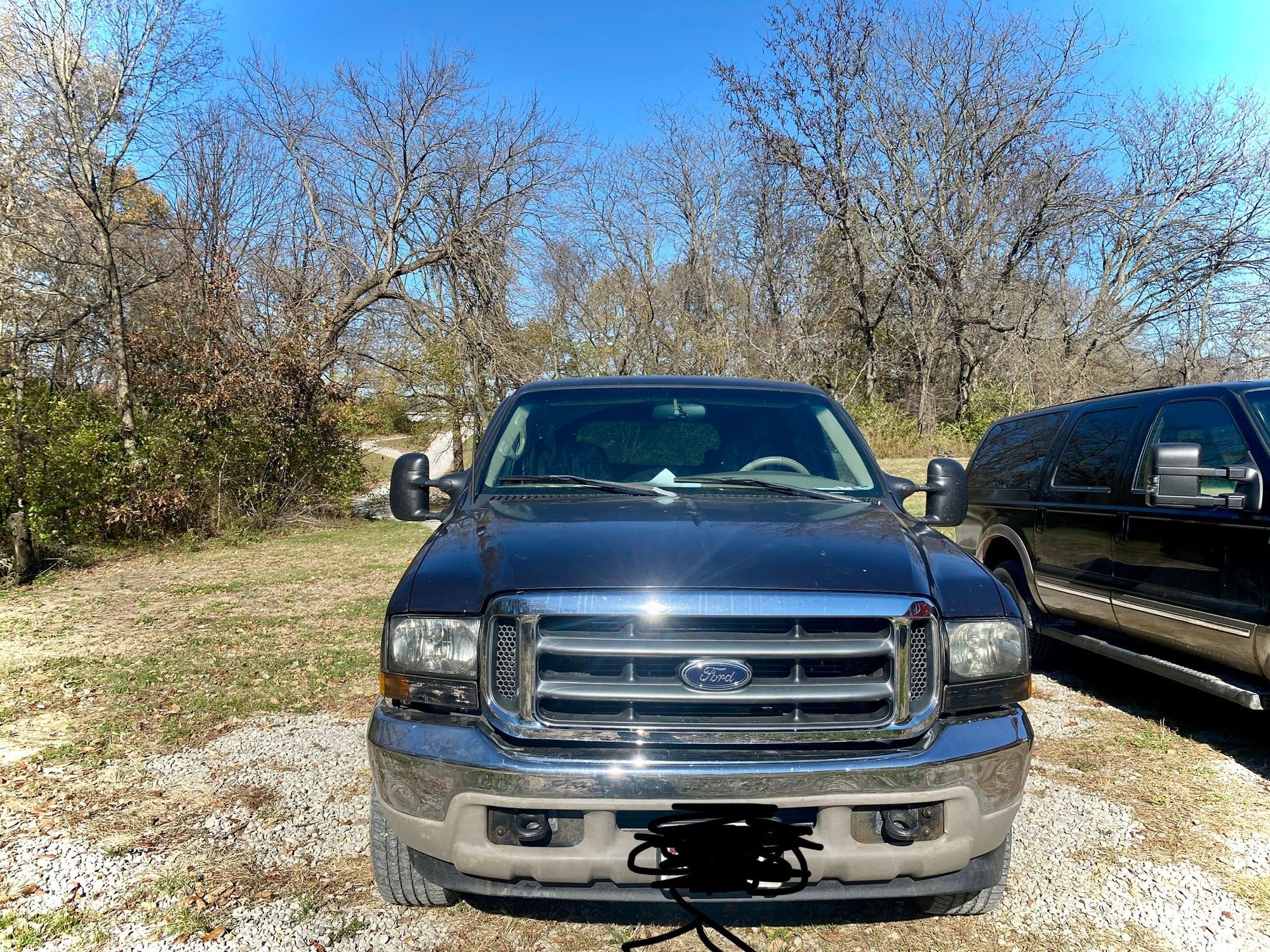

Ok, well, I imagine if other folks are like me, their project vehicles are a 'work in progress' constantly. I don't imagine I will get to everything that needs to be done quickly (time, finances, life) but the critical stuff will be done before I need to actually depend on it for transportation. So the fun begins!
I posted recently about this 2000 V10 Excursion I found for sale nearby. After getting some good feedback from the nice folks here, I went ahead and purchased it. Some photos will be below.

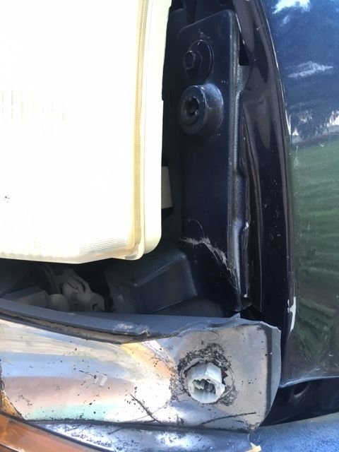

The vehicle was in a tussle with a deer at some point. The corner of the bumper appears to be bent, a little bend on the fender area, not too bad. I removed the broken signal light, and the header panel is cracked in the corner. The damage doesn't appear to go any deeper than this. So it seems like a new header panel and light assemblies might be in order. I suppose the bumper can wait for awhile, being a more costlier item. Since the lights look to be original and past their prime, I'll probably go ahead and change all of them out.
I did some troubleshooting on the blinker issue I had previously posted about. I replaced the square relay located under the steering column. The flashers work. The right turn signals work, but the relay makes an awful racket when they are activated. I'm suspecting the multi-function switch could be the cause of this? That will probably be my next part to switch out.
Looking forward to having a second massive family hauler to utilize. The diesel excursion can be saved for making longer trips. This one can be used closer to home (especially to allow the opportunity for any unforeseen problems with an unfamiliar vehicle to manifest themselves).

That's always been my favorite color combo for these big wagons.
If you are looking to upgrade the headlights and you need a new header panel that allows for the opportunity to move up to the '05-'07 style headlights with the matching header panel which wouldn't require the cutting the original headers do to fit the newer lights.
I see that it has the factory style towing mirrors, do you know which gears it has?

Yes as w3zes has stated the 05-07 headlights are a noticeable improvement. I did this to mine and it was worth it, even cutting up the panel. However the bulbs are a different connector. Riff raff diesel sells the connector adapters though, so no cutting required,makes it plug and play.

Thank you both for the feedback/advice! I think doing the upgrade now makes a lot of sense. Question - could I do the 05-07 headlight/header with the existing bumper/grille, or would those need to be switched out to 05-07 too? The grille has a few broken spots but is serviceable. It appears that it would be fairly inexpensive to change out the grille vs adding a different bumper. I thought I had read somewhere in another thread that starting in 05 the bumpers were a different design/configuration.

Yeah, it seems that most, if not all '00s didn't have the axle codes on the door jamb sticker. And the old rule of thumb of under 2K RPMs at 60 MPH is 3.73 and over is the optional 4.30s may not be reliable due to the later model wheels and maybe taller tires.
The header panel shouldn't affect the bumper at all, so you should be able to run the original bumper and either a stock replacement grille or one of the '05-'07 grilles that has had the bottom trimmed to fit an '00. Would make for a nice fresh facelift if you like that style. And yes, the bumpers did change to a different design in '05.

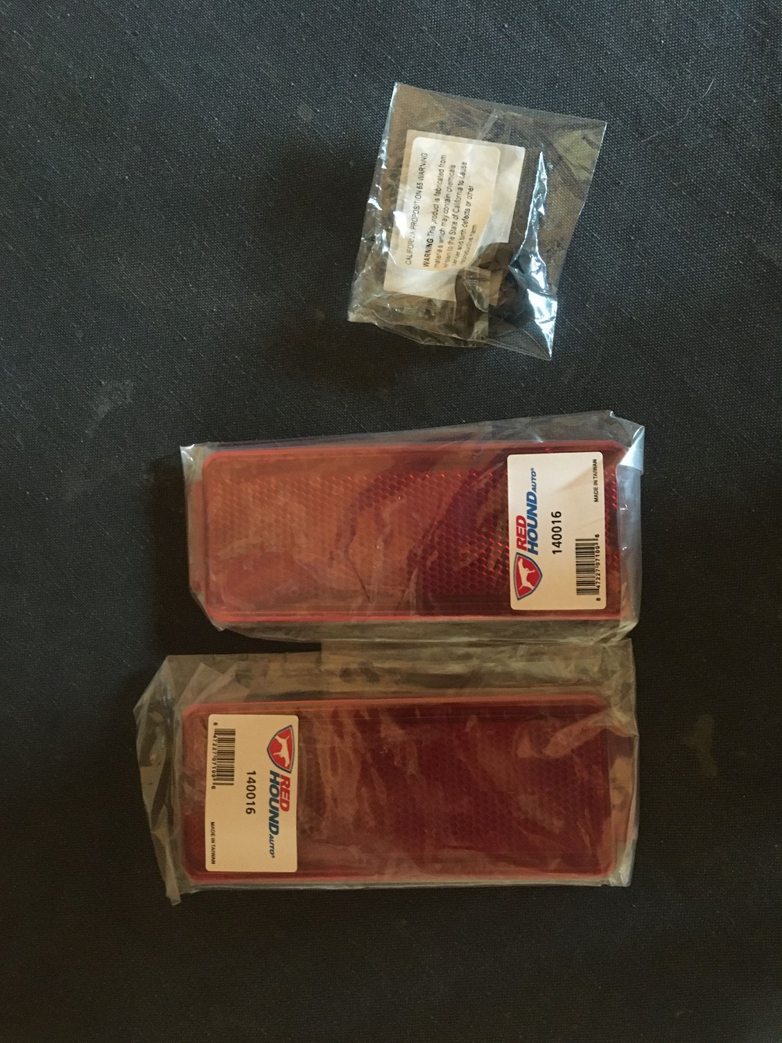

First order of small parts came in today. I’m missing one of the lenses on the front door. Since the clear/red ones are hard to find, just going with red for the time being. Shift lever was missing the top cap, so time to put that back on. The lever is really loose, so I’ll be taking that all apart and seeing if I can get things tightened back up.
