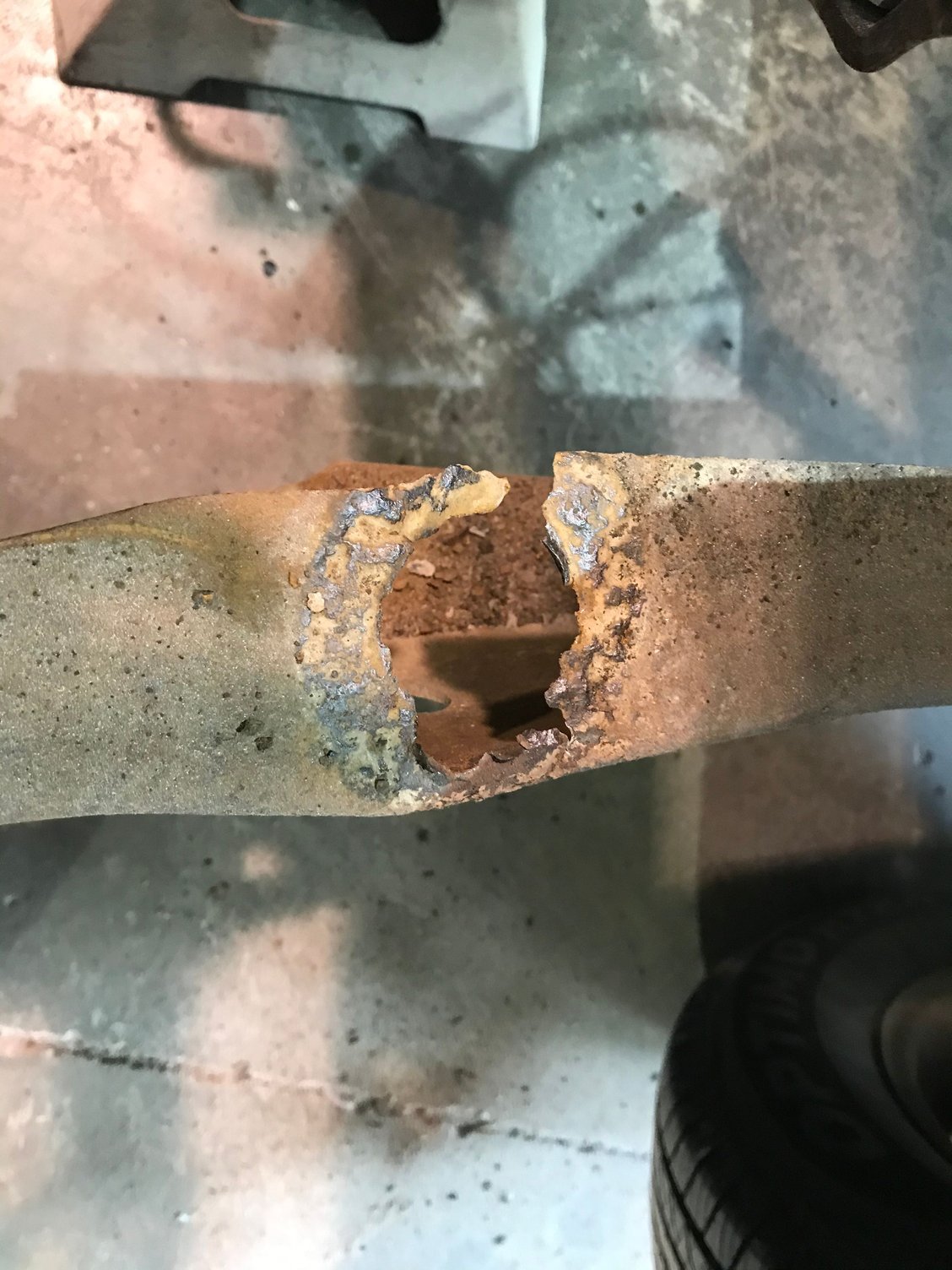

This is the type of rust you may encounter that needs repair:
https://cimg6.ibsrv.net/gimg/www.for...686f2f8706.jpg
It's a clean California truck, I would have found something like that long ago. But thanks, appreciate it. How much time do you suppose I should set aside for this little project?
If there's no rust (usually a big "if" on these year trucks!), it won't take long at all.
Just remove the bolts, jack it up slightly to take the pressure off the rubber so you can slide the old one out , put the new bushing in, drop the bolt through, lower it down and tighten Repeat as needed.
Mine was a bit harder than that
Ooh, that's pretty ugly, but I've seen worse. I've already been under the floormat and addressed the surface rust found there.

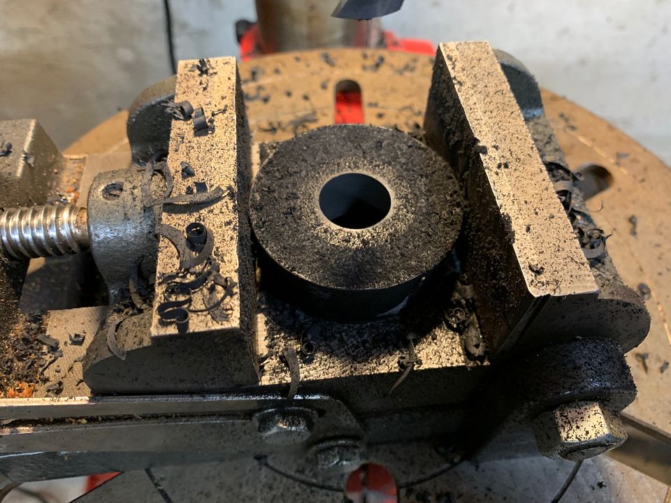

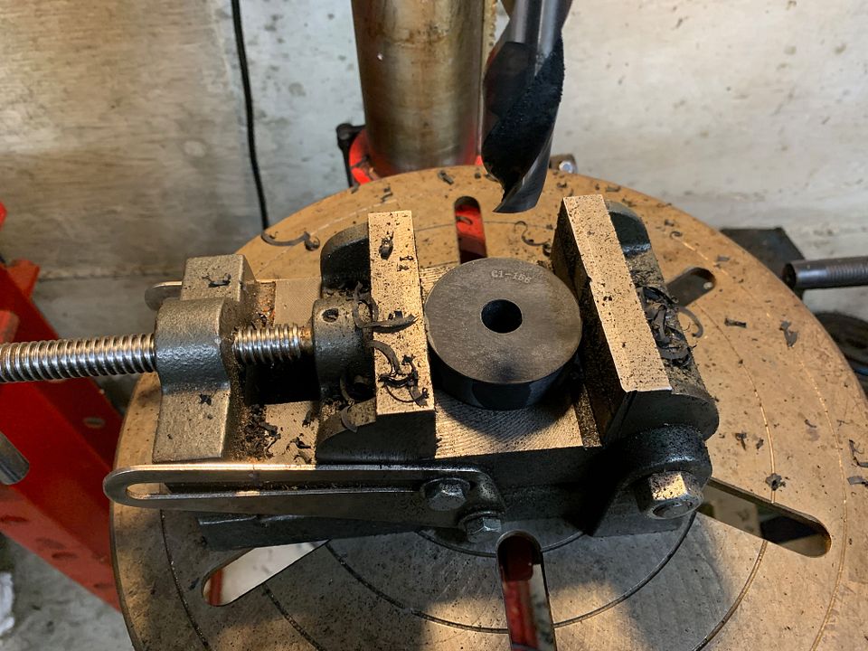

On my 1966 2WD truck (1965/66 F100/250 2WD and 1966 f100 4WD are different than others for front mounts) on both the front and rear mounts it used the larger outer (upper) and smaller inner (lower) retainers. My truck is a deep So. Cal. truck with minimal rust but those upper and lower retainers and the bolts that pass through them were crusted well enough it was nice to have the cab completely removed when dealing with them. I still used a sawzall to cut them off since I had new ones. The body mount kits use large washers instead of these retainers so I just used the rubber pucks from the kit and bored them out to fit these retainers.
I froze the pucks and drilled them out to 13/16" inner diameter to fit the stock type of retainers front and rear.
I like that. I have tried to drill through rubber bushings so many times with absolutely no success. I will be freezing them from now on! How did I not think of that in all these years?
