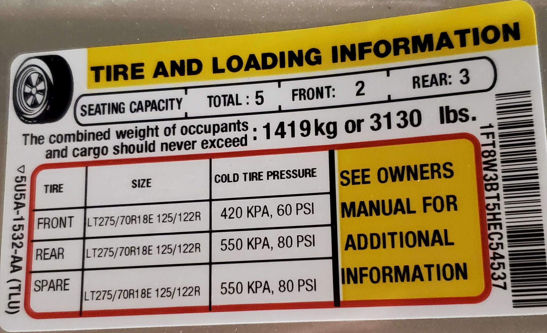

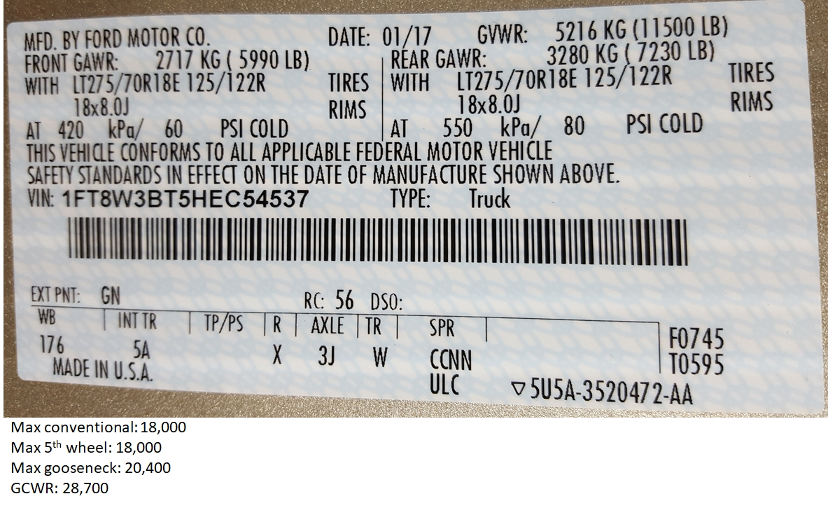

All you get is the payload/cargo capacity (second image) and the GVWR/axle ratings (first image). Below the first image is what I came up with for my tow ratings based on what I found in the Towing Guide.

I think I did a poor job of telling him my thoughts. I was trying to convey that he was going to run out of payload way before he ran out of towing capabilities.
He may be able to tow a 12k flat trailer and be ok, but a 12k travel trailer would be nearly 1600 lbs of tongue weight to deal with. That's fairly high for an F-150.
He was asking about towing and secondarily payload, and I think I just didn't explain it well enough..
