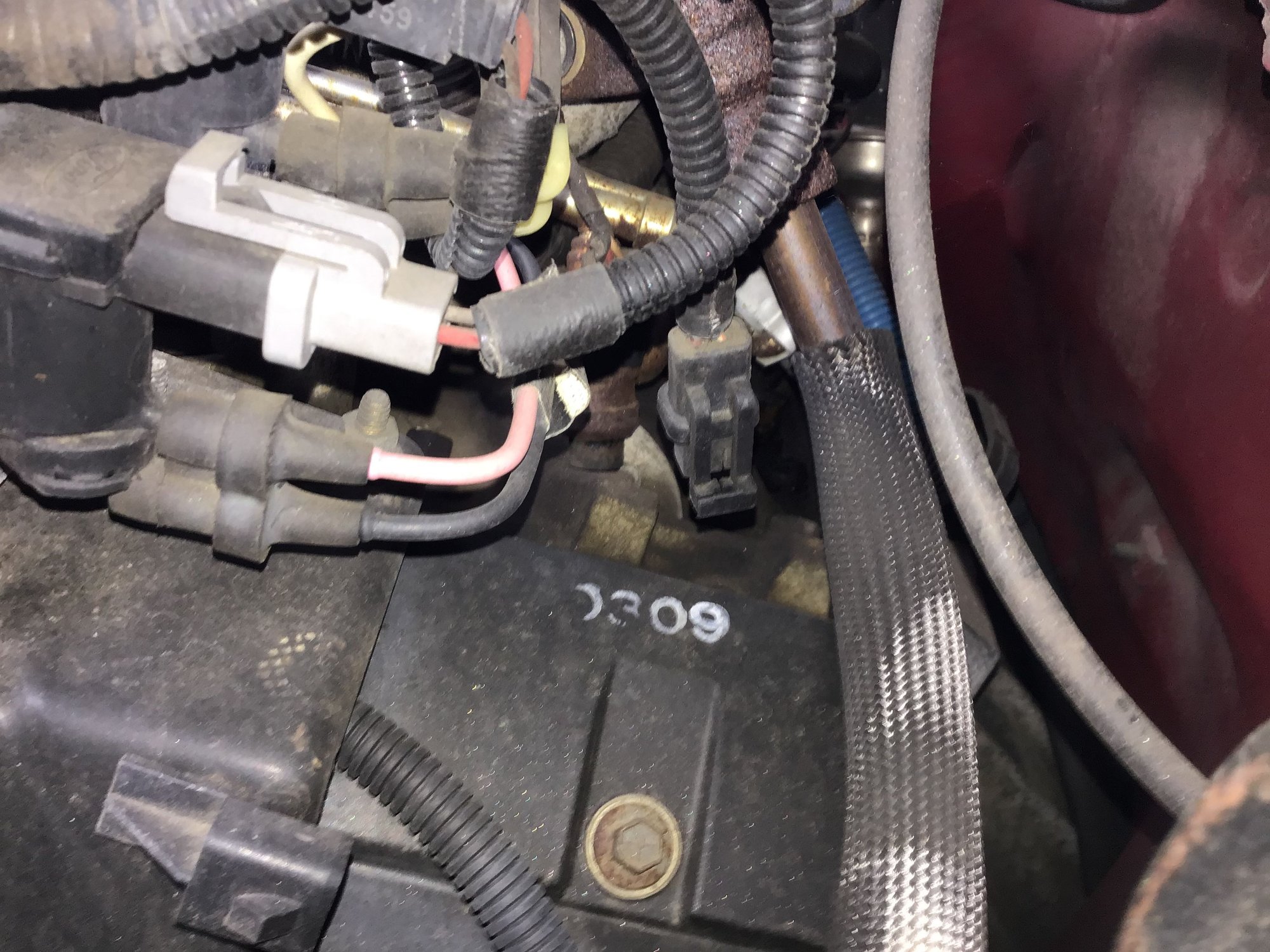

Some pics at the driver side rear of motor

There is no connection code before it starts flashing active codes.
