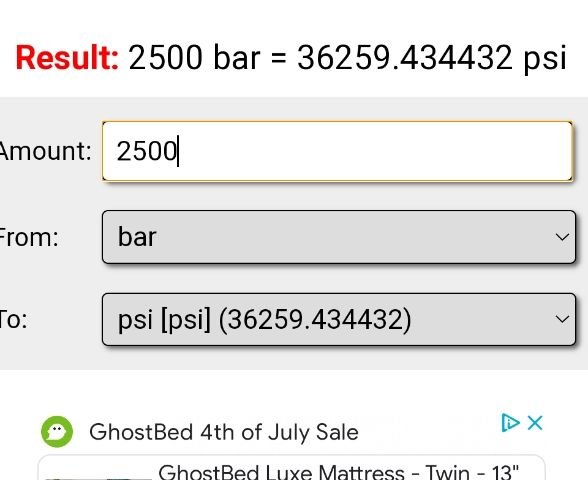

From Denso's website:
https://www.denso-am.eu/media/103774...eaflet_web.pdf
From page 2:
Diesel Components Unique choice, quality and performance are only some of the benefits of choosing DENSO Aftermarket for your replacement diesel parts. With DENSO Corporation renowned as the third largest common rail diesel player in the world, our aftermarket ranges also benefit from an unrivalled original equipment heritage. DENSO has made decades of extensive R&D investment, often in partnership with major car makers, to pioneer increasingly efficient, powerful and reliable diesel engines with minimal emissions. For example, we introduced the world’s first 1800-bar common rail fuel system with Piezo Injectors, and the world’s highest common rail injection pressure of 2,500 bar, helping to increase fuel efficiency by up to 3 percent. So when you offer DENSO Diesel Components, you can be sure of providing the very best parts to your customers – that can be trusted to meet the needs of today’s extensive, demanding diesel car market.
Using a convertor:
