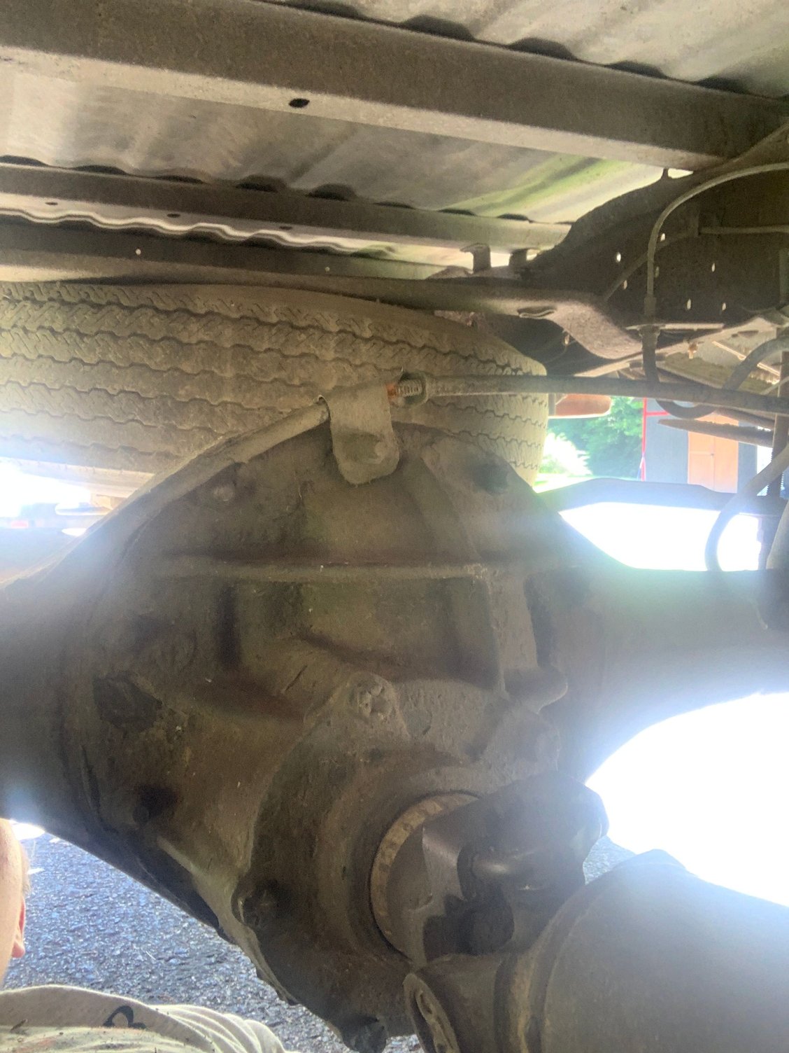

I have a 1983 f150 4x4 I need help identifying my diff

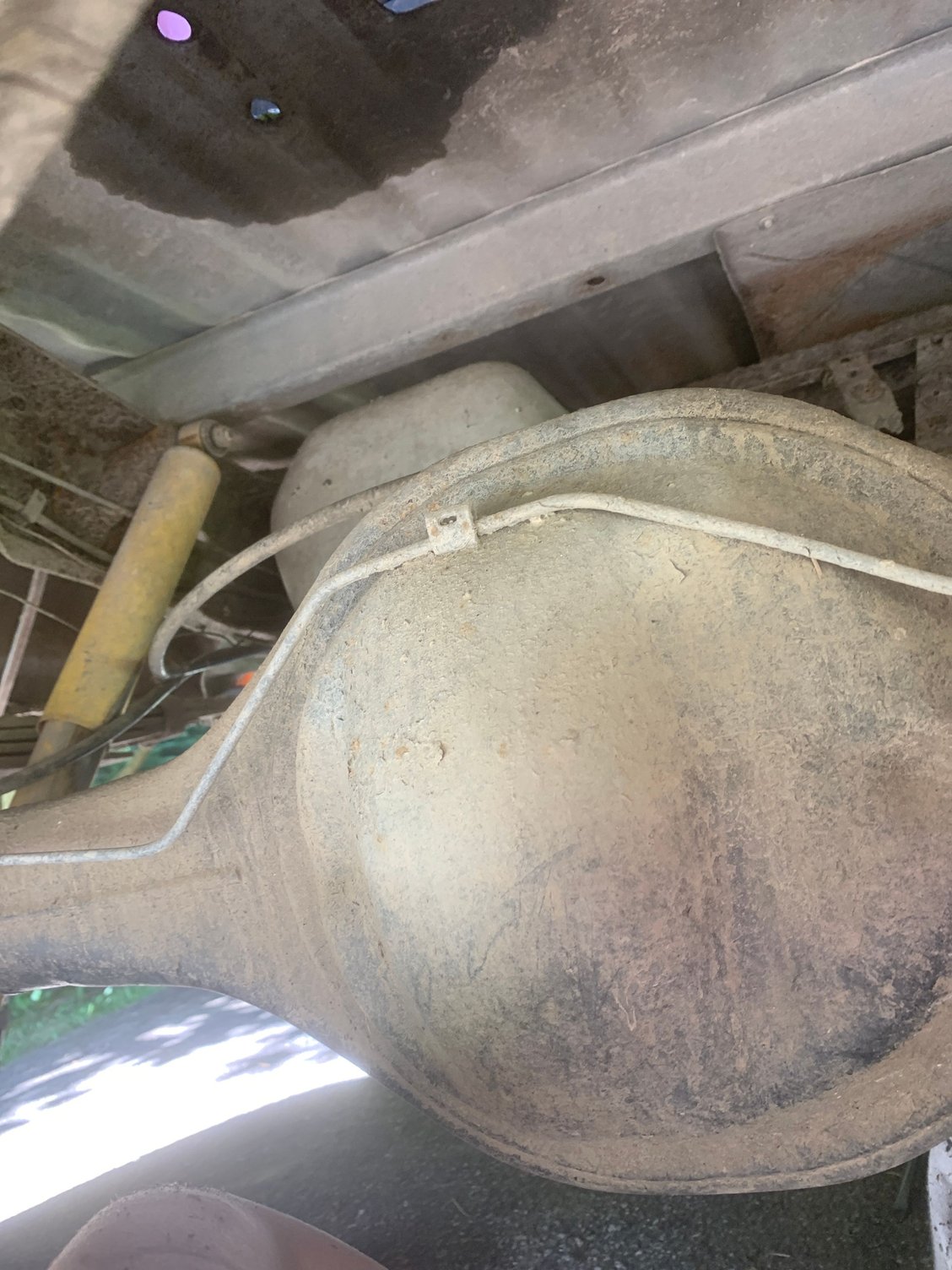

Ford 9 inch.
There was a tag on one of the studs on the driver side. ("about 5 o'clock" they say)
There should also be an axle code on the sticker on your drive door jamb which also shows your GVWR, GAWR, VIN etc.

That's a Ford 9 inch rear.

somebody painted over my tag and it can’t be found.

What engine and trans combo to you have?
By 1985, most half tons (with a 9" diff) had either 3.00 or 3.55 gears. From 1983 on, most of them had the 8.8 diff with either 3.08 or 3.55 gears, but the 9" was still used in some applications.
Does this truck have a 302 with an NP435 4spd? For some reason they always had 9" rear ends, right up until 1986.

it’s got a 351w backed with a c6 auto.

Do you have stock size tires and a tach? if yes, what RPM's are you running at 60mph? I would assume it would have 3.00 gears, but maybe lower if the truck has a towing or plowing package, maybe.

You should be able to see the outline on the door jamb driver's side, unless they took it off. If you can find it, I would carefully scrape the paint off. Lots of info on there if you can reveal it.

Check this place, they may be able to get the info you need from their records. https://www.martiauto.com/index.cfm
