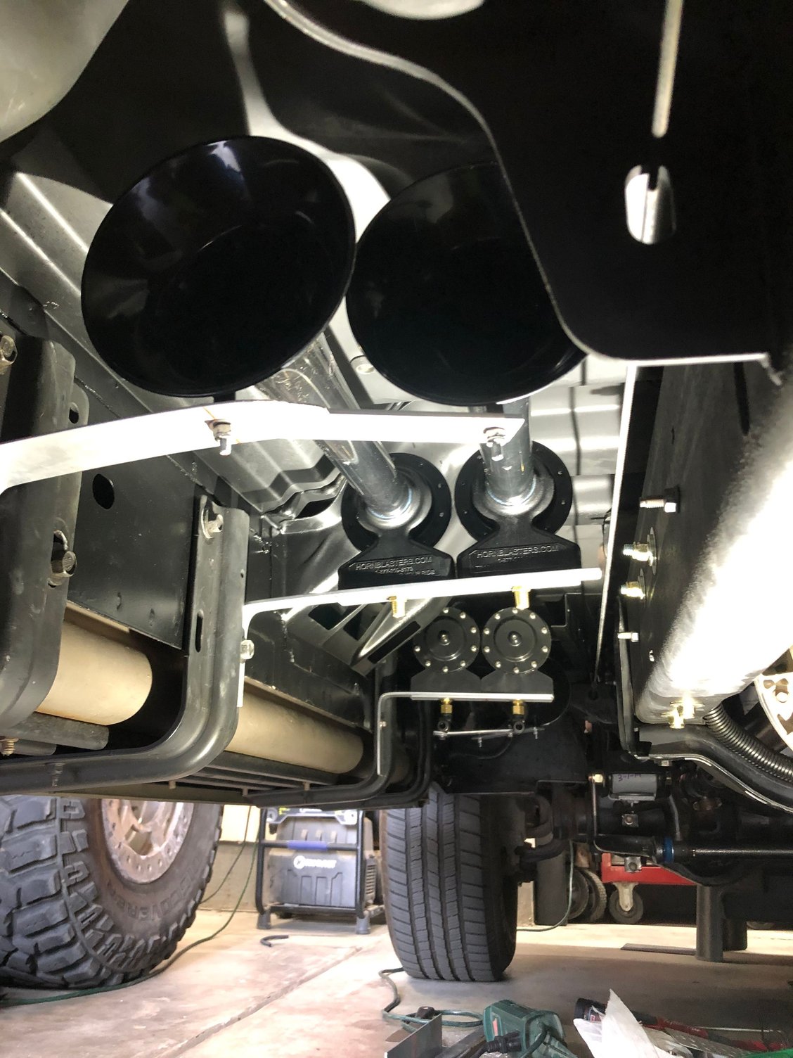

I just installed a viair 200psi kit on my truck. The wiring really isn't that bad. I rand the included, fused 8ga wire up front along the frame rail to the battery distribution block in front of the upfitter fuse / relay block. While I was running that, I ran 2 16ga wires with it, one to an upfitter to turn the compressor on and off, and one to my horn. The pressure valve that came with the kit has a built in relay for power, so the smaller wire is a trigger, if pressure drops and my upfitter is off, it won't kick on, if pressure drops and the upfitter is on, it kicks on. Either way, you'll probably be running a few more wires depending on what your doing. I tapped all the grounds into the frame rails locally.

2.5 gallon and I'm already looking for spots to stick more tanks.... It's too small
