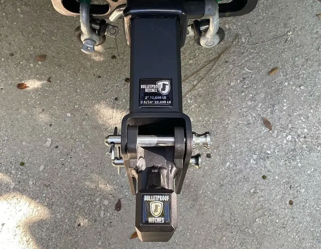

My 2021 F350 required a 6” drop according to the Bullet Proof recommendation based on measurements from the bottom of the receiver to the ground. That allowed 10” of clearance.

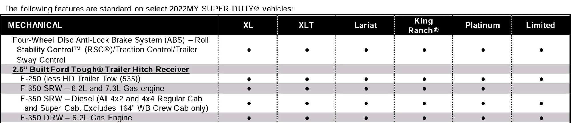

My F250 has a 2 and a half inch hitch. You might want to make sure yours will come with a 3 inch.

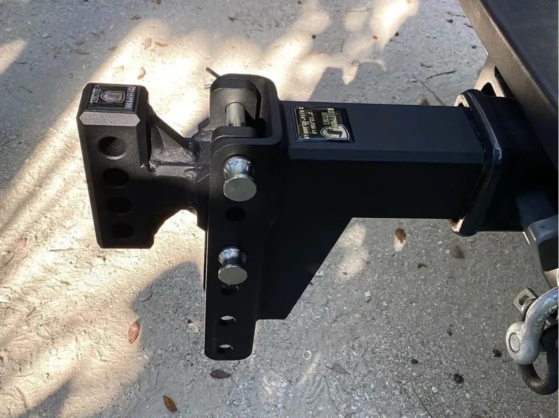

I'm still trying to determine what I'll need as well when ordering the Bullet Proof hitch. Some say the 8" drop, but it also depends on the height of the trailer you're hauling. I'm hoping the 6" will do because I want the tailgate to clear the hitch when the tailgate is dropped. Does the 6" allow the tailgate to drop if the hitch is in the up position?

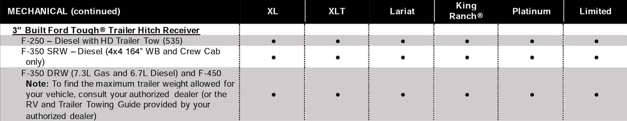

Also, to the OP, I discovered prior to ordering a 2022 F350 with the 7.3 gas engine that I had to go to a dually to get the 3" receiver. The tongue weight on the trailer I have on order is 2000 lbs, and only the 3" receiver is rated for 2000 lb's of tongue weight. Just an FYI.

Ordered the 250 with the high capacity towing package. So it getsthe 350 rear axle overload leaf springs and 3in hitch

what I have read it should come with the 2 1/2 reducer. The 2 1/2 would come with the 2in reducer.. brother in laws 350 dully came with both reducers think his is a 2017 or 18

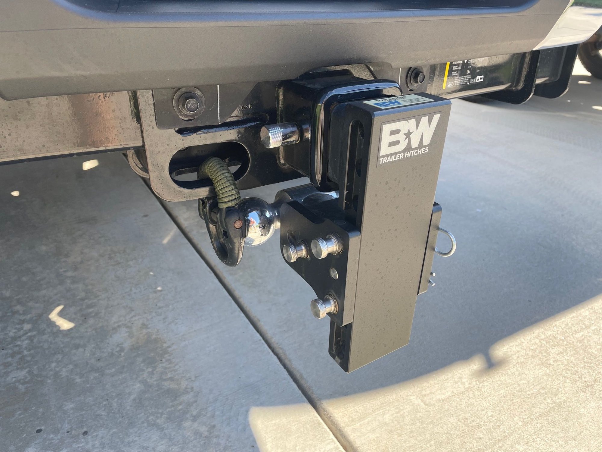

Here is the BW with a 3" shank, 7"drop/7.5" rise, and the 2"/2 - 5/16 ball size. Gives you an idea on how it will sit on the truck.
