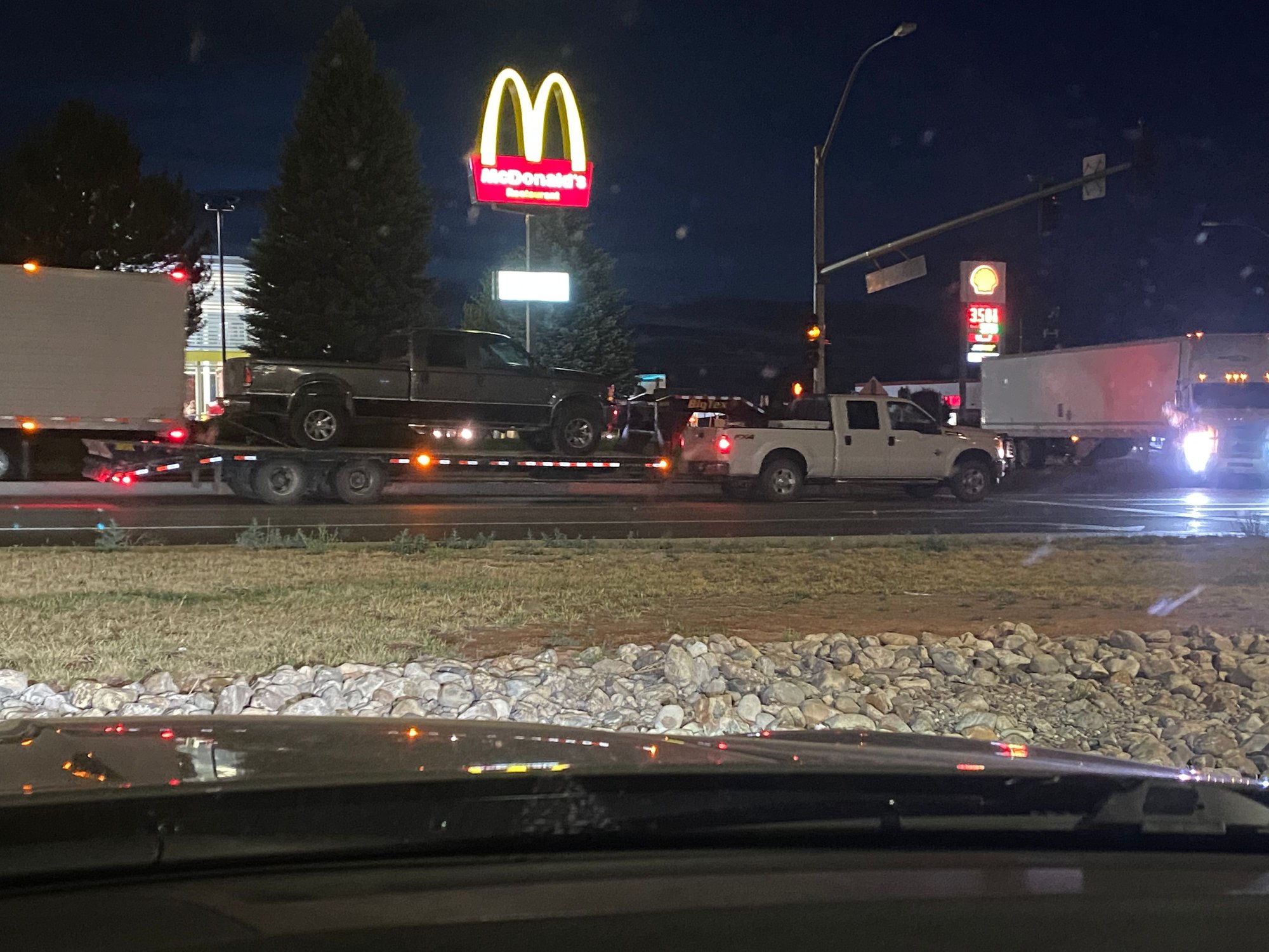

The second of my two events including the fact that my son didn't realize what he had done until after he was sitting in the parking lot over a mile away -- the tank had been nearly empty, and he put in over 10 gallons of gas for a partial fill up, and then drove it away until the gas got into the engine, it sputtered, and then just shut down. Had it towed home and went through a thorough cleaning and purging effort before cranking it back up again. Fogged the entire neighborhood like a mosquito fogger for over 10 minutes, but it actually ran better afterwards than it had before the incident. No apparent damage whatsoever... just the pre=pump filter element and engine valley filter was replaced -- nothing else.

yes indeed we have all been there, let my oldest borrows my truck to help move his then girlfriend
he calls me and say something is wrong with the truck, spitting , sputtering, blowing smoke!
I go to check it out and find the receipt laying in the driver seat just put 30 gallons of gas in and drove it till it died!
it would start back up but ran terrible, i figured he trash the injectors because he drove it till it just would go no more!
made him buy me remanned injectors , purged the system ran fine, injectors where crap remans truck never ran the same again never let my knuckle head kid borrow my truck again!

The truck towing mine home had 25 gallons put in it by the ranch owners kids and driven 15 miles before it died. It was new enough it went to the dealership for the fuel purging. No parts were changed and it runs fine with over 200K since that incident.
The more I read about this happening, the less worried I am about lasting damage. I'll keep the mixed fuel and add a gallon to the tank on the old tractor every now and then so it's not $120 of wasted fuel.
Thanks for all the feedback. I'll report back in a few days when it's back on the road... again....
