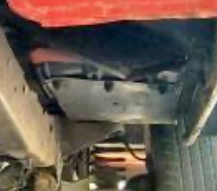

Looks decent on the exterior sheet metal, but some questionable stuff underneath. In the one pic you can see they just hacked off the outer (typically rusty) end of the passenger side cab support.
Then you can see they bolted on either steel or rubber from midpoint passenger floor forward to either fix a rusty cab mount or (if it’s just a piece of rubber) to create a makeshift inner fender of sorts to protect the cab mount from crap coming off the wheel.
Would be interesting to crawl around under that one for sure! And to hear the salesman try to explain away what’s there!
