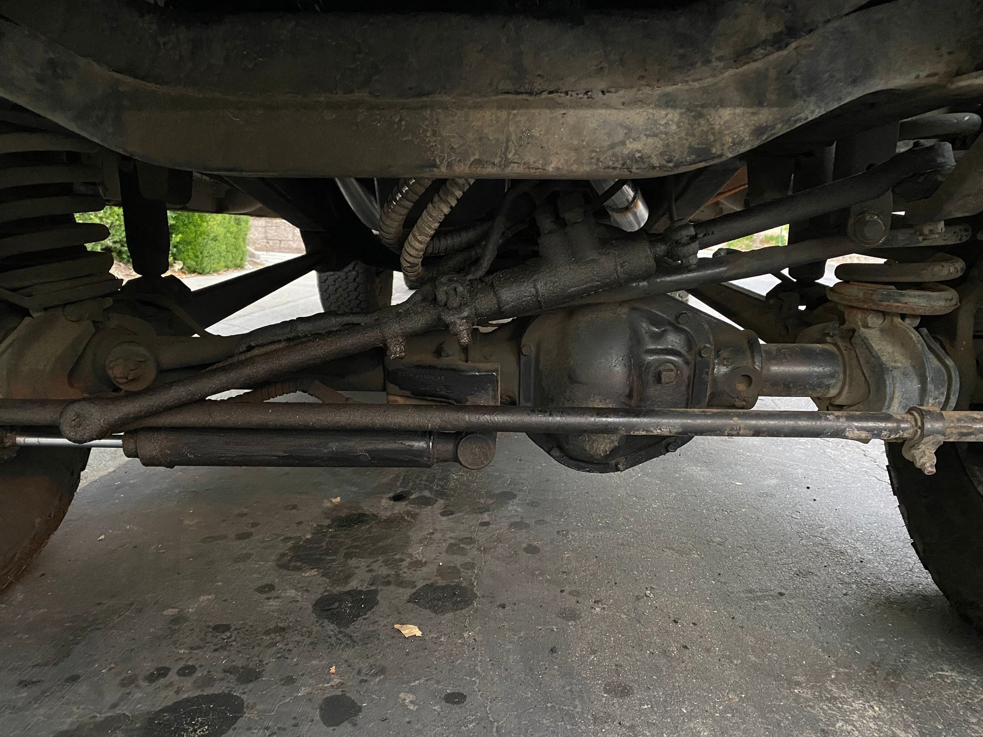

Hi all!
Trying to figure out what kind of an axle I have up front; truck is missing the front drive shaft after the PO replaced the TF with a "new" NP205 and rear axle with a Ford 9" with 3.73 gears...
I found some mentioning that Dana 44 axles (which is what I suspect I have) had the ID tag under the tag that retains the inspection cover... but I don't believe mine has one. Can someone show some reference pictures? If I am indeed missing the tag - how can I figure out what axle I have?
Pix of my axle:

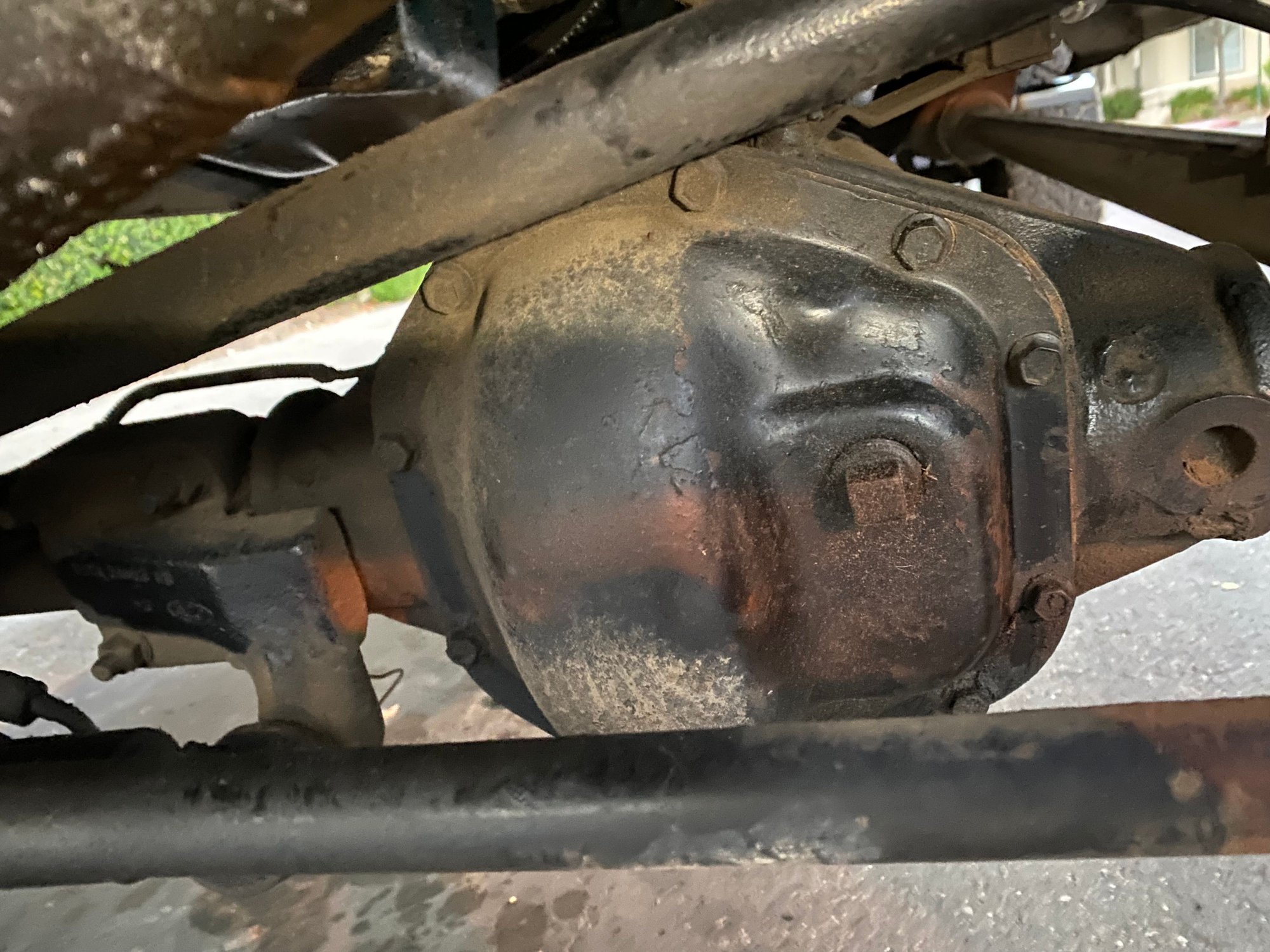

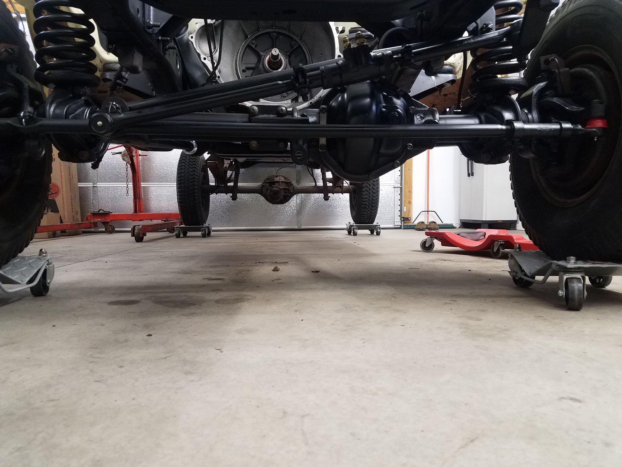

It's a Dana 44...
My 74 has a Ford 9" rear and a Dana 44 front as well.
Here's a pic of mine
Dana 44

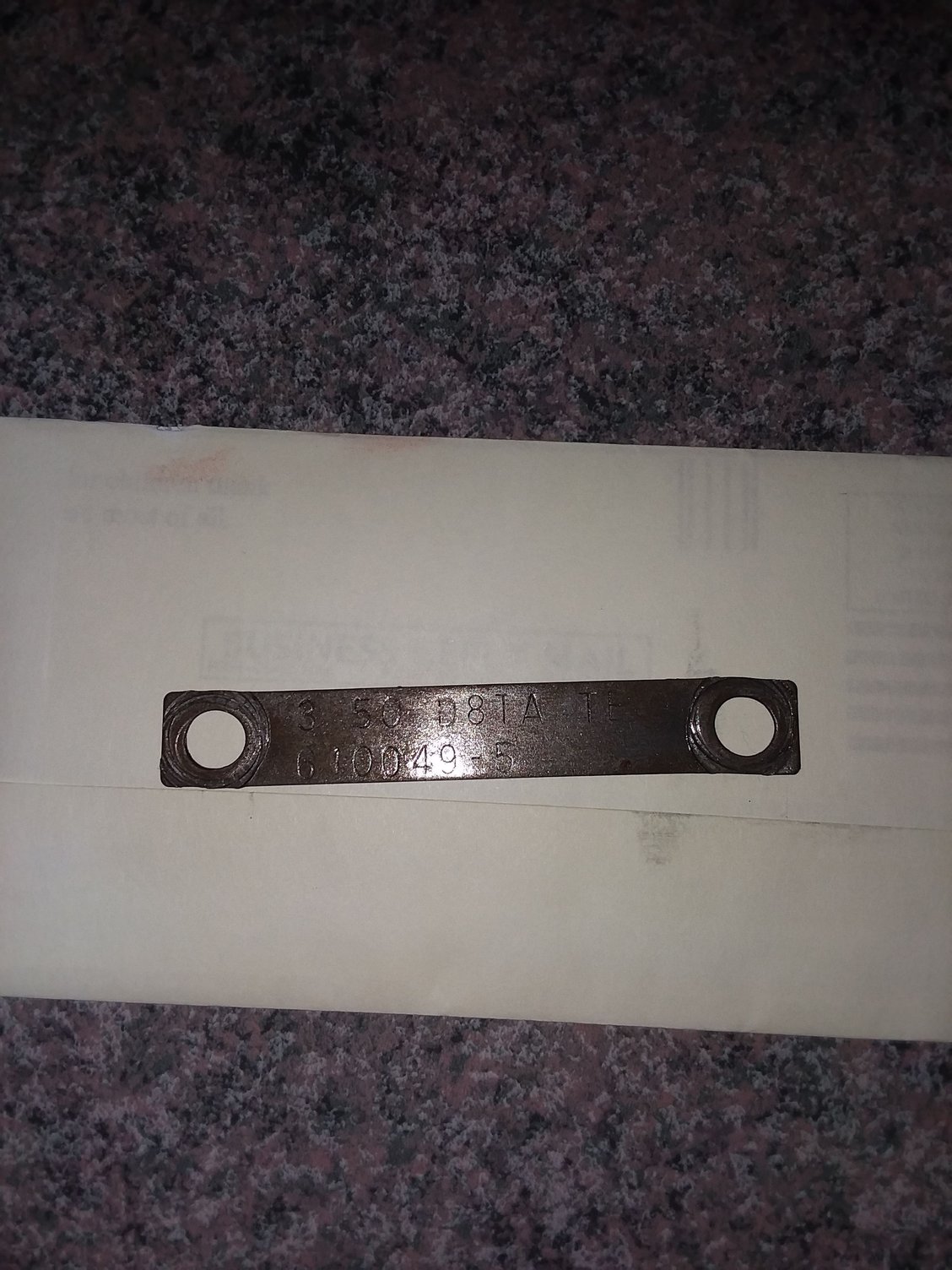

Our tag was to the left of the fill plug. It tore when we unbolted the cover and did not re-install it because it would have gotten worse when we torqued the bolts. Dig around in the glove box etc... and see if the PO stashed it somewhere.
My money is on it being a 3.50
Here is a pic of ours for reference.
This. Mine was in my glove box courtesy of the PO.
