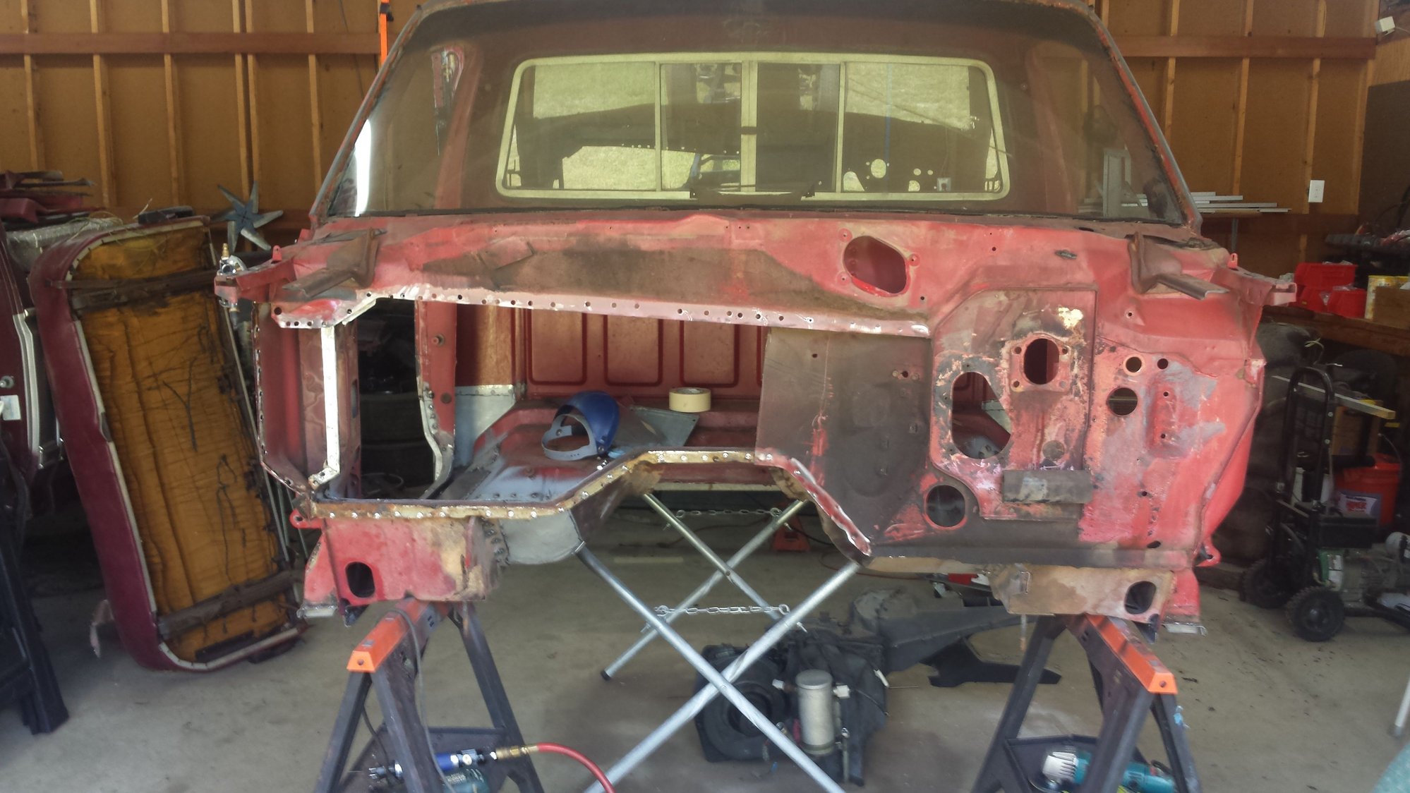

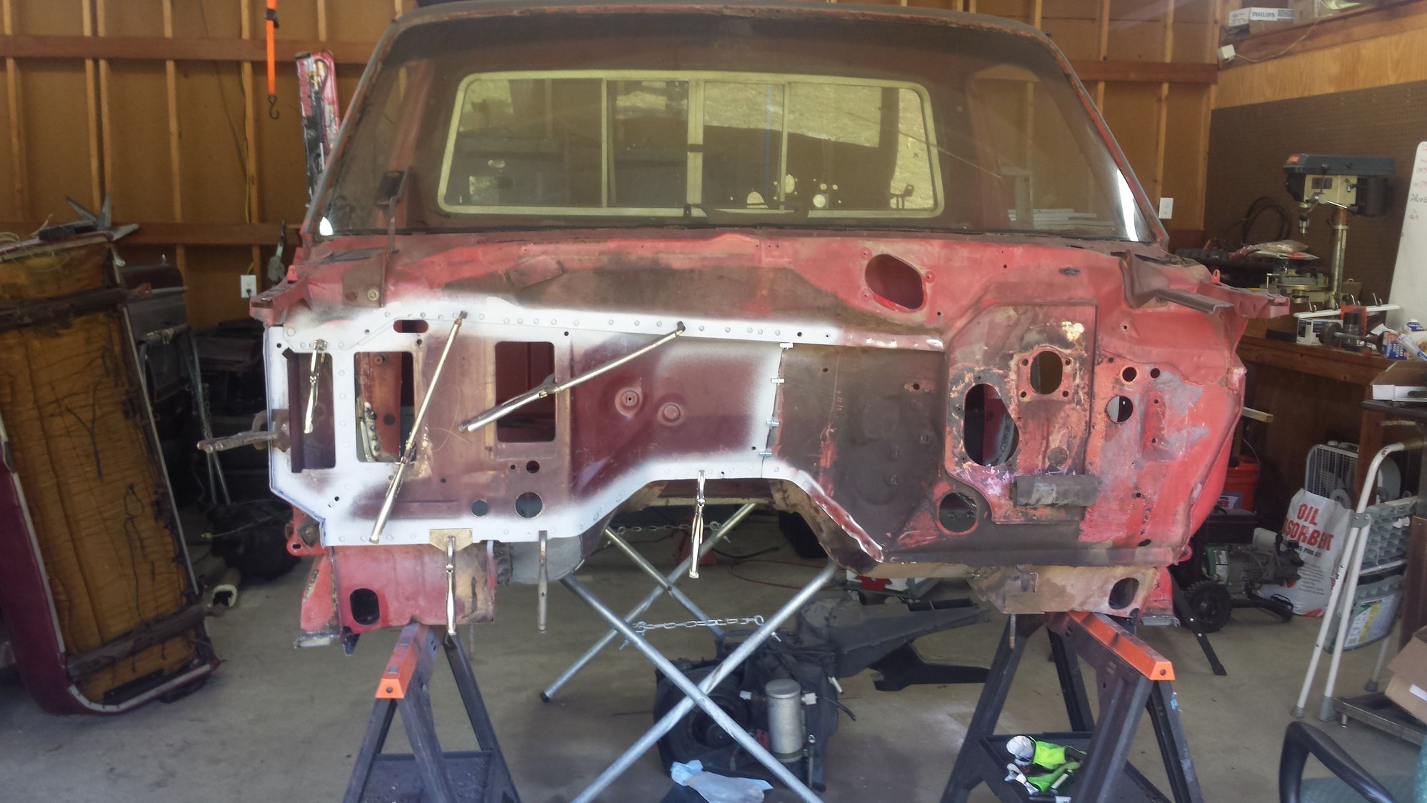

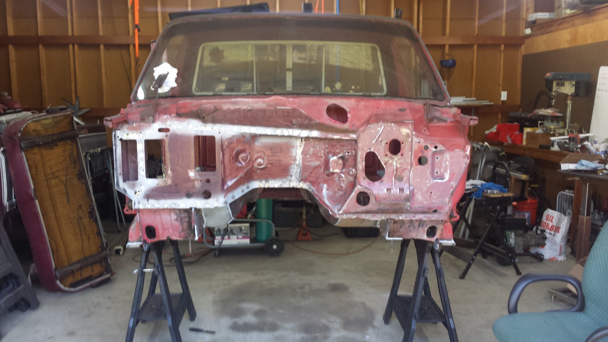

As said the firewalls are different and its not so easy to swap them with out having a truck with AC to get it from along with all the other needed parts.
Then you need all the tools needed to remove both firewalls and install the AC one back in.
2 hole non-AC firewall
3 hole AC firewall to be grafted in to the non-AC cab.
AC firewall placed over the non-AC firewall
non-AC firewall cut out
Starting to weld into place
Welded in place
Painted with masking still in place
HVAC box in place
If I was to do this again I would not swap the firewalls but make a pattern of the 3 hole AC wall and transfer it and cut the 3rd hole and some smaller holes as needed.

If you can find everything in the junk yard like I said just make a pattern of the 3 hole firewall and transfer it to your truck.
You have the 1 large hole to cut out that you can see here.
At the top a oblong hole just above the large hole and part of the oblong is over a round hole.
Then 3 holes at the bottom below the large hole.
1 is already there (the largest) 1 right below the large opening - think for the HVAC box bolt?
And 1 just left of the 1 already there.
On the inside there maybe a HVAC box bolt hole from the non-AC box but thing it may get covered with the AC box?
