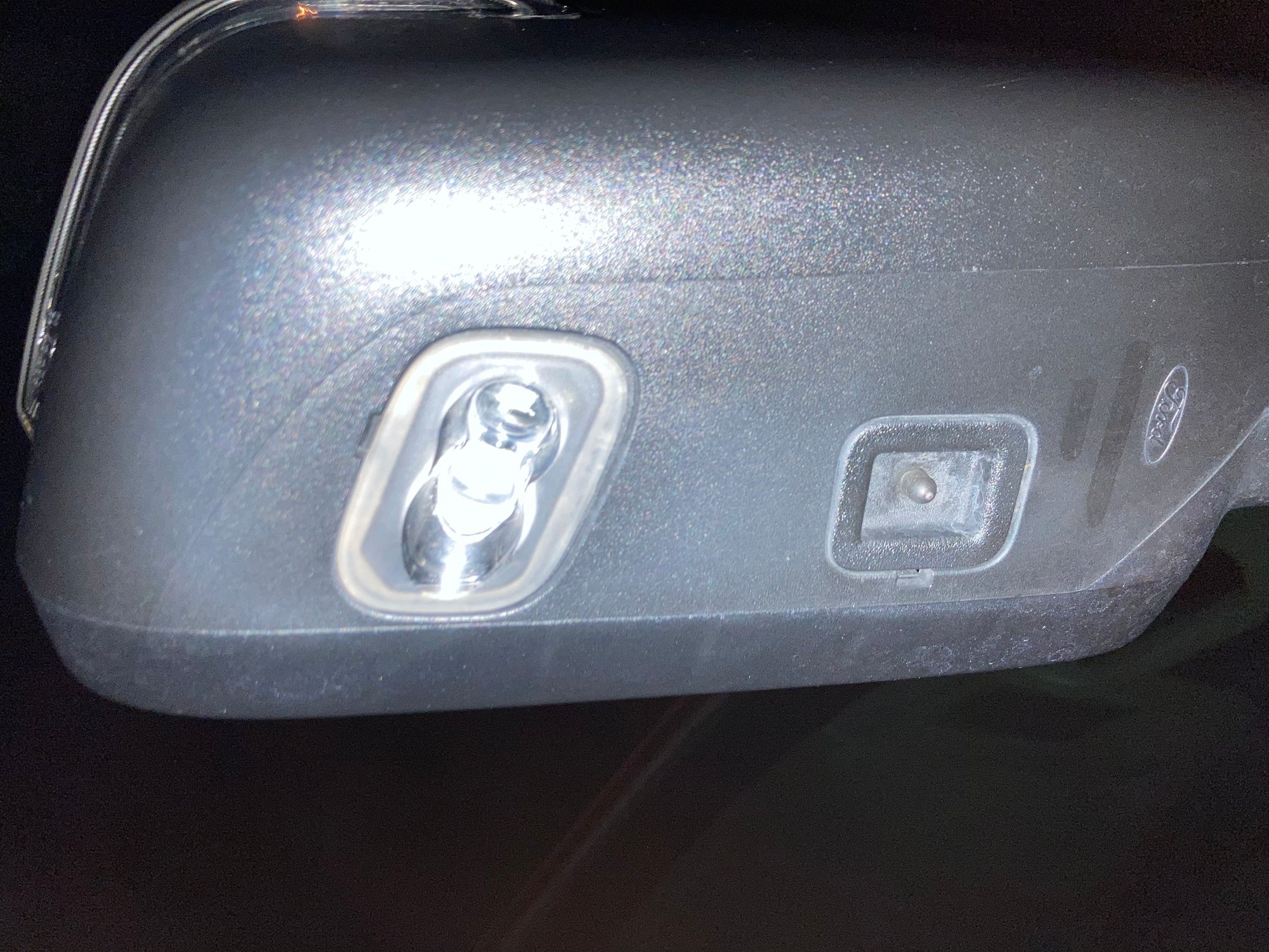

Hey all...had to replace my tow mirror turn lights because I cracked one. But I found something weird when I did so.
My passenger side tow mirror is wired for a puddle light, but the driver's side mirror is not. (Not included in my package)
Anyone else have this? Why would they wire one side and not the other?
Does this mean I could potentially wire my driver's side with puddle lights? Does having the puddle lights mean that mirror is wired also for auto folding mirrors?

I believe the outside air temperature sensor is located in the passenger mirror. Could that be it?

It was relocated to the mirror at some point maybe with the body style change in 17? Here’s the bottom of my passenger mirror with puddle lamp and temp sensor.

Ok...that's it. The only reason I thought it was wired for the puddle light is I had to replace the mirror turn lights and the directions show removing the puddle light in this spot to get the shell off.
Thank you.
