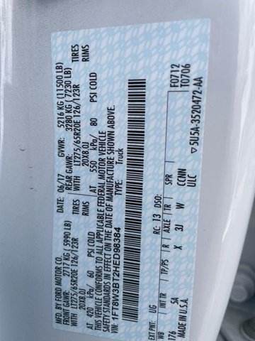

Can anyone tell me the towing capacity of this: 1FT8W3BT2HED98384
2017 F350 Diesel CC 8' bed lariat with 3.55 and 11500# package?
I'm going to be towing a 5th wheel with a max capacity of 13900.

What does the yellow payload sticker say on the door?

It's 15,700lbs max in that configuration. Make sure you have enough payload as a near 14k trailer is pushing it for pin weight.

You won't have any issues towing that trailer with your truck.
You won't get close to the 7200 pound rear axle weight rating, not unless you have a bed full of sand bags while towing.

That shows 12K trailer WITH THE 10K GVWR package, not what the truck you are looking at has. You have to look at the notes that go along with those ratings on that chart.
I'm telling you, that 11.5K GVWR truck is more than enough to handle that 13,900 trailer you are looking at.
