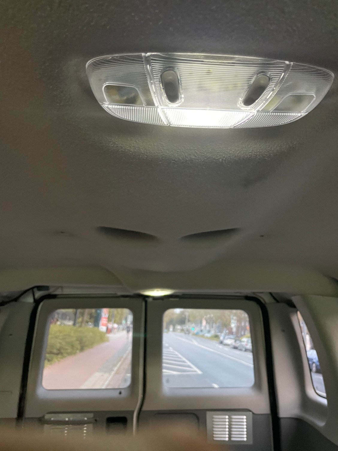

Got a used headliner and brand new dome lights. Any clues if I‘m missing a clip so the lights stay „up“?

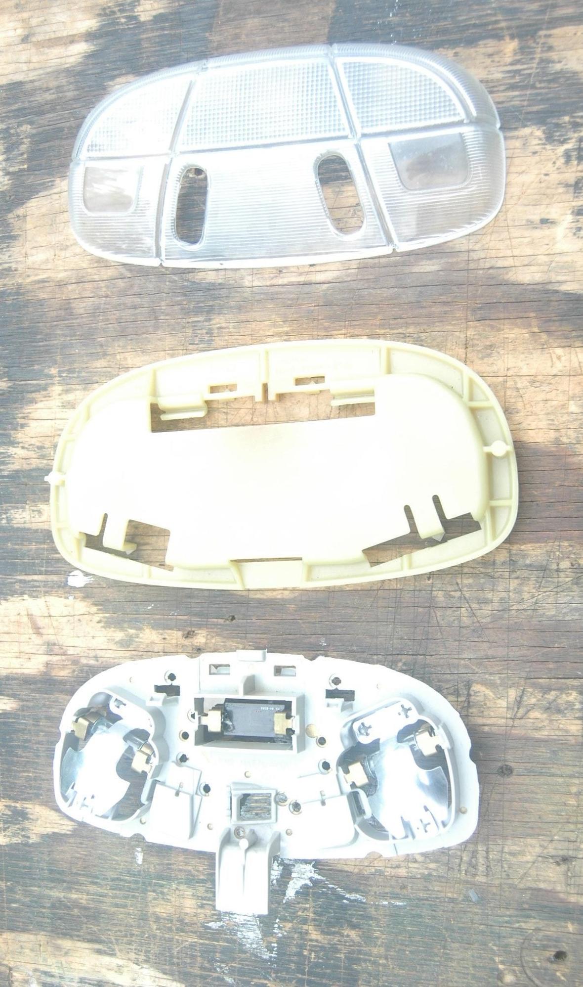

There is a missing part, a plastic trim ring that is installed through the headliner from the side opposite the interior.
See if this photo helps describe this:
You need the part showing in the center of those three parts.
Here's a link to some photos of a headliner similar to yours---this one was cut into smaller pieces just after these were taken, couldn't give it away. Dome Lights Install

Found the old clips and it worked like a charm 😅
thanks JWA
