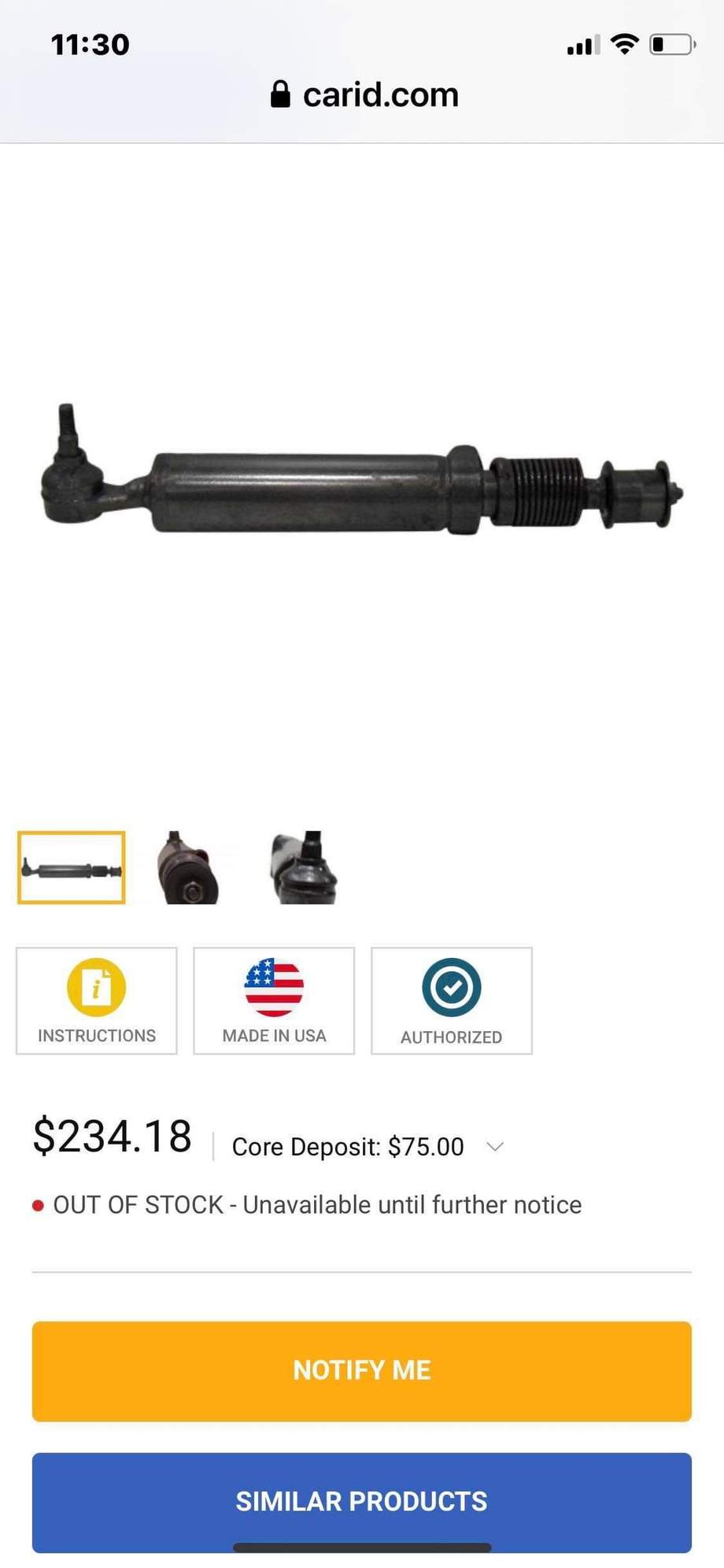

I have brought a wonderful E200 1974 Ford Econoline.
We are restoring it from top to bottom!! It's a project my partner and I are extremely excited about! We are currently working on the Power steering cylinder and was hoping to clean it up and replace the seals and so on but after cleaning it up we have discovered the bar is bent on the actual cylinder (Part number LARES 10077) I have been searching high and low literally worldwide and cant seem to find one can anyone help or direct me in the right direction? All help greatly received

Perhaps the rod can be straightened? Most machine shops do this type of work.

Jimbomitch is correct. If the rod comes out, they might also be able to make a new one. I am having a new spindle made for my right front steering knuckle and the shop quoted $80 to $100. That is close to what some salvage yards wanted for a used one. Check with more then one shop as prices vary as does experience..

I would take a close look at using a power assist cylinder off of a mustang or early Corvette or whatever used them back in the day. My '56 chevy had power assist from the factory, so look into classic chevy PS stuff.

So we managed to straighten the bar and completely refurbish the whole unit
