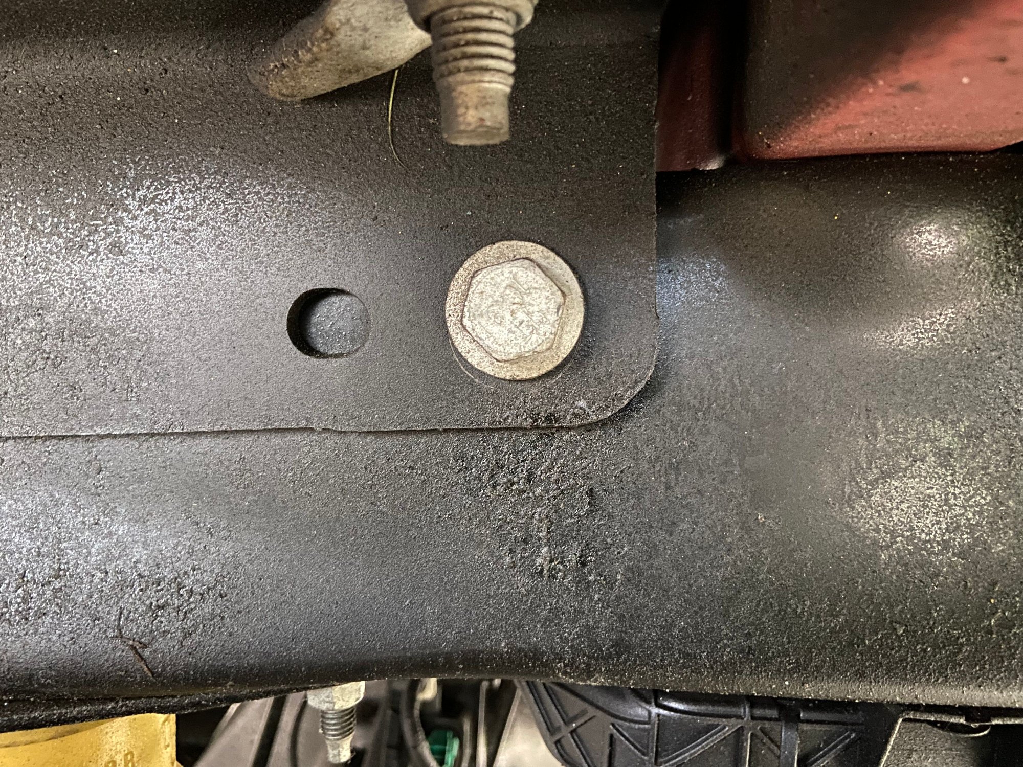

F350 2021 SB ordered w/5th wheel prep. Witness mark on bolt head. Never towed with it.
i am curious as the the HOLE diameter versus the bolt and how much tolerance is indicated?
the hole just to the left looks to be NOT ROUND, but that could be the picture angle
if its NOT round, then maybe engineering did this to allow slight movement when frame twists or loads are applied. still is puzzling about the movement from a non towing event, as in how much do these boxed frames flex or twist on a regular day of non towing
