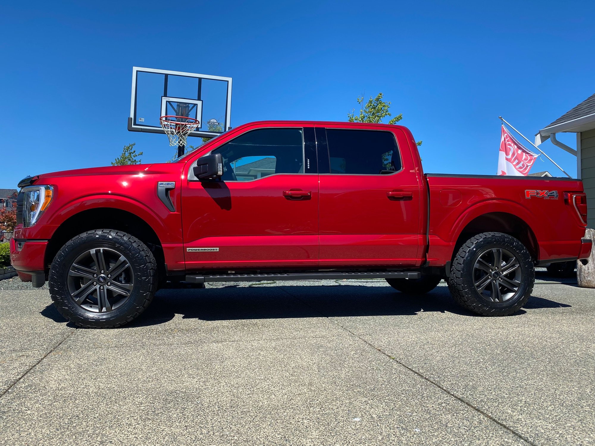

Went with the 2” Pro PacBrake leveling kit. Rides like stock with the 34’s for an efficient spacer leveling kit
