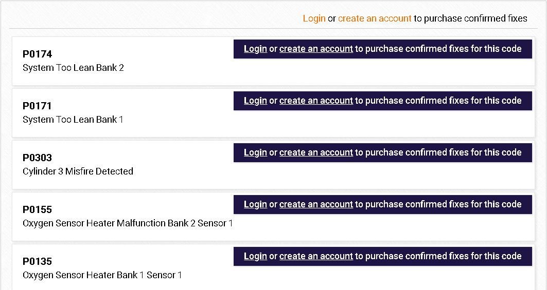

Here's a screen shot of your listed DTC's and a description of their meanings:
That image ^^^ was created using the Actron DTC lookup feature found here: https://actron.com/code-lookup
On the surface the codes aren't horrendously terrible, could be an easy and not too expensive fix. When/if these issues are resolved I'd run a fuel trim scan while driving your truck just to see how they're performing.
