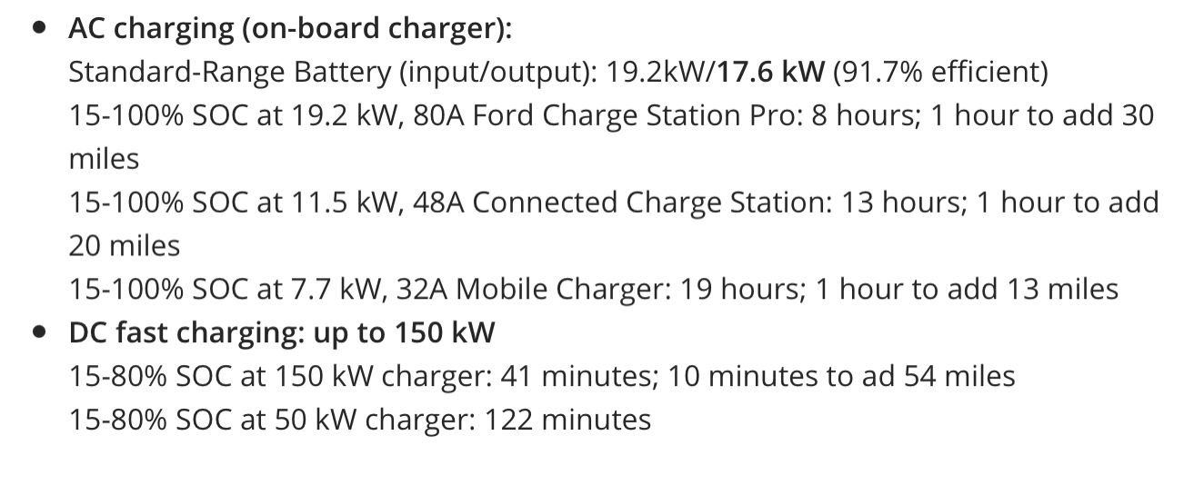

True, but that's impractical in a lot of ways. It takes 7 hours to charge my car at 240v/32A, which is just north of 7 kW. The F150 battery is likely to be at least three times that size.

I'm more salty by the fact that it takes 19 hours in 240v to charge the damn battery. I can understand that time on a 120v but on 240v? Something does not seem to be optimized or they misspoke. I really hope it's the latter and not the former.

Unfortunately it’s about basic math and circuit capacity rather than optimization. These batteries are HUGE. My car charges in 7 hours at 32a, which fills up my little 50 KWh battery. But the extended range battery in the F150 is nearly three times as large. That’s like comparing the time to fill up the 44-gallon fuel tank in my old Excursion compared to the 15-gallon tank in mu Escape. It’s not that the Excursion doesn’t have an optimized filler neck; the pump can only deliver gas at a certain rate.
That’s why the extended range model can support charging as much as 80A, but that only works with the most powerful charging station attached to a circuit capable of that kind of current. The 6-gauge wire I installed for my charging circuit is only capable of 50A, and I’d have to upgrade my household service to push the full 80A. These batteries are several orders of magnitude larger than anything else most of us have ever used.

I thought the Cybertruck had less charge time. Nope, 21 hours and 30 minutes for full charge. So I guess an hour and a half difference could be a benefit in favor of the F150.
For a 200 amp breaker panel, your incoming wire needs to be 3/0. Not sure how much Xcel Energy (assuming that's who you have) would charge you for the upgraded wiring, a panel upgrade would be around $3500 or so.
