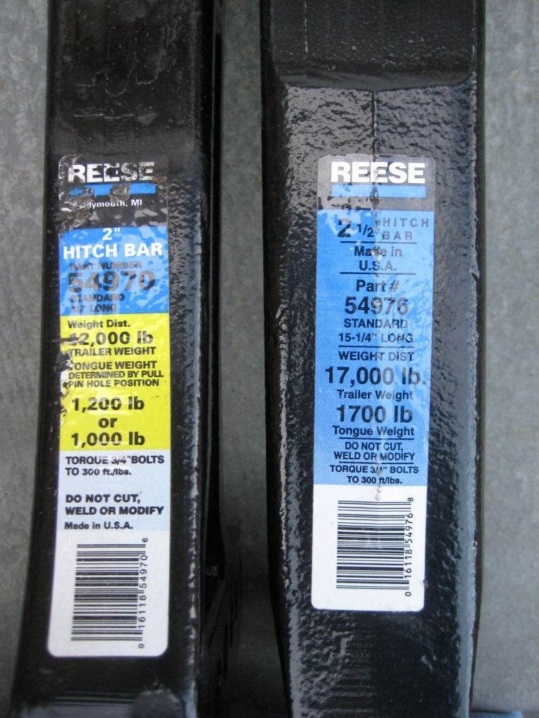

Originally Posted by Daddy454
I looked on their site,but I couldn't find just a 2.5" shank that is compatible with a WDH?
@Daddy454
2" vs 2.5" shank
Size comparison
Side View:
Top View:
For the Label View shot below, I inadvertently switched the side by side order around of the two shanks opposite of that of the Top View photo above...
Label View:

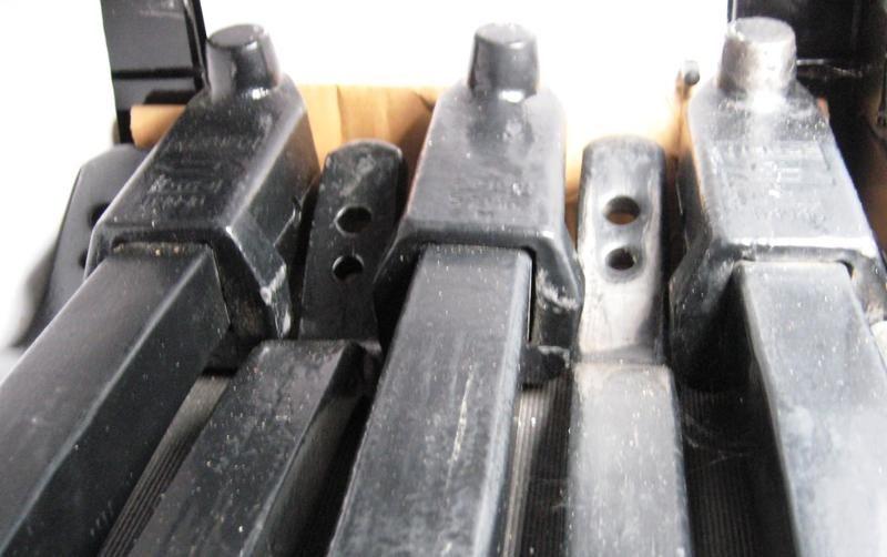

Spring Bars: (Trunion type)
1,200 lb. pair, 1,500 lb pair, 1,700 lb pair
Above 2" and 2.5" shanks and spring bars are used with the Reese Dual Cam WD & Anti Sway hitch system:
Comparing the first and second generation cam arms:

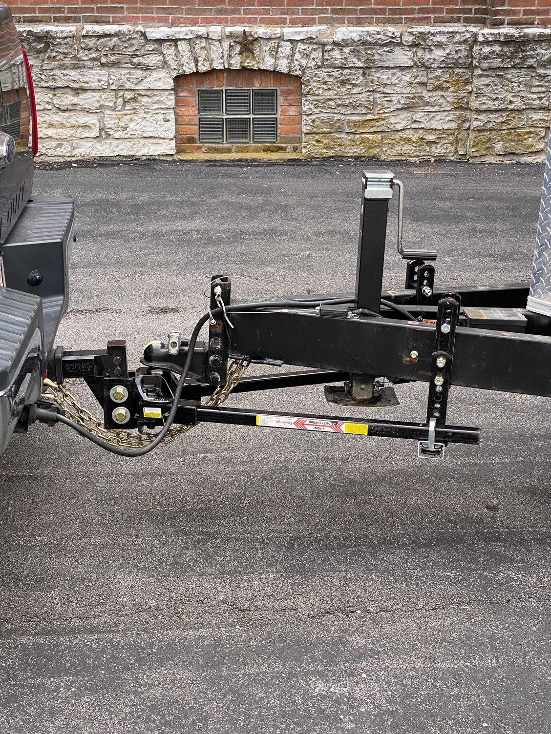

I loaded the trailer today for our trip out west. Here are the weights I ended up with for now. Still have to add probably another 500 pounds, mostly in front of trailer. So that will add to tongue weight and truck rear axle.
I am using an Equalizer 16k/1600 tongue WDH w/2-1/2” shank. My tires are rated 7,500# per axle.
10,080# Truck weight
11,500# Trailer weight
1,200# Tongue weight
4,740# Front axle
5,340# Rear axle
Went for short test drive and did not notice any loud noise from hitch. You can tell there is a load.
Tow vehicle is F-250 Lariat CCSB, 6.7 diesel w/3.55.
also, after measuring front end with WDH loaded the front of truck is only 3/4” higher than when unloaded.
