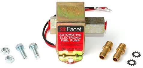

I personally would opt for the elec pump. The best recommendation for an Elec pump for this (and for all stock and lightly modified applications) Is the Facet pt# 40106 Kit pt # FEP12SV
These are OEM quality (and are used by many OEM in other applications) and will last decades Unlike some of the other Elec pumps out there (cough cough Edelbrock) yes not the cheapest but one of if not the most reliable.
This pump will lift 36" move 35 GPH at a pressure of 4.5-7psi (perfect for most North American origin carbs including the 2150). See below.
Mount the pump to the frame of the truck near the engine (to minimize wire runs) and rubber hose from the pump to the carb. Be sure to jacket the hose anywhere it could rub or chafe.
This will do two things keep the fuel cooler (you are not driving it through a metal fuel pump bolted to the engine) and it will replace any fuel that has evaporated off in the carb as soon as you turn the key to on/run.
This will solve your hard start issues and like most if not all vapour lock issues.

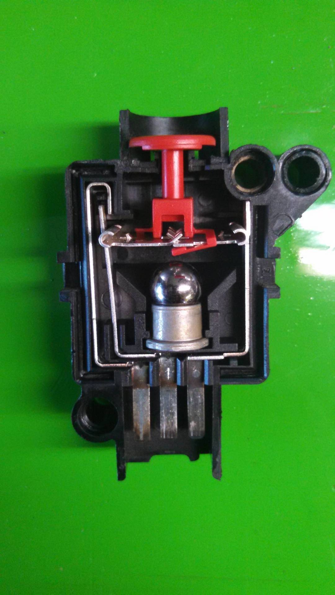

Ideally, you should add an inertia cut-out switch inline (between the power source and pump). These are mounted button facing down. This will ensure the pump is shut off in the event of a collision where the fuel system could be compromised. One can be scrounged from your local u pull it (be sure to take a few inches of wire and the connector) and it can be screwed to the inside of the driver fender near the ignition module.
Below is the Ford-style inertia switch is the simplest and really the most reliable of the inertia switches.
This can also double as a theft deterrent as a quick smack to the outside of the fender opposite where the switch is located will usually trip the inertia switch so no matter how hard someone tries to start your truck it once the float bowl is empty it won't run till that switch is reset.

Wow matthew we agree on something. I love those little pumps, I just put one on my diesel. It sits there and sounds like a little woodpecker under the hood. We had one on a old dump truck, and while everything else broke, that little pump kept pumping.

Yup those cube pumps are dead nuts reliable and will last just about forever. Ya they are not cheap but will outlast some of the cheap ones 100 times over. And unlike the centrifugal or postive displacement pumps, there really are no parts to wear out. as all that is in them is a foot valve and plunger valve a coil and a circuit board. Any time someone talks about going electric fuel pump this what I recommond.
For whatever reason though the 24V ones tend not to last as long as the 12V ones. I think Facet did not build enough cushion space in the volt rating for the circuit board as many 24V systems can spike up to 28V or even 32V with some of the prestolite alternators

Will adding an inertia switch to a 1985 F150 302 EFI that’s having the same issues work on the EFI configuration? Yes, I have a ‘Y’ in the 8th position of the VIN.
