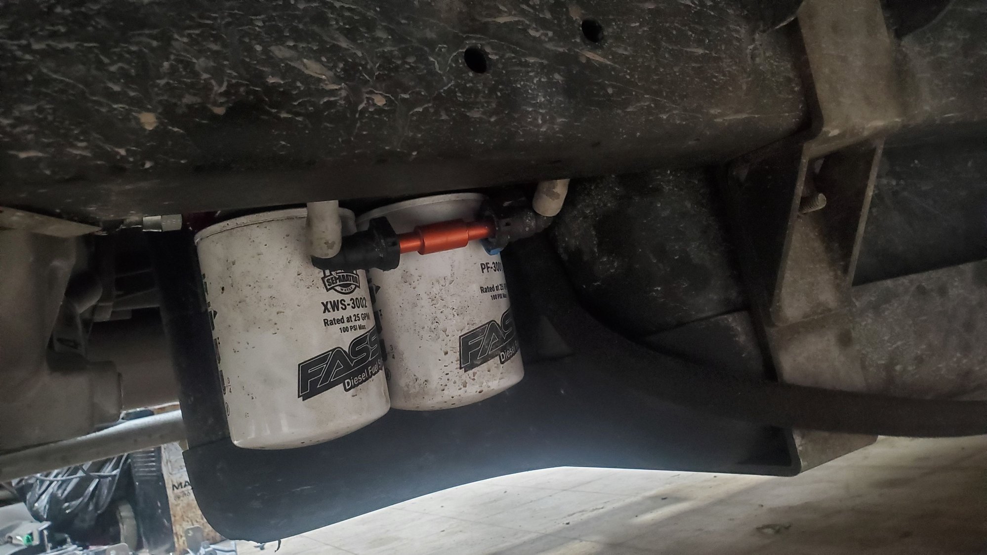

Just recently got done installing a 240gph on my 2015 and figured id share a couple notes
If you so choose to mount the pump between the tank and transfer case right where the factory one goes.
#1 You can cut the factory pigtail off for power supply and splice the fass pigtail onto that.
#2 You will need a custom bracket to be fabbed up for a good mount
I chose to run a bottom sump system, And the factory engine mount fuel filter can be deleted, The fass filter is a 2 micron while factory is a 5, Basically pull the whole thing, cut the yellow quick disconnect off and clamp it into the engine pressure side hose
Sidenote i will be installing some highf-low fittings and modifying the bottom sump because this 240gph is LOUD.
Also will be posting up pictures of the install and answering any questions

Fass install
Heres some install pics and i figured id throw in a picture of the truck i grabbed in Wyoming
