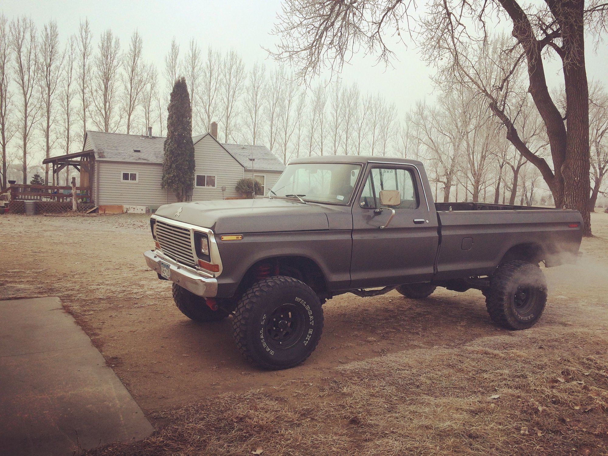

Everyone, I'm having a bit of a wrenching existential crisis (pun intended). I've had a '79 F-150 4x4 for about ten years now (see photo). It's got some basic bolt on upgrades, lift, gears, etc., nothing special. But the plan has always been to do a frame off and do everything - including putting in an e85 460, 35 spline 9-inch with discs, an overdrive, more lift, and so on. I'm now finally in a position where that is feasible to get started on "the build" I've been wanting to do for about a decade. I've also hemmed and hawed for many years over whether I should build an F-250 or stick with the current truck.
Just by chance I found a 79 F-250 4x4 listed for sale that is basically right down the road from me, is in good shape, and is cheap. And now I'm really debating picking it up. So I thought I'd ask for some opinions (always risky on the internet) on the relative merits of building a 150 vs 250 mild off roader with 35s and around 400hp. How much stronger/better would two Dana 60s be than the 44 and 9-inch in my 150? Are the dual piston F-250 front brakes that much better? Is lifting a 250 easier since you're not dealing with radius arms and trac bars? The axles are the main advantage I can see with going with an F-250. Is it worth it? Is there other stuff I'm not thinking of? Just need to talk it through. Thanks.

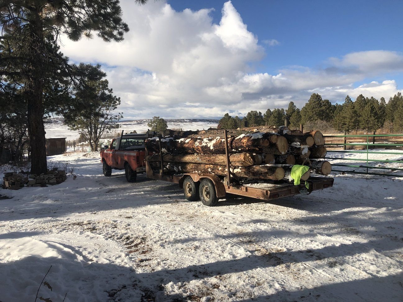

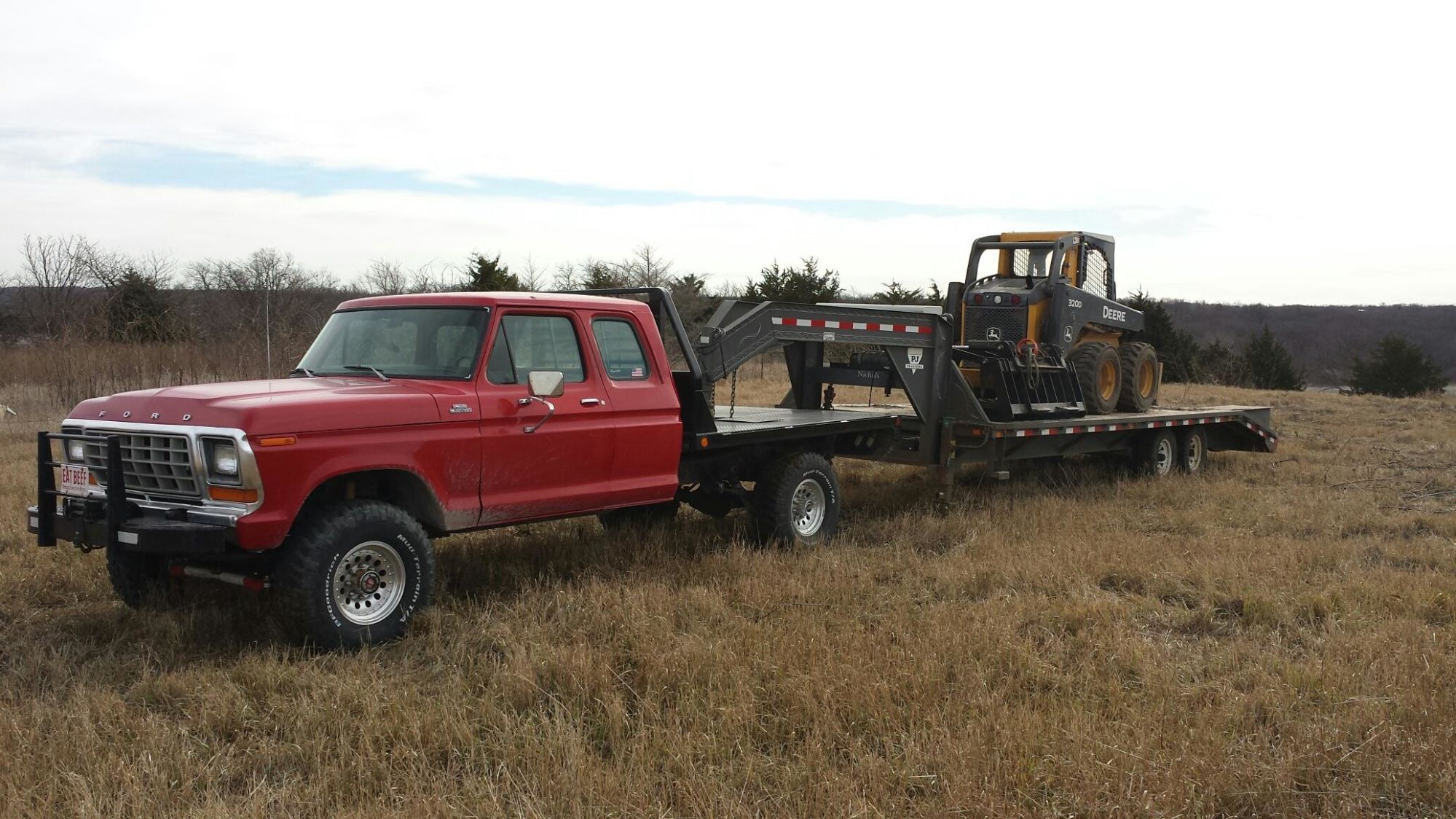

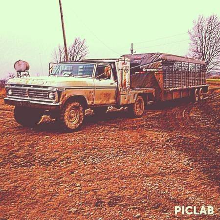

What do you do with your truck, get groceries...sorry I had to ask since Christmas said F100/F150's are just for that. Lol Meaning how hard to you work your truck now, tow anything often or all the time? Haul loads of firewood, gravel, tow a big steel trailer, with another rig on it or tow a big boat? Is your truck a hard used/worked DD? Then an upgrade to a F250 would be ok. If your truck does what it is asked to do now, then just stick with it.
You have a very nice truck NOW, I would put the time and money into IT. It looks like you have done a lot of both already. You mention (two Dana 60's)....now if that truck down the road HAS TWO dana 60's and it is cheap, go buy it for a financial nest egg. ONE front 79 Dana 60 axle is worth about 1000 to 1500 bucks. Maybe even more depending on where you are located in California.
A front axle Dana 44 can be upgraded for more durability and that 9" rear axle is pretty tough already. There are upgrades also available for it. As far as lift kits yes F150 big lift you need to address the front end suspension/trac bar set up and steering a little bit more. F250 big lift you still have some steering to address. Also remember F250 is 8 lug axle so any and all the 1/2 ton stuff (rims) you have will not fit.

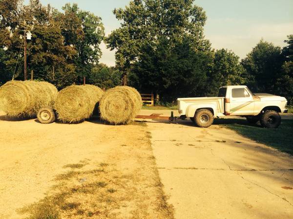

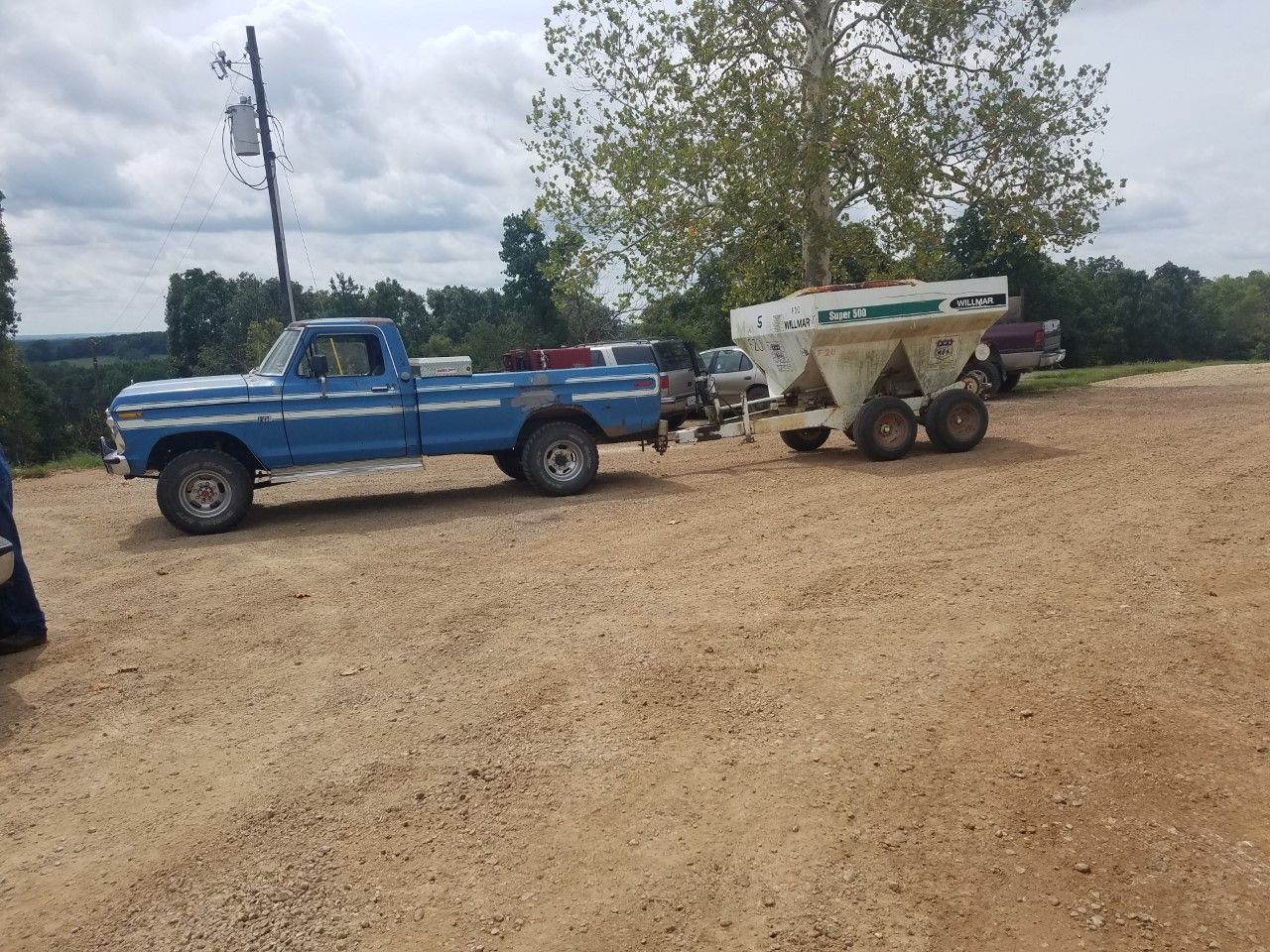

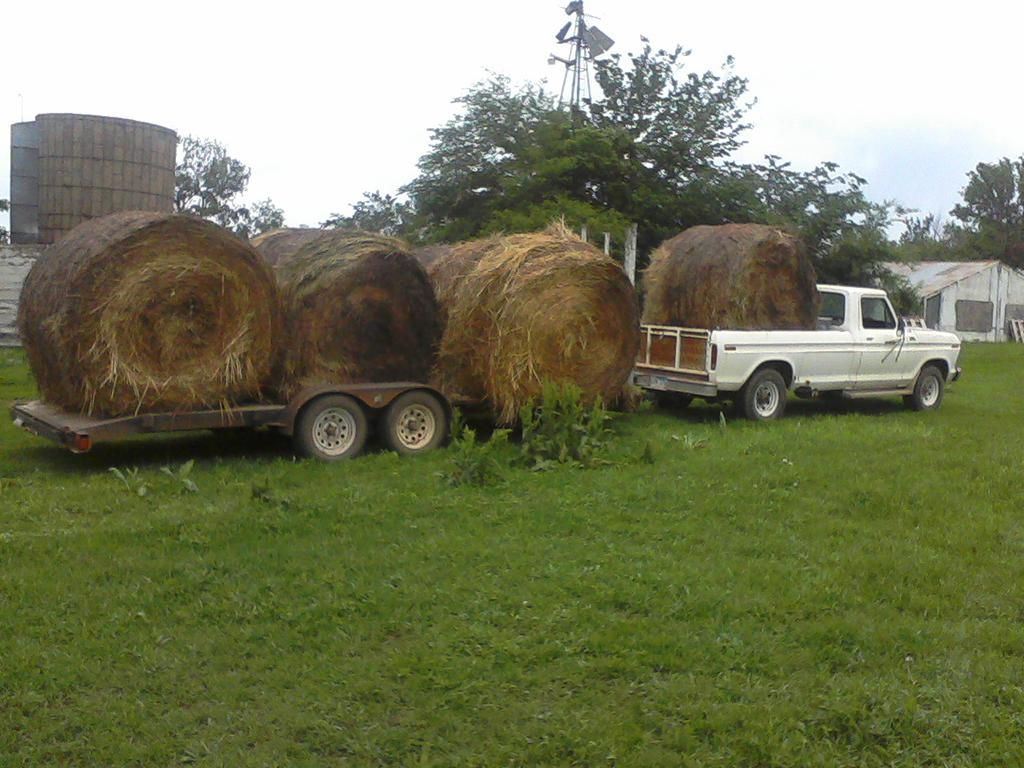

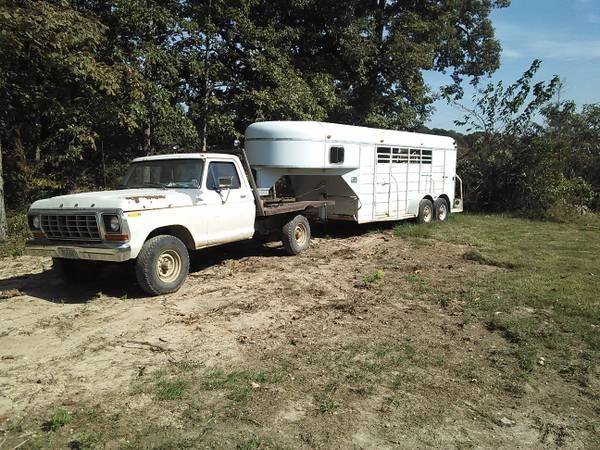

I am sure these guys get the job done with what they have. Can you spot the 1/2 ton in here?

Thanks for the replies everyone. I think there is a lot of wisdom in the "appreciate what you have" advice. I went and looked at it yesterday and it has had a hard life plowing snow. It would be a great project truck but...I already have a great project truck. I realized that starting over with this F-250 would set me back at least a year. My 150 is in a much better place as a starting point for a complete rebuild. Plus, I really just wanted the axles and buying the whole truck likely was not worth it. My 9-inch has served me well and I know it in and out.
