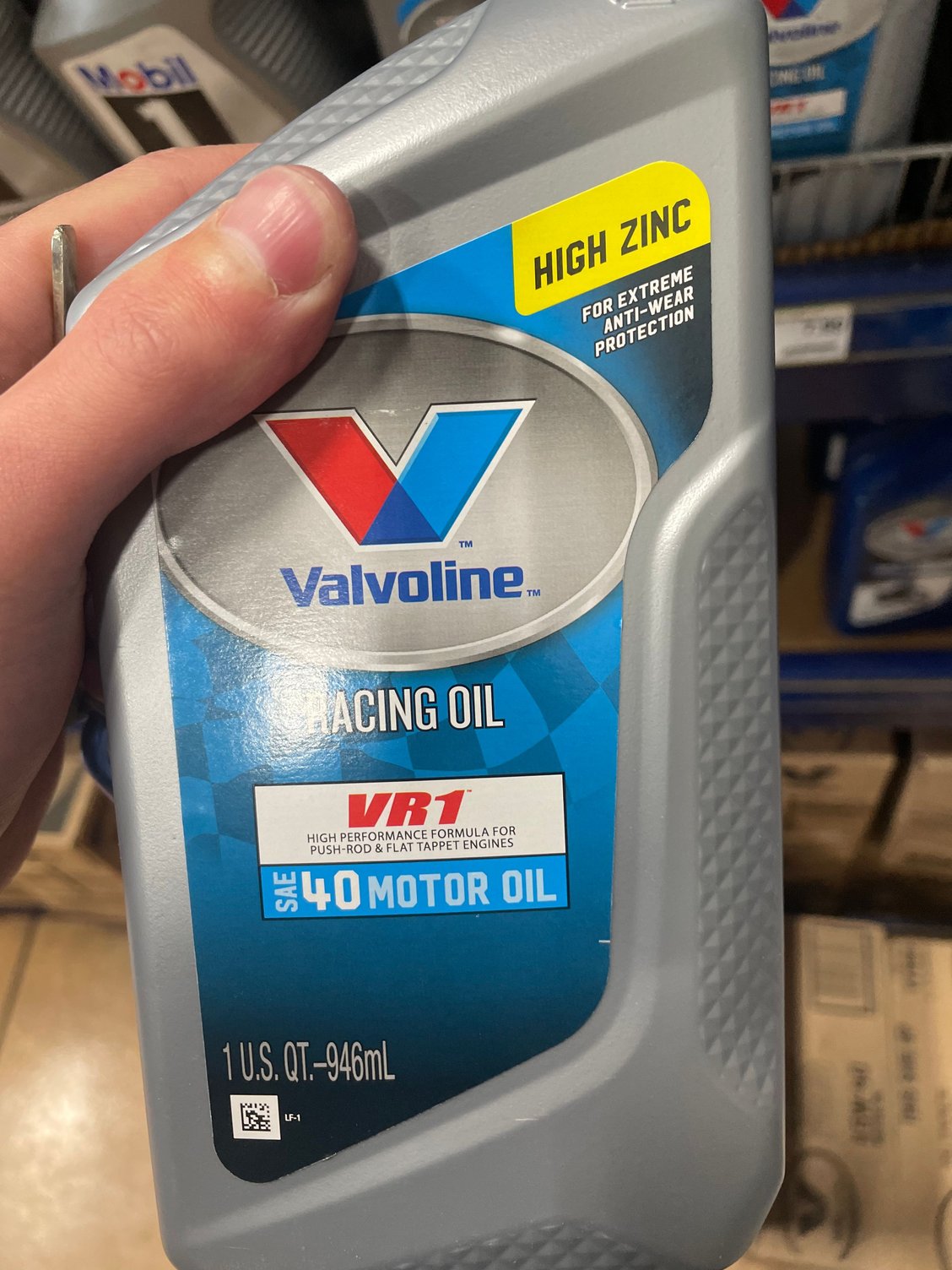

This is the stuff
Old May 19, 2021 | 07:23 PM

Racing oils do no have the additive package protection for street use DO NOT EVER use racing oils for street use.
Ideally, you want a good 5w-40 Synthetic for these older engines, strait weight oils went out with bias-ply tires there is NO advantage to running them and several disadvantages and is in part why they are no longer specified for ANY road-going engine.
Diesel oils typically have more than adequate ZDDP content to replace/replenish the tribolfilms on wear parts. A couple of good choices are Mobil 1 Turbo Diesel Truck and Rotella T6

VR1 is a racing oil in the sense that it has a high zinc content. it is perfectly fine for street driven engines without a cat convertor.
It's always best to take the manufacturers word rather than clowns on the internet. read the PI sheet. the more you know...
Valvoline™ VR1 Racing Motor Oil : Product Catalog - Valvoline
