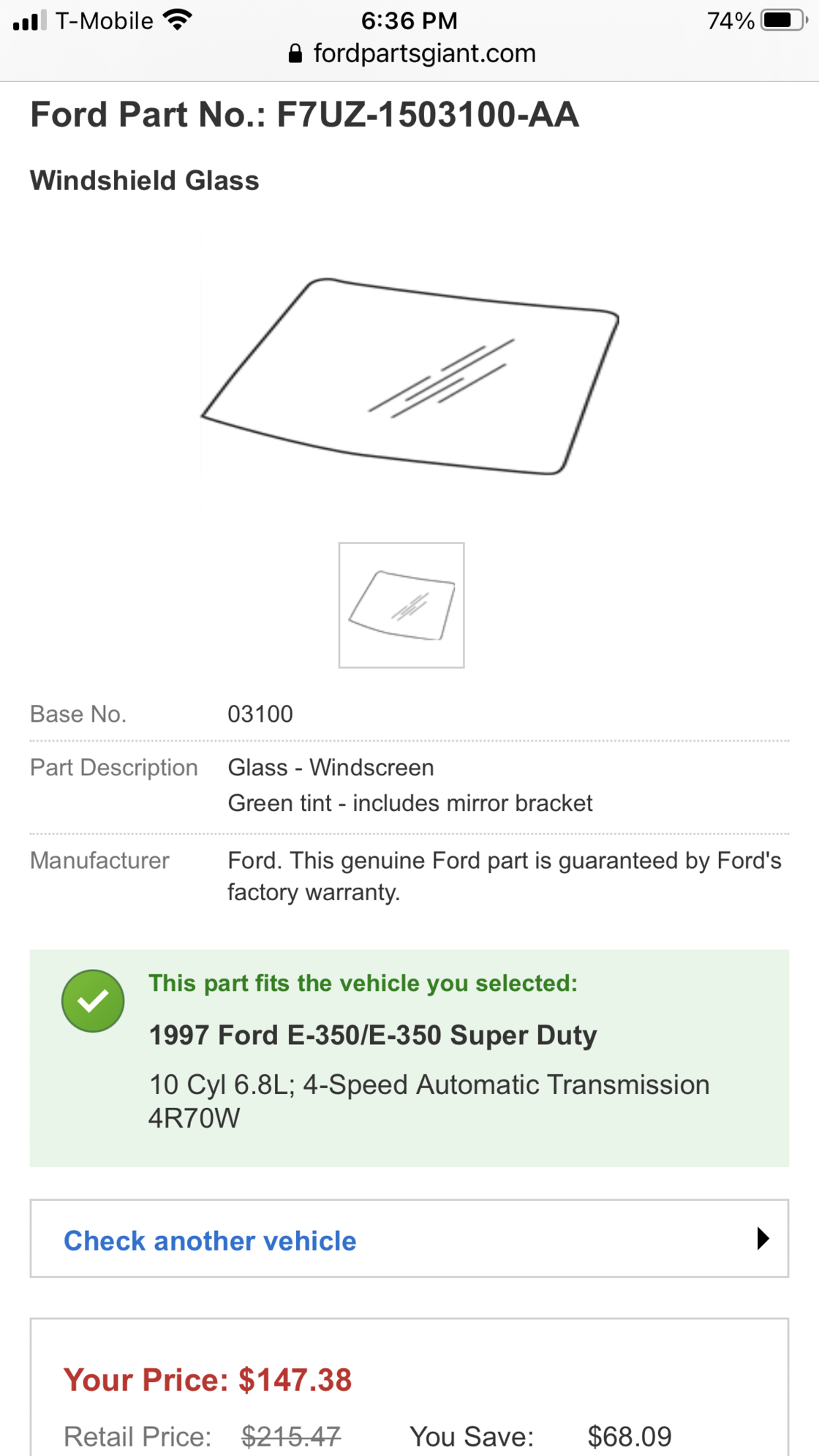

https://www.fordpartsgiant.com/parts...)&location=pd:,
This is my windshield that I had installed many years ago, my windshield is perfect with no star breaks or chips, probably only has 10k miles on it. However the moulding is showing its age and is brittle from the sun and has 2 spots where the moulding has chips. So it looks like the right way to address the moulding is to replace the windshield and moulding. The windshield part # i referenced is for a 1997 E350 , Ford shows the windshield for 92-96 discontinued .

In 1997 the windshield available up until about 2003 was a DW01292XXX----the DW01504 shown in your photo was a short-term new part the AGR industry has used until they were then replaced a few years later, the DW1624GBY. I wonder how a full E-Series windshield could be/would be shipped without it being broken in the process? Call your local dealer and ask what they show available---press them to see if they know or have the NAGS number---that would be very revealing what you'd receive.
Its entirely possible to have an experienced glass installer remove the original molding without breaking or damaging the windshield and replace it with an aftermarket will fit part with a different visible profile than the original encapsulated part. You're still best advised contacting one or more local glass shops to get their input.
