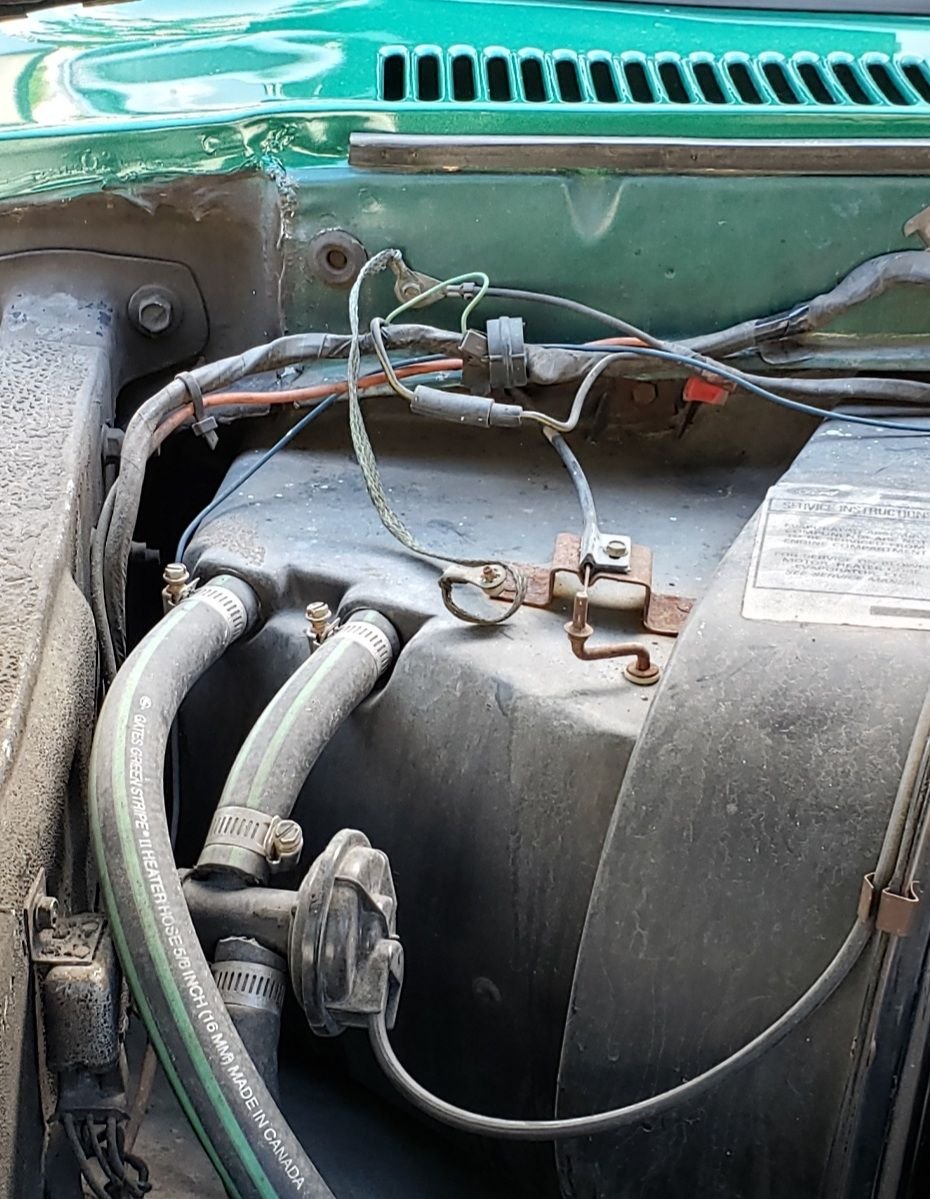

Mystery Ground Strap
I don't know why i haven't noticed this before... but I have a ground strap under the hood near the A/C box. One side is connected to the firewall. The other side is just dangling. I was assuming it was supposed to hook up to something on the A/C box... but where? Any of you other guys with a 77 A/C-equipped truck have this strap?

probably goes to the hood

X2 yes should be attached to the hood.

Yep, provided a ground plane for radio static suppression I believe.

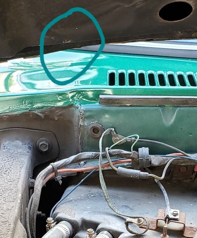

Yep! You guys were right. I found where the screw was previously. Thanks guys.

All that time I was looking on the AC box. I never thought to look UP!

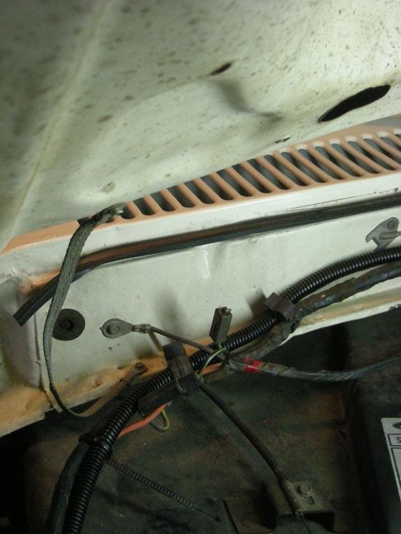

Here is how it's connected on a 1976 F-250
Ground strap to hood on 1976 F-250
