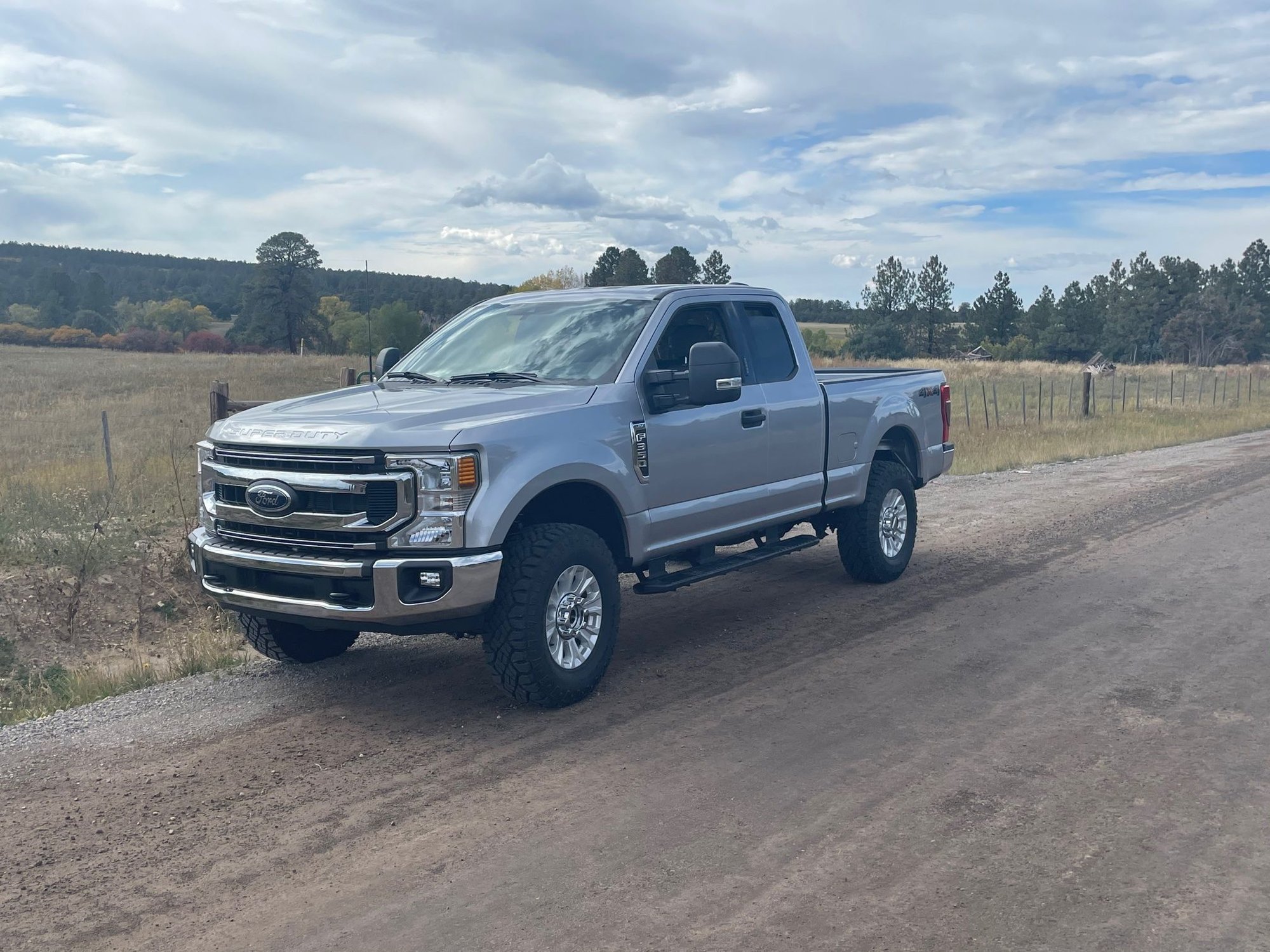

I am pretty sure these are the same wheels just not black. This is with the 285/75-18 Tremor sized Duratracs on. They are in the fenders as they should be, the rears seem like they set in slightly more but the truck looks great IMO.
I thought I had read that the Tremor wheels had a slightly different offset though so the tires would fit better with the flares, but haven't confirmed that. My truck doesn't have the flares and I think the fit is about perfect. I can still run tire chains with the mud flaps and not tear anything up.
