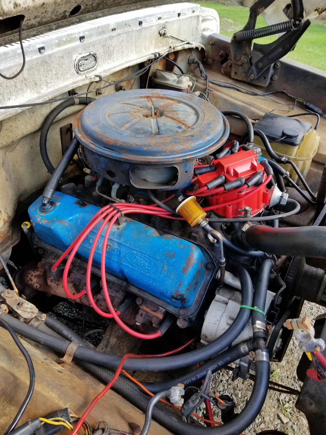

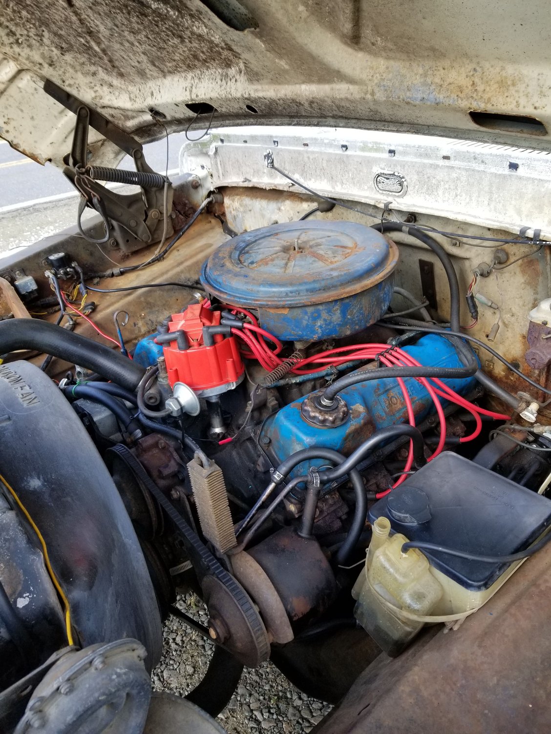

I have a 72 Ford F100 Ranger XLT that I inherited from my step father. He had recently purchased it before he passed away. The VIN says my Engine size is a 302. However my valve cover bolts show that it's not actually a 302 under the hood. I was told by former owners it was a 351M. I purchased what I know for sure is a 351M manifold that is far too large (width wise). So I know it can't be a 351M. I need help identifying my engine size. My Valve Covers are 8 bolts per side.

Appears to be a 351C. Clevelands have a lower deck height, therefore the intake is narrower.

I appreciate that input. I was told 351C and 351M had several differences. Most couldn't tell me what those differences where though. It's difficult finding info on Ford Trucks this old.

The 351M is simply a destroked 400. They(351C/351M/400) share the same cams and heads(2v, open chamber, 351c also had 4v closed and open, a whole 'nother discussion there) The 351M/400 had a taller deck height, hence the wider intake. Some more subtle differences but all in all very similar. Never offered in the trucks but see a good many of them swapped. They are a potent engine, especially with a thoughtful buildup.

I was once in the same boat, but screwing with these trucks the past year or so I've learned a ton. Plenty of info on the web. Some good, some downright bad. Up to you to weave your way through it and make informed decisions. Building a Cleveland now a Mustang project and have had to read a ton on what works and doesn't due to the heads and low compression/emissions era they were introduced, and ultimately discontinued. Look at the top left corner of the drivers side head, just below there the valve cover is. You'll most likely see a 2. You may get lucky (depending on your goals) and see a 4. Or there may be an M. This will tell you what heads it has. Looking at the valve covers, I'd imagine they are 2v open chamber Cleveland heads.
Before get trigger happy throwing money and shiny edelbrock stuff on it, do some research and figure out what your plans with the truck are.

2 big tells on identifying 351M/400's is that the upper radiator hose connects to the block, not the intake manifold; and next to the distributor is a cast rib.

My hose connects to the block, not the manifold. It's not a 351M. 351M intake I have is purchased and confirmed be Edelbrock as a 351M intake. It is too wide. So I would say the 351C also connects to block. From what I'm seeing from looking into 351C intakes, I would say this is confirmed.
