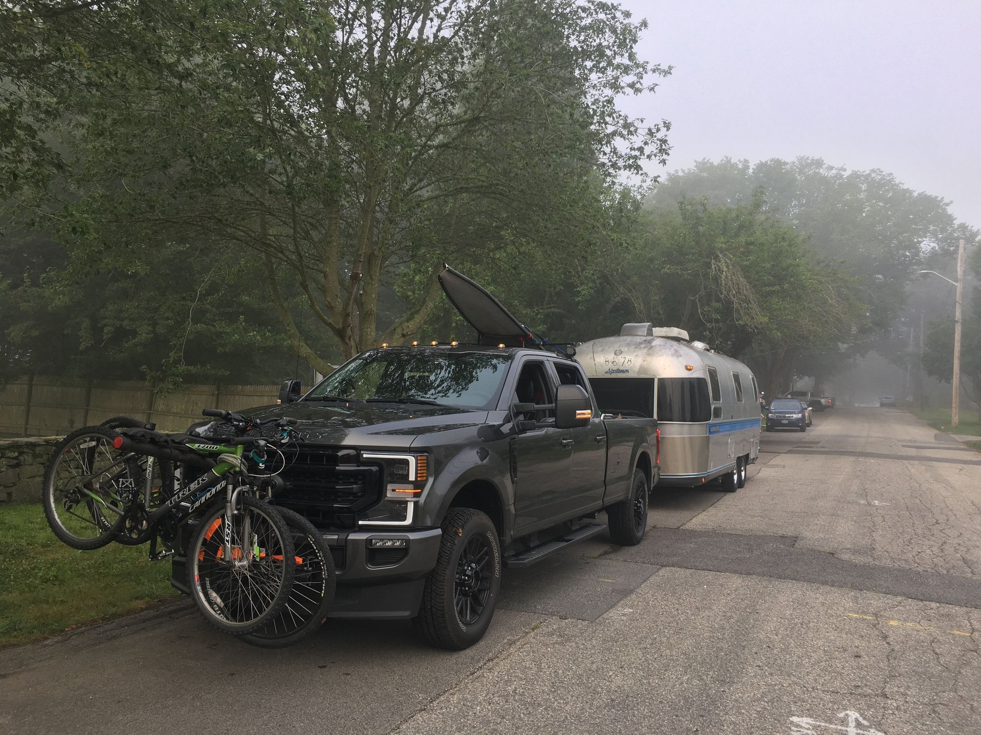

We tow > 12,000 lbs of Airstream and “stuff”. No problem at all through mountains of New England. Average ~ 11.5 mpg. No doubt the new ten speeds help, but sounds like you had something wrong with your setup. I tow more than 1500 lbs with my Wife’s Subaru no issues. Maybe you need a Subaru.
p.s. I towed/hauled with diesel for 15 years before this truck.
