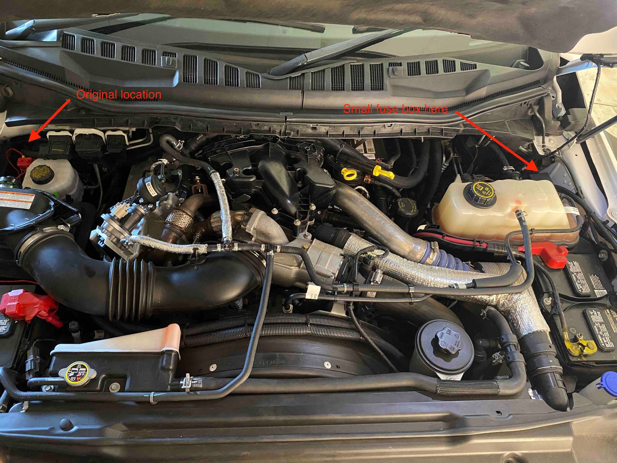

Hi,
Not sure why there's no replies. I hope these pics help explain.
After the conversion to RHD, the engine compartment fuse box is not where the owner's manual says it used to be. Can anyone tell me where their fuse box is located? The fuse box in the cabin by the driver's accelerator is original and not been modified.
Is this small fuse box - the one they refer to in the booklet? It has the upfitter wires coming from it.

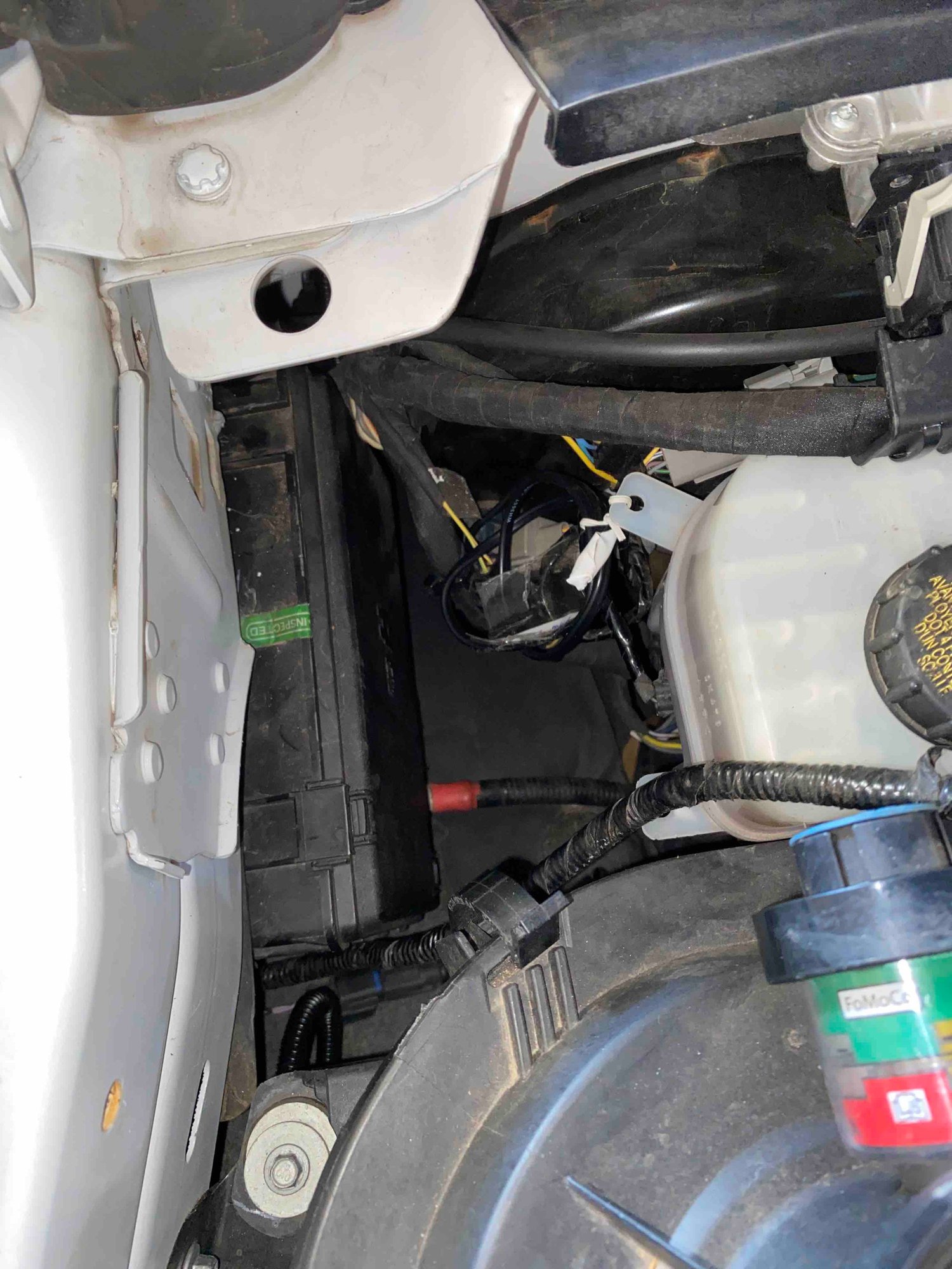

Found it RHS rear of engine compartment hidden under some plastic fairing. It's jammed in so tight that the cover can't be removed unless the cables are disconnected (top right of pic)
