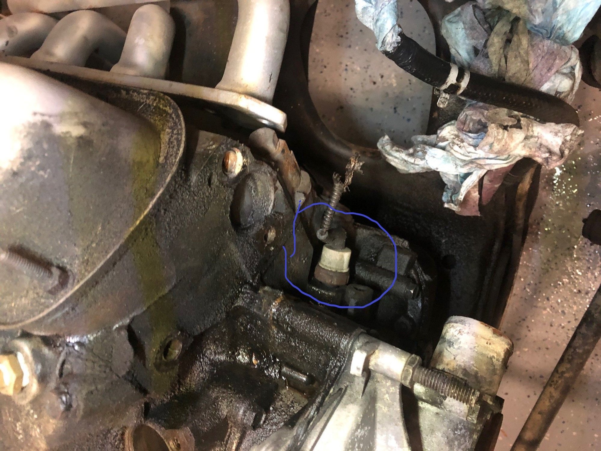

In process of stripping down engine for removal I found the circled sensor with a broken wire leading to it and don't know what it's for. Had no codes and haven't found the other end of the wire at this point. I can tell it's been like this for a long time. It threads into the block. Not sure what year the newly rebuilt block is, but it does not have a provision for this, no threaded hole. Tis confusion.

Looks like the oil pressure sending unit to me.

Yep. That’s what it is.

Is there a different location for this sensor on blocks from earlier years?

Not as far as I know. Does the oil pressure gauge in the cluster work?

Unless my memory is failing me the gauge was working when I parked the truck a month ago. Can't verify that now though. I can post another pic of the new motor on the stand that shows just bare block where the sender is installed on the existing block. I have to think there are years where that was the case. Going to have to do some research.

Looks like a 302. That's the oil pressure switch for the gauge on the dash. If your other motor is a Windsor, it has this hole in the same spot. If this isn't the case, post a picture.

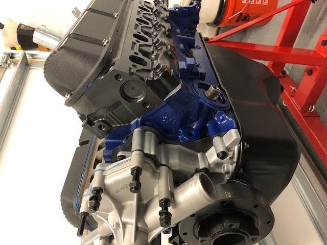

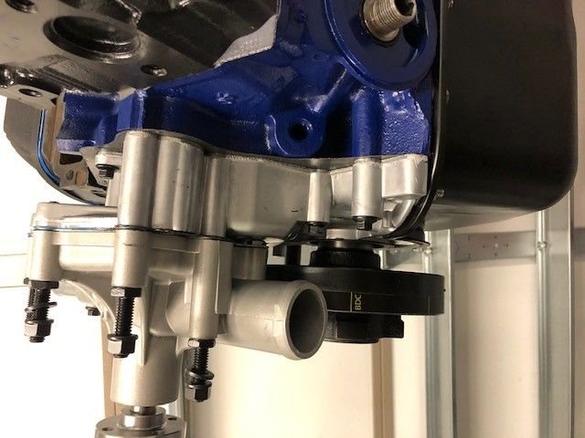

It’s a 302 block bored and stroked 347. I’ll post a pic after work
Old May 6, 2021 | 04:37 PM
chesster51's Avatar
chesster51
Joined: Jan 2013
Posts: 305
From: Middleburg, FL
Well, my ******* was wrong. Here's the proof. Must of had a few beers before making that faulty determination. Just have to find the other end of that wire now!
