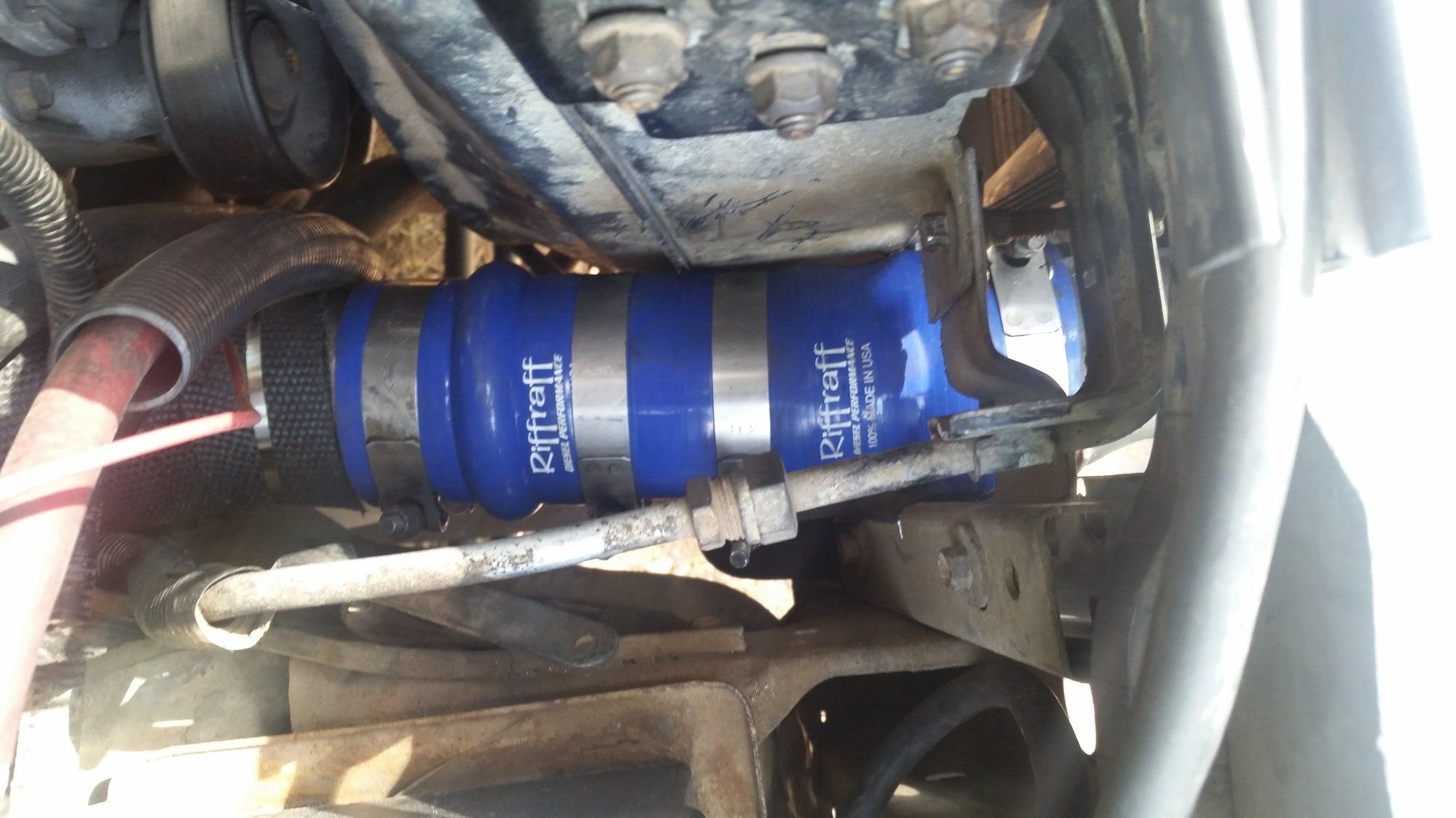

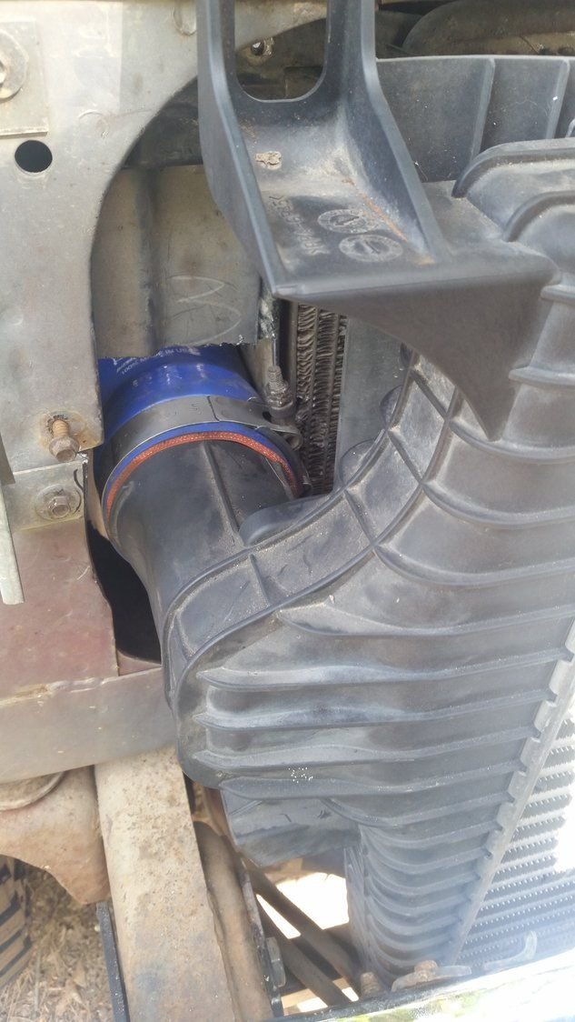

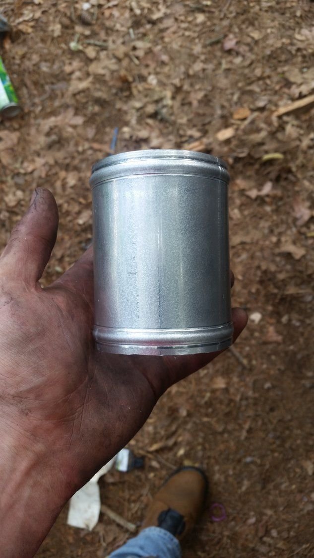

I have an extension on the IC end of the passenger side pipe, something like 4" or so. Other than that, it fits fairly well. I actually think I have my driver's side pipe upside down but it won't fit the other way so I just left it.

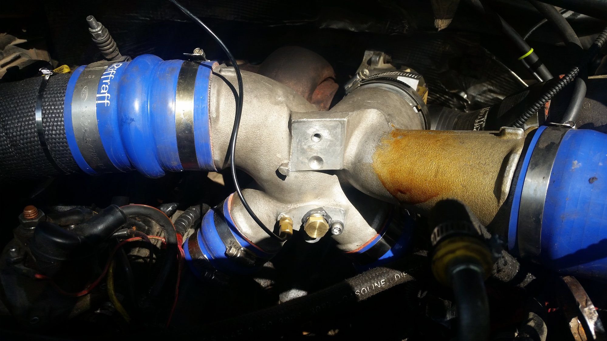

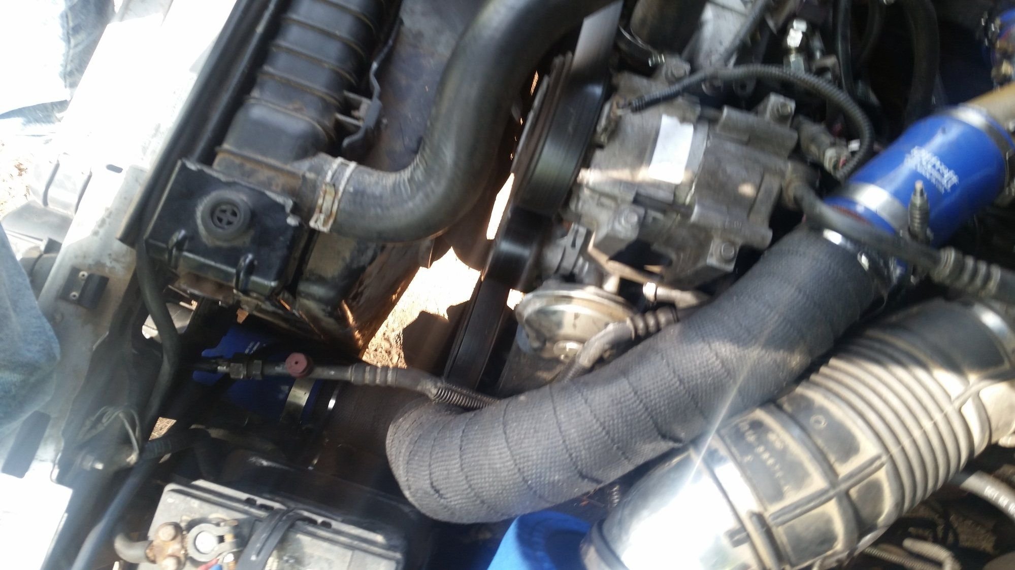

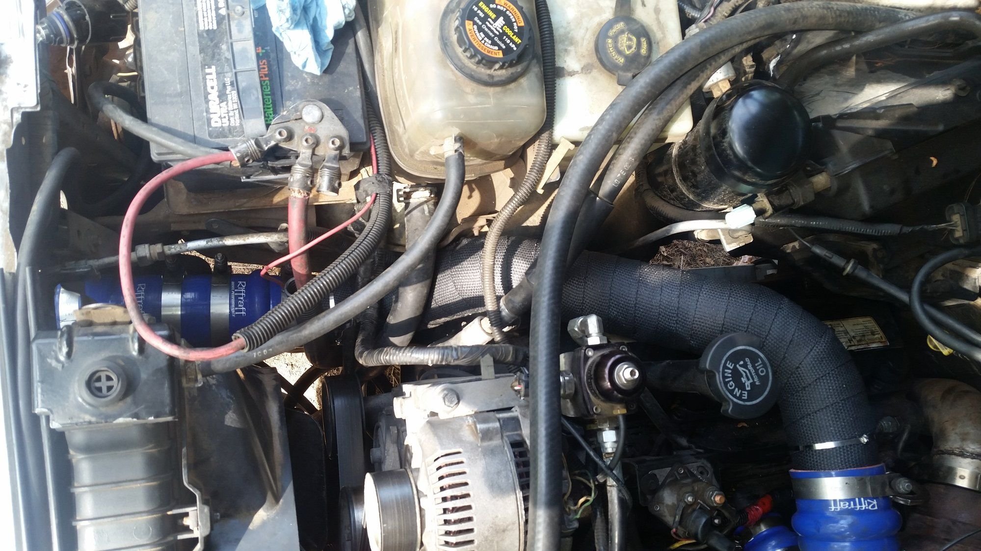

Jarret, curious to see a pic of your tube setup if you have a chance. Did you weld on another 4" or use another boot?

I used another boot. Let me see if I have pictures on my computer...

Cool. Thanks for sharing those pics. That helps a lot. Like the wrap you put on the pipes. I was wondering about those fittings in the spider. Guess I will drill and tap them to NPT and plug them.

Yeah you can just tap them to whatever you have laying around.
I used header wrap for my pipes. In retrospect, I should have looked up the proper application process for it (soak it in water and then wrap as tight as possible). I also put spare used E99 IC boots that came with the kit over the pipes on high contact points to prevent wear and then covered them with the wrap.

If you need that extension pipe, I can make another. PM me if you're interested.
