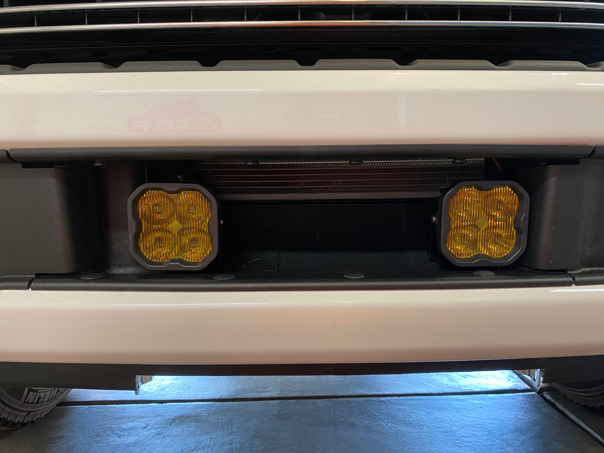

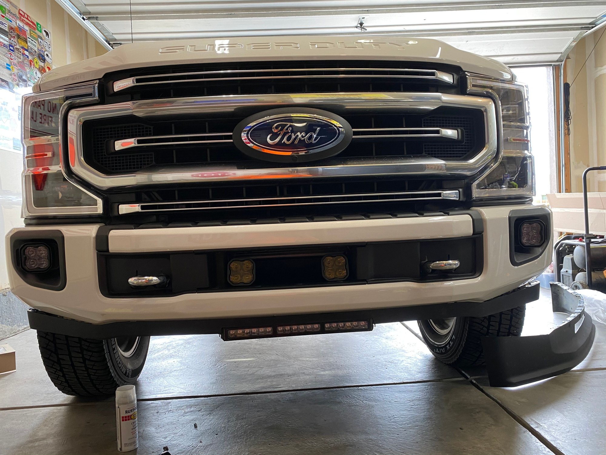

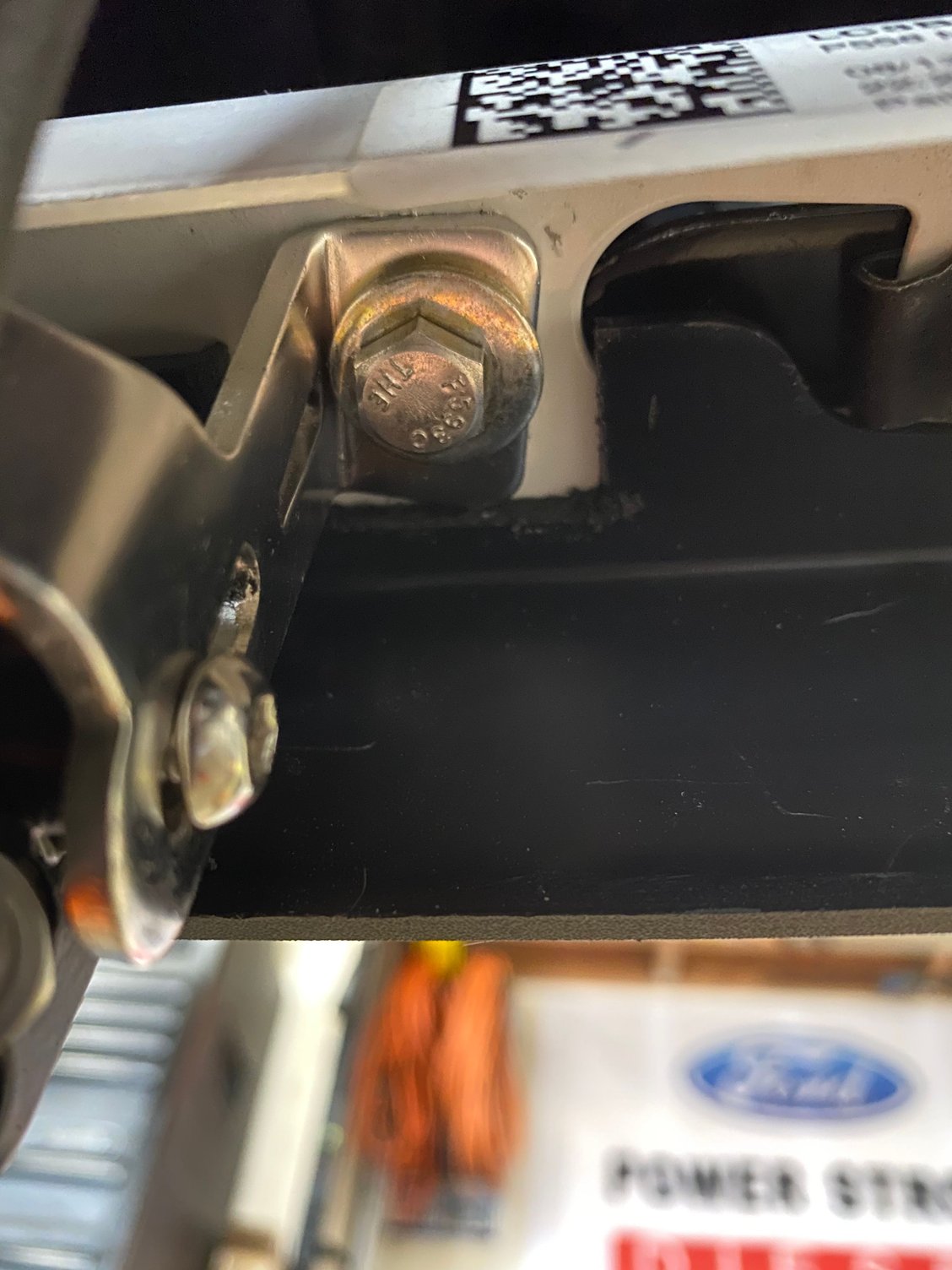

Converted from OEM LED to the Diode Dynamics SS3 Pro. Had to buy the OEM halogen fogs and trim rings. Diode kit fit perfect connector and all.
I mocked up flush mounting the 18” bar in the 4x4 valence but didnt want to try and maintain the right trim all the way to the edge. I didn’t like the snowplow valence so I installed a tremor valance.
Too many expensive system integrated into the grill and I didnt want to trim it. So I flush cut the 1&” Diode Dynamics into the tremor valance. Easy to mount.
Tomorrow I will mount the Diode SS3 Pro Amber in the front. Yes I know they arent symmetrical. The drivers side has the Adaptive Speed sensor on the drivers side you can see the plastic is larger on that side.

Nice clean install.
You need to post one more pic with all the lights on!
Were you ever in the Navy? Truck uses radar, not sonar

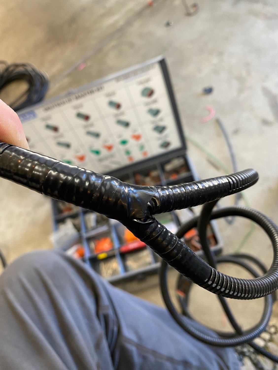

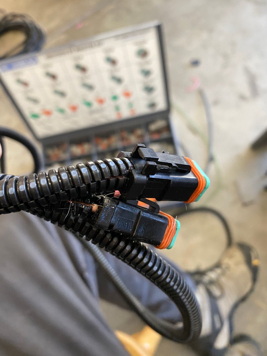

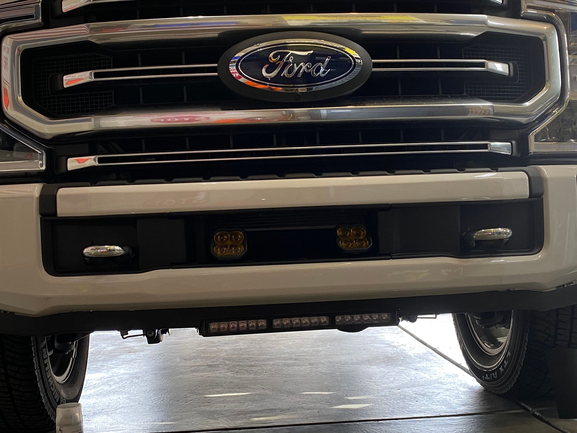

Mounted the Diode Dynamics SS3 Pro Amber fog and grill lights. Built a super clean stealth harness. Looks like upfitter 1-4 outputs are 12g and 5-6 are 10g. My Deutcsh kit didnt have 12g pins so I need to order them. Next up are the rear SS3 Pro and the ARB compressor

Are those little lights behind grill strobes?
Old Apr 26, 2021 | 07:36 AM
Squirrel13's Avatar
Squirrel13
Joined: Sep 2018
Posts: 1,115
Likes: 264
From: KY
No just simple amber LED.

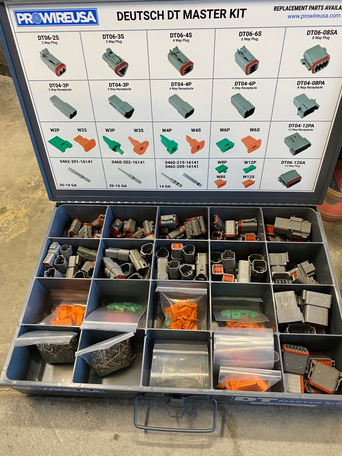

They sure do. The connector kits can be what ever you want. The expensive part is crimper but buy once cry once and finished product is worth it.
https://prowireusa.com/deutsch-kit-builder.html
https://prowireusa.com/hdt-48-00-deutsch-solid-barrel-crimping-tool.html
