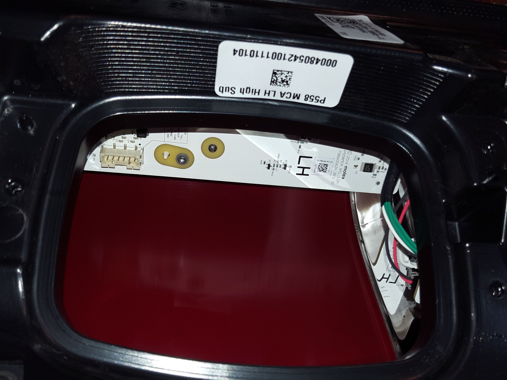

LEDs are pre installed, I looked at my old one for a way to remove them but the only way is to split the lense assembly. i think thats why the cost is up there, many small screws way up inside and impossible to get to unless you have long spider fingers and a very very small bit
i saved my old on incase decided to split it and use the leds for some other project
