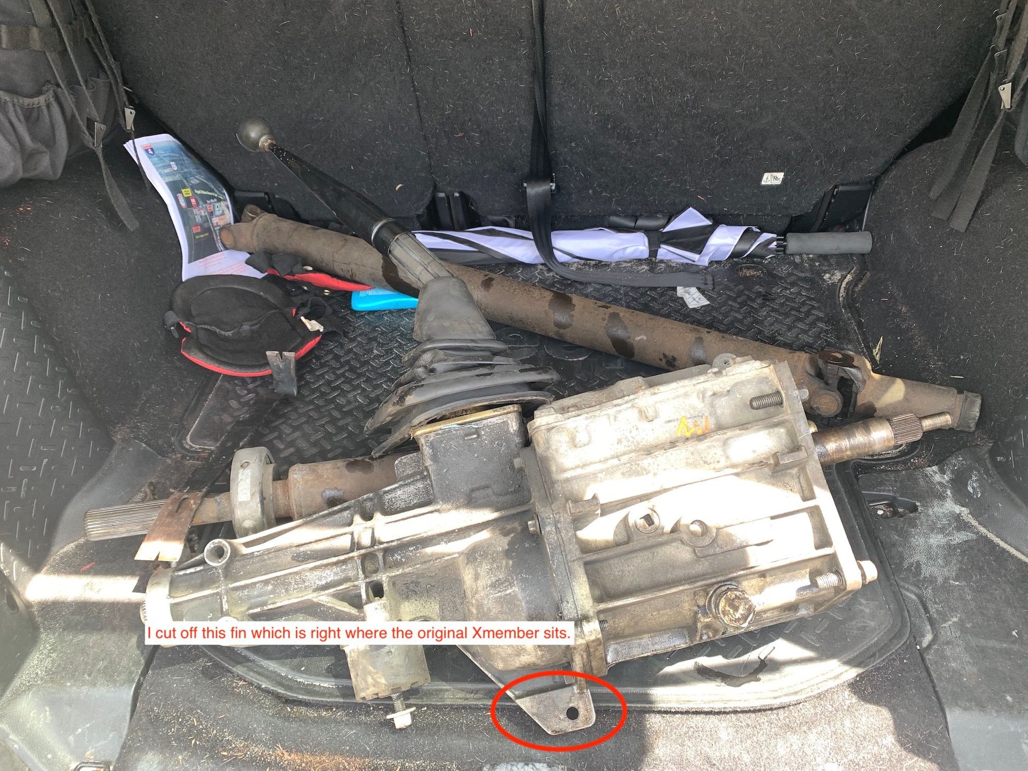

The T5 will interfere with the crossmember. Specifically, the little fin at the bottom. I just cut it off.

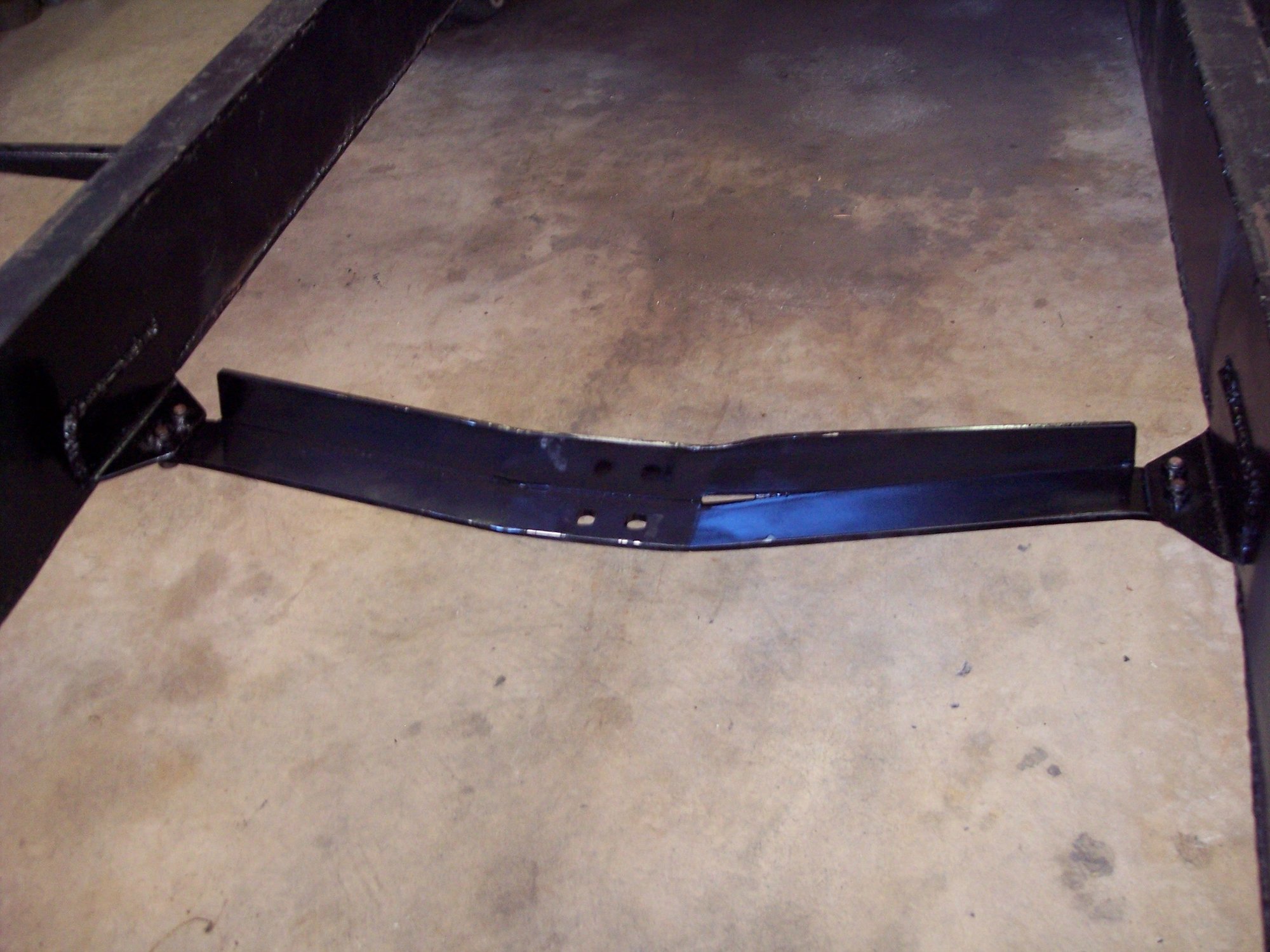

On an F-1 the crossmember is a few inches further to the front than on an F-3, and the crossmember is very different. You have to cut it out in the center, no question. The frame needs to be restrained while doing that or the rails can spread. Then you need to add a new crossmember for a trans support. Here are some examples of what's needed.

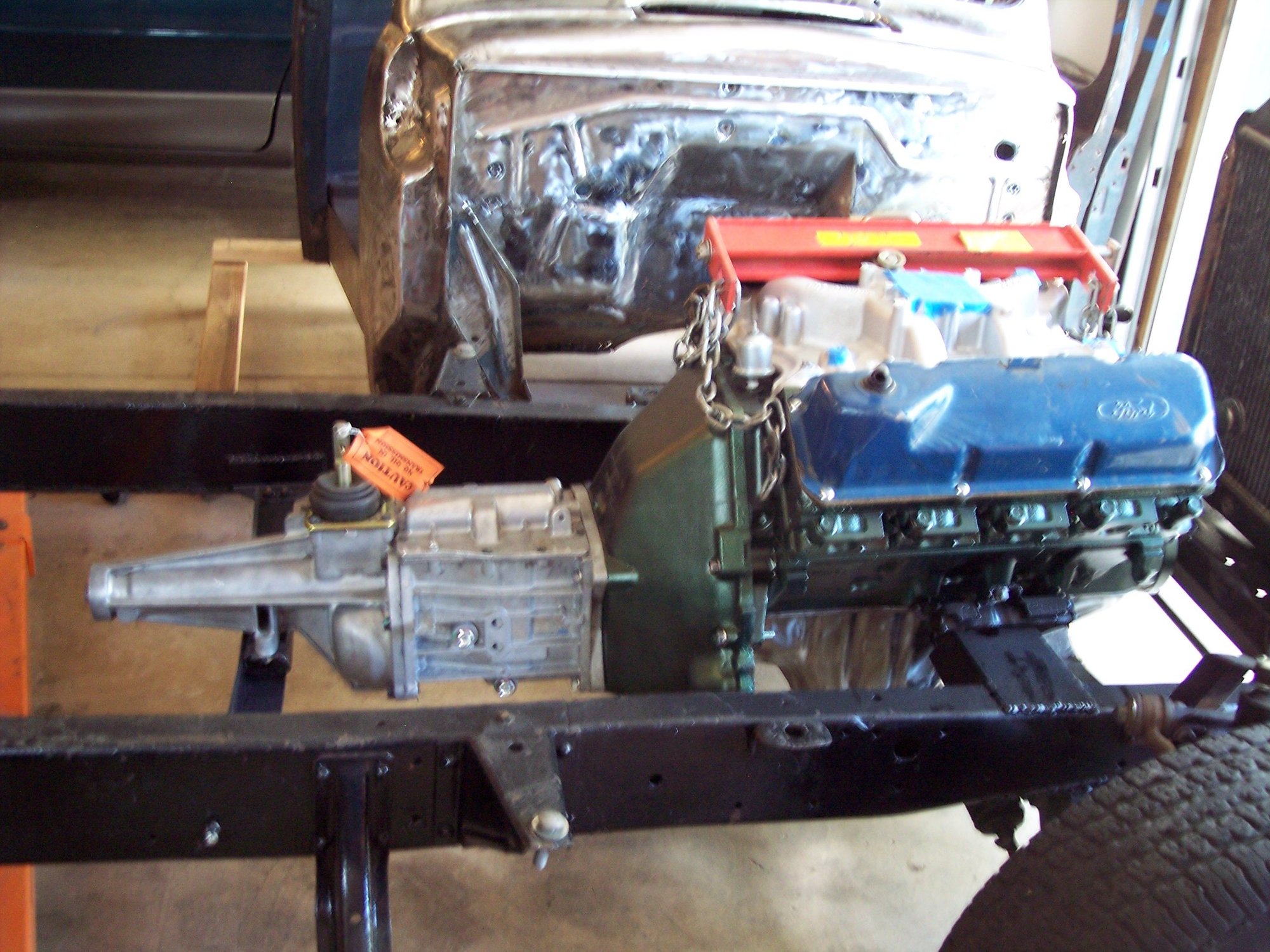

This is how I mounted mine.
Tlta29
Apr 5, 2021 04:00 PM
lalberts
Feb 12, 2018 01:22 PM
firemanp
Dec 28, 2017 12:12 PM
CrzyColt
1961 - 1963 F100 Unibody
Jul 26, 2017 11:39 AM
