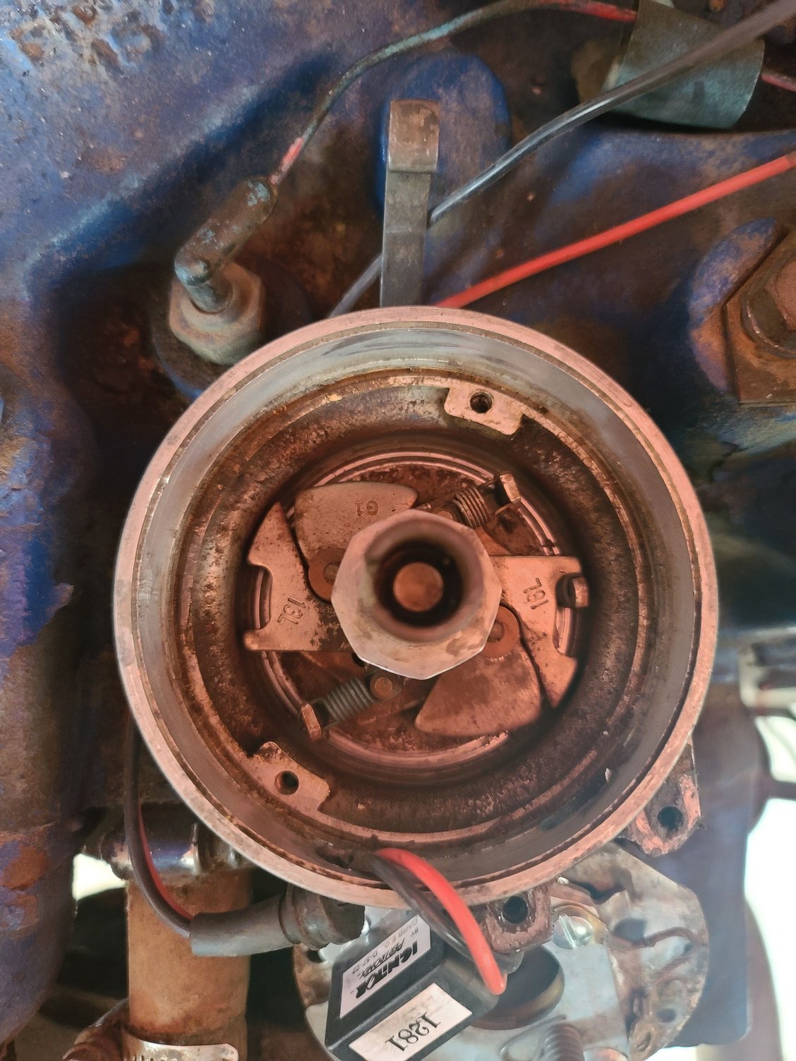

Looks like the mechanical arm in use says 18L. It does have a sleeve around the post so maybe it's more like 16 or so. Still, that's 32 degrees advance right? I'm thinking I should just flip it to the 13L side so it's down to 26 degrees. That should take care of the egr curve I think? Please let me know if I'm headed in the wrong direction. Thanks!
Edit: The vac advance is hooked up to the ported "nipple" on the passenger side of the carb, just infront of the choke.
I agree. I would flip it to use the 13L and then set my idle timing to ~8 degrees. Adjusting from there.

Thanks! I'll read through it this afternoon. Late last night I did flip the arms to the 13L and set my timing at 10 initial. That gave me 36 total. I was alone so I couldn't check what rpm in came in at because I was working the timing light and throttle. I believe that got rid of the egr curve because I don't hear pinging anymore (I think). I will just leave it plugged off until I can get a delete plate.
