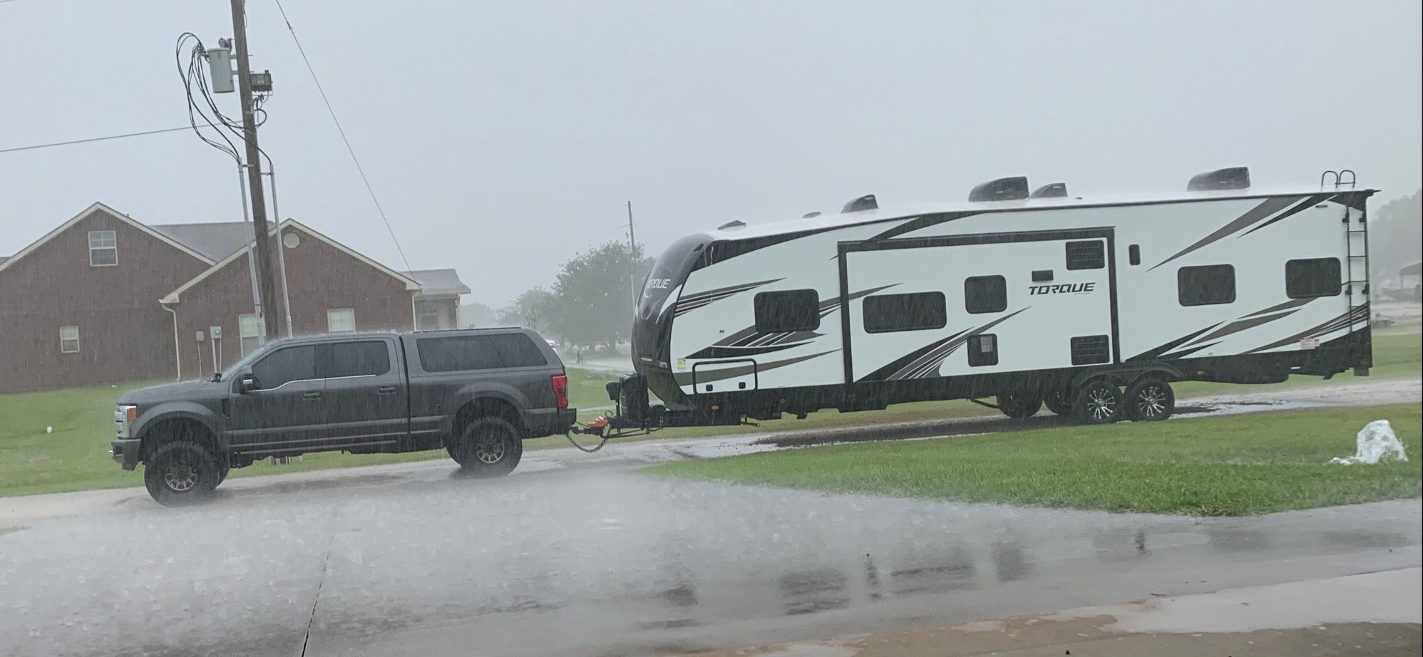

I pull a 38 ft over-all-length toy hauler weighing right at 13K lbs with my 17 F250 running 38" tires, and the Hensley hitch allows me to run the interstate speeds with zero worries. I have installed this same hitch on 3 campers now and will continue to move it to the next one any time we purchase a TT.
