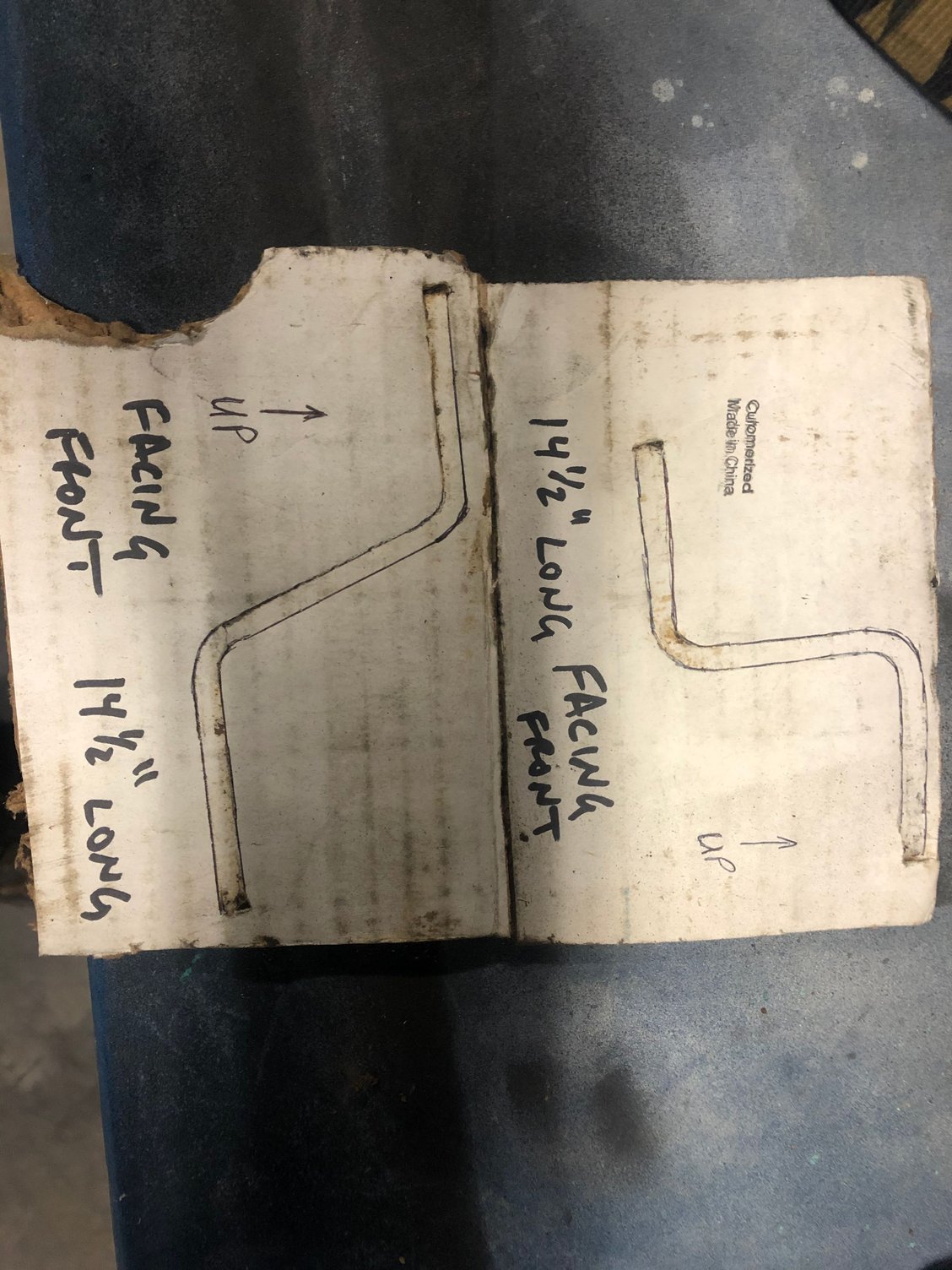

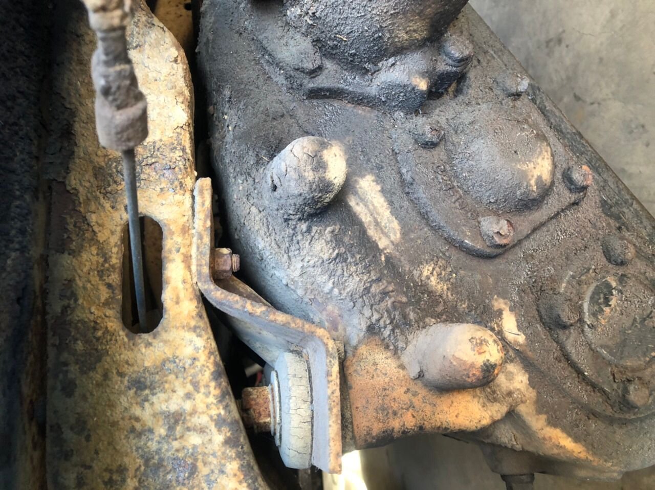

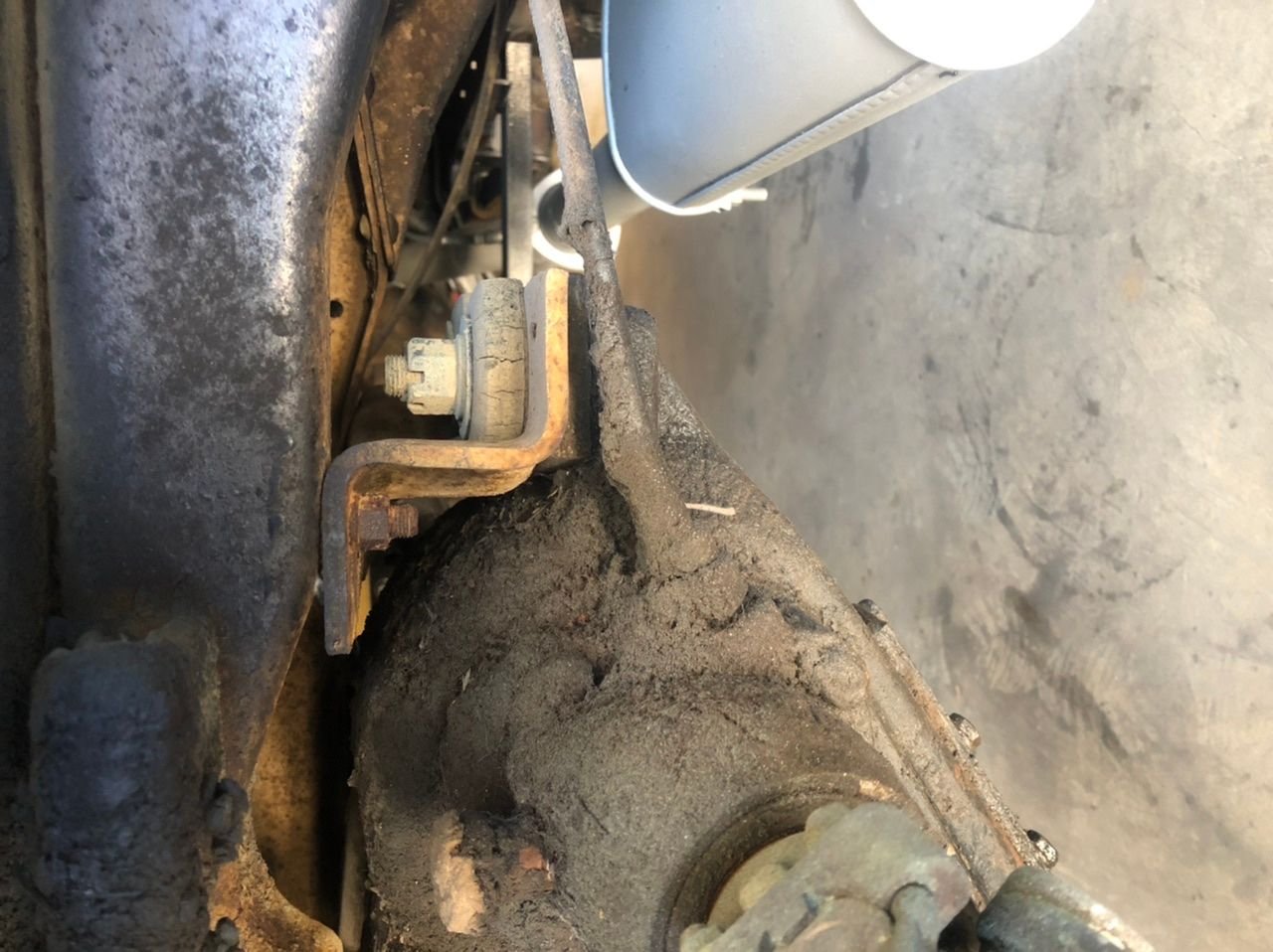

Does anyone have a source for these brackets to mount the Dana 24 transfer case in a 1960 truck?
Back to front view
Passengers side
Drivers side
I have all the rest of the running gear to make a 2wd into vintage 4wd except these D24 mounting brackets. Numberdummy or anyone know if there are any available?

Looks like you should be able to make a set that are close enough that almost nobody could tell were not original.

The brackets appear to be bent 1/4” plate 14.5” long. Theoretically could weld plates together to approximate these but it would take a large break to bend these...

You could also heat them up and bend to shape and even attch a gusset if you wanted.
