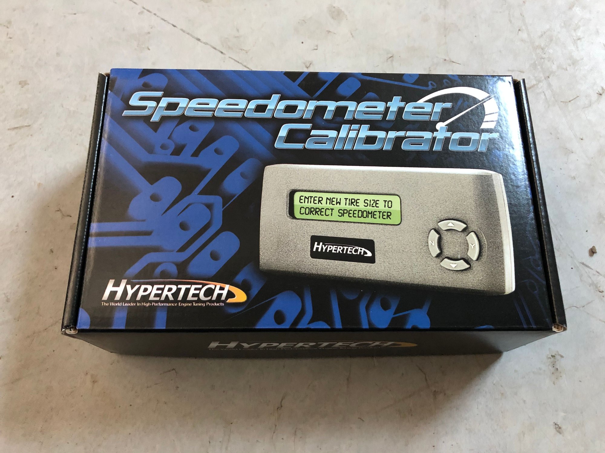

What's the best way to recalibrate the speedo on these trucks? I used an Edge programmer back in the day on my 05, but I don't want to tune the Ecoboost, stock power is plenty for me, I just want it to last. Can you use ForScan? I already have one of those.

You can use FORScan but I thought there was a limitation on diameter it can adjust to... Maybe that's incorrect.
Few videos on youtube how to accomplish

I was under the impression that Forscan could only choose between OEM sizes. JKBrad used a programmer for his speedometer. I don't remember the name. I run a tune on my 5.0 and adjusted mine that way.

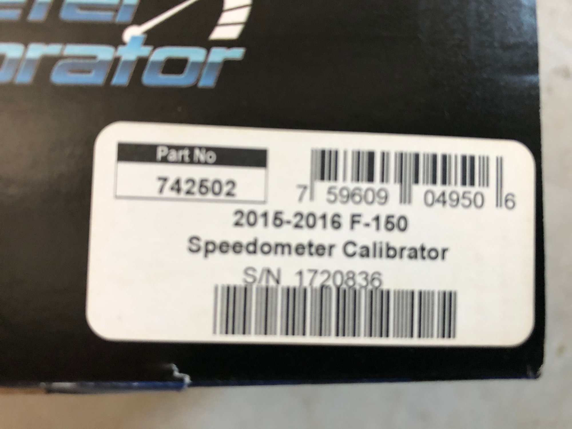

The stock Raptor size is essentially a 35” tire, so that may be an option in Forscan. The 2017 Raptor wasn’t out yet when I did mine.
I used this. I set it for 33.25”, as that is the height of the tire with the weight of the truck on them at 35 PSI. The speedometer was checked using a GPS phone app called Speedbox. My speedometer is more accurate now that from the factory. It read 3 MPH fast at highway speeds before.
