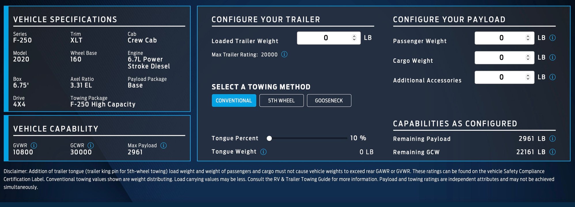

Yes, the HCTT package does make a difference. It gives you an additional 800lb of GVWR, 10800 GVWR. The white sticker should reflect that. Put your VIN into this site, let us know what it says for payload.
https://fordfleetlive.com/#/VinCalculator
I'm betting your payload sticker is correct. If this was a higher trim long bed, then I would question it, but its not. Based on payload numbers I've seen on 10k GVWR CCSB trucks, yours is right in line with what it should be considering the additional 800lb GVWR.

heres a screen shot from your link. Cool link BTW!
