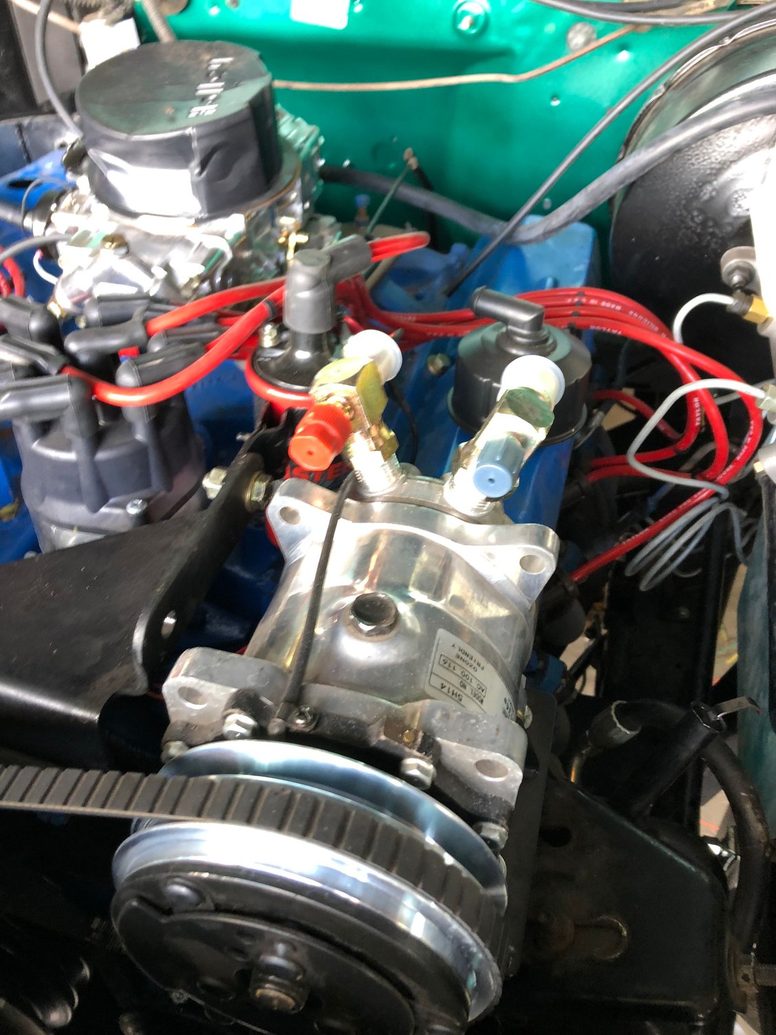

1975 f250. No purist here. I prefer what works and is easy to find and affordable. It had a/c as the under dash factory setup is still there. The heater core and ac evaporator? have been disconnected inside the box so I figure I’m gunna have to pull the box to replace them both. I ordered a sanden 508 compressor and mount. I need a dryer and condenser that mounts in front of the radiator? Besides hoses anything else? Let me know what generic dryer and condenser you have that works. Thanks guys.

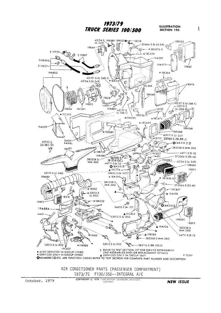

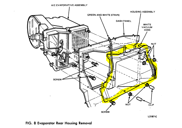

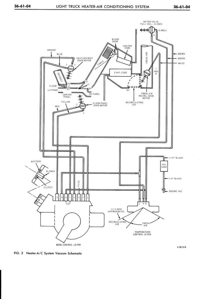

Here's a start. Looking for the other diagrams I have.

I think I got my drier and condenser on eBay. Went with sanden compressor. Don’t forget new expansion valve. Was going to buy whole kit from nostalgia air but pieced it together myself

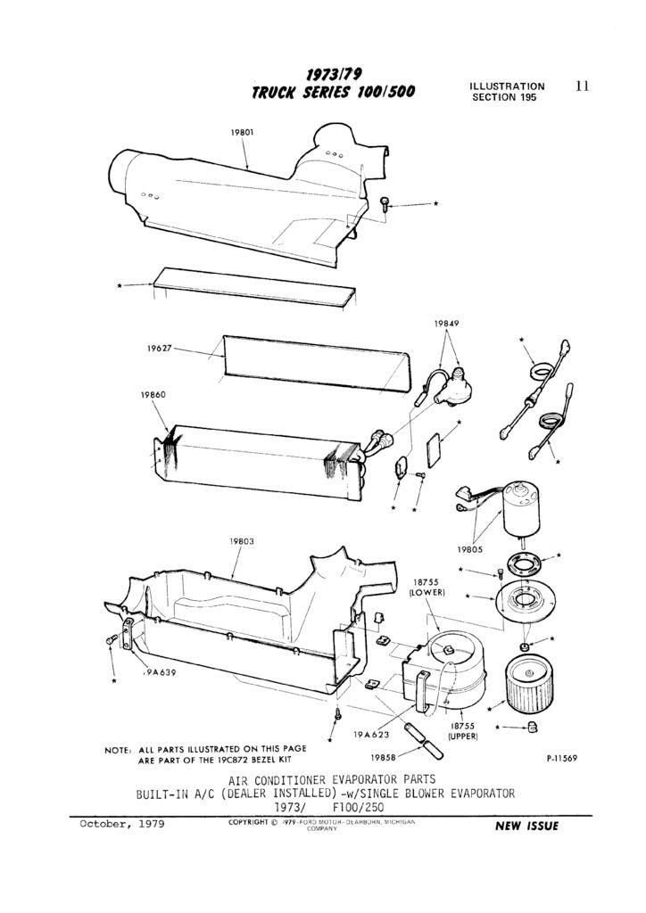

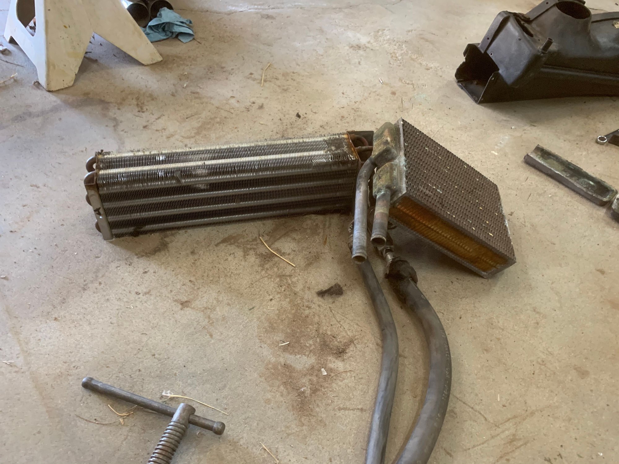

Well I tore the dash out to get the heater core and a/c core out. This is what I have.

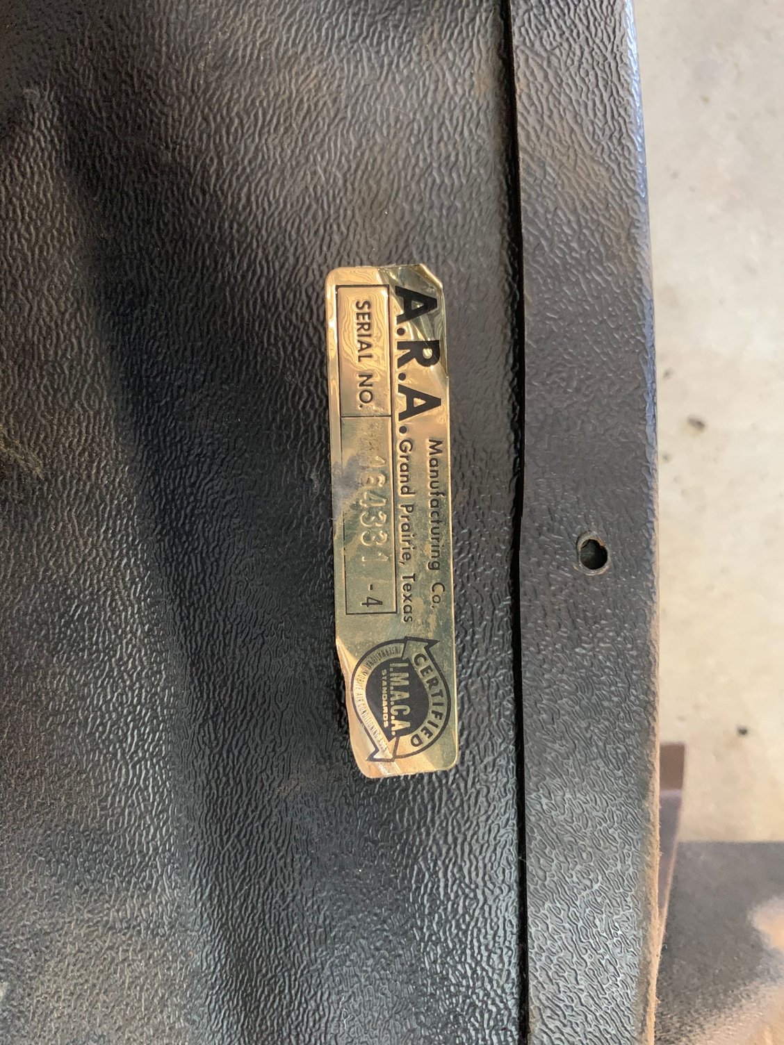

This the I assume dealer added a/c. Hope I can still get the core.
Anyone know where to get dealer installed a/c style part number 19860 and 19849?

Anyone know if they can just test to see if mine leaks? I can’t find a replacement for this anywhere.

It's not dealer AC, that's one of the many underdash units made back then and it's not worth fixing. Your options are now wide open, consider using the vintage air system.

I’m gunna see if they can leak test it and if it’s good I’d rather just throw it back in and bolt it all up than scabbing yet another unit in there.

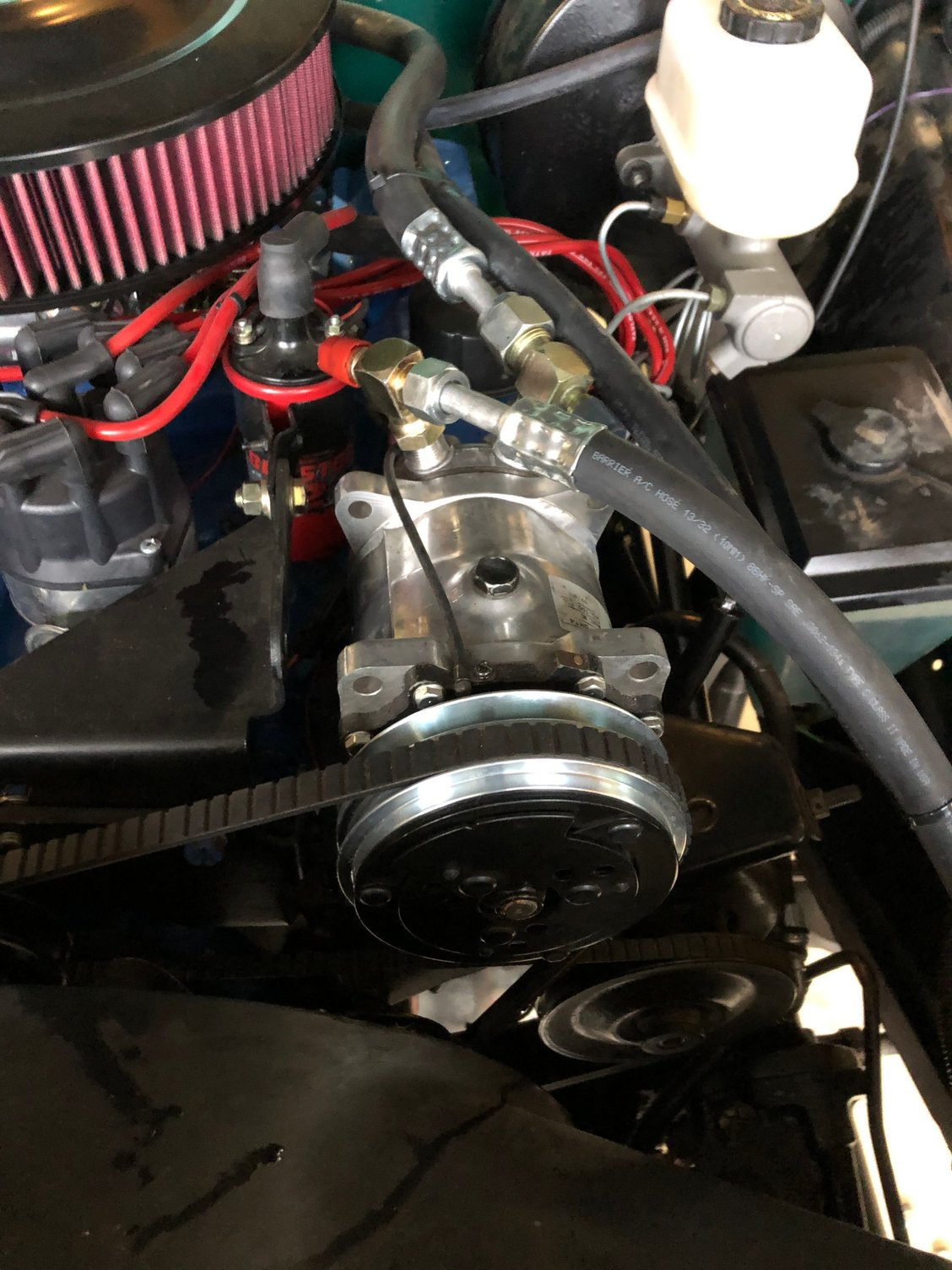

I used the factory setup on mine. I had to drain the compressor oil, blow some flush through it, add some pag46 oil, and I had to replace the service valves with some for r134a. Cools pretty good. I'll try to fit an electric fan in addition to the mechanical factory fan, that'll come on when the air is on later. That'll make a huge difference.
