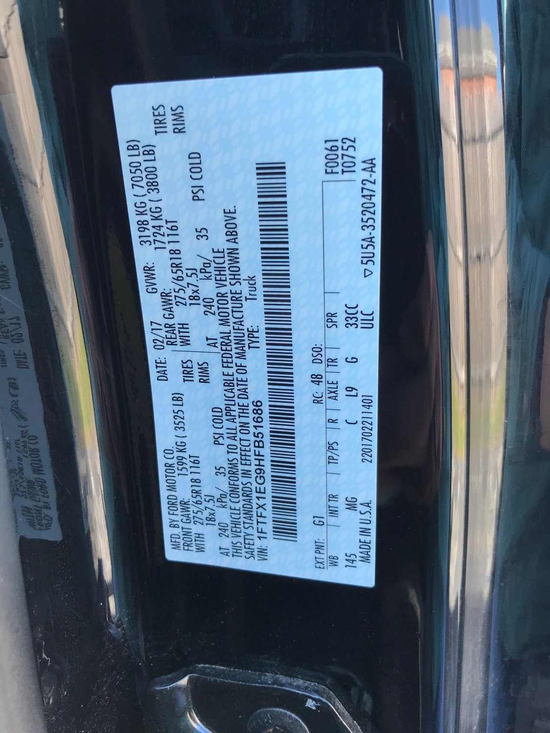

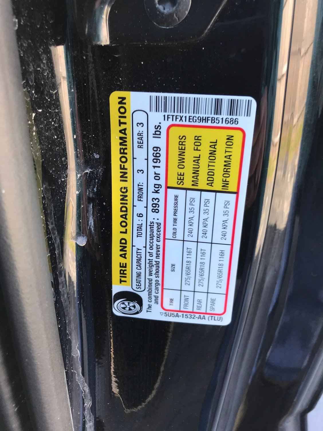

Look for the GCWR. If you want to take pictures and post them on here that's an option too.
Old Mar 20, 2021 | 02:06 PM
Kirk l's Avatar
Kirk l
Joined: Mar 2021
Posts: 7
Here you go
Here you go
Old Mar 20, 2021 | 02:29 PM
muhford's Avatar
muhford
Joined: Mar 2014
Posts: 1,272
Likes: 130
From: Missouri
I thought they put GCWR on the sticker. Your max trailer weight should be between 10,700 and and 11,900 according to this chart. https://www.ford.com/cmslibs/content...50_r3_Nov8.pdf

GCWR isn't on the door frame stickers for my F-350 either. Not on the window sticker either. I had to figure it out based on the Ford towing guide. Ford doesn't make it easy.

Whether you have the 2.7 Ecoboost or the 3.5 Ecoboost, 7,000 pounds should easily be fine. muhford's 10,700-11,900 seems accurate for the 3.5 Ecoboost. If you ever get around to hooking up that much weight, some research, and maybe an F-250+, is warranted.

Originally Posted by Kirk l
Here you go
Here you go
Well based on the Vin prefix that's a F150 supercab 4x4 145" wb. That means 16k GCWR and 10,700lb max towing ( Payload is the ultimate factor).
