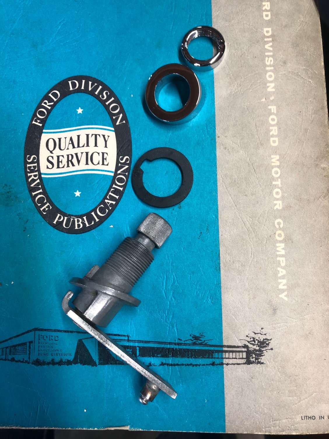

Putting my wiper pivots in, and I’m not sure if the cork gasket goes on the under side or top side. It looks like it was disassembled with the gasket on the underside, shop manual does not tell me the details on this. I would think it goes top side, but does anyone know for sure?

It goes on the pivot, seals to inside of cowl.
Thank you for the confirmation. I guess Ford knows best, at least sometimes 🤷🏻‍♂️

Cork? Well, just so you know Ford originally used Leather there. Rich Corinthian Leather - yeah right! But, here's a pic of some. I laugh that they used Leather in this location.
C1TB-17A475-B - SEAL - WINDSHIELD WIPER PIVOT SHAFT TO COWL TOP - Leather

Oh, you are right, I think it probably was leather. I don’t think the replacement from China
is leather.
