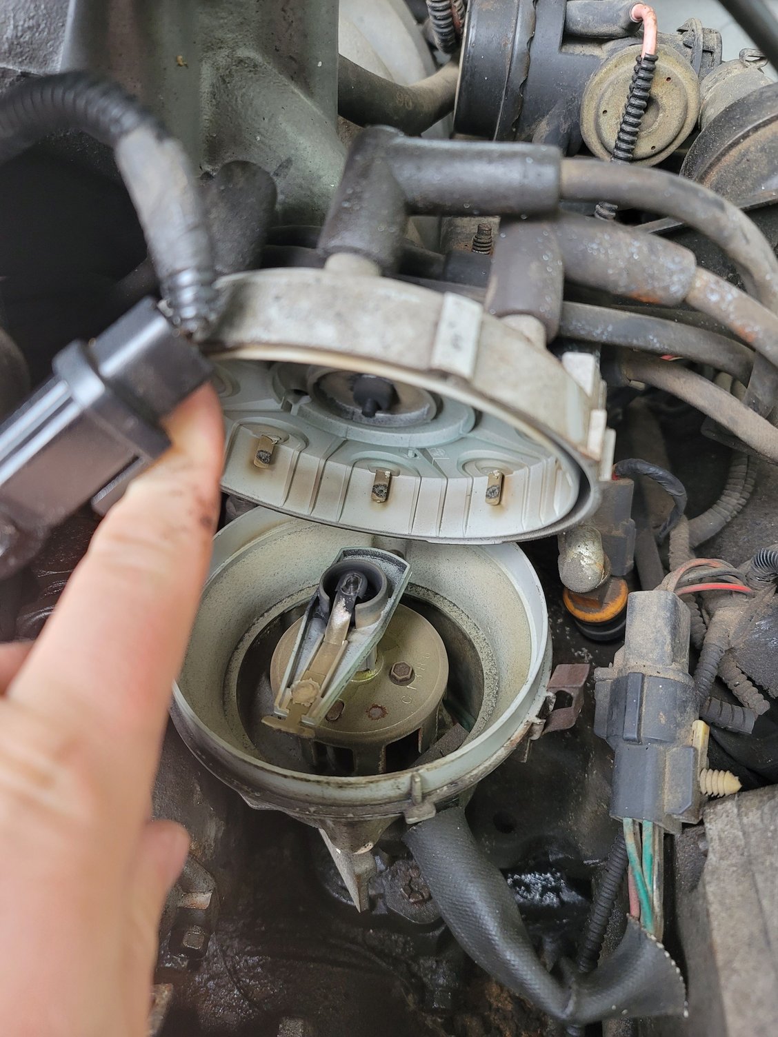

It's Back!
Same issue as before. Truck ran and drove on Friday, it rained all day Saturday and now, Sunday, it won't start.
My first thought was the distributor getting moisture in it, any thoughts on how this one looks?
Old Oct 10, 2021 | 11:39 AM
SFaulken's Avatar
SFaulken
Joined: Nov 2009
Posts: 2,190
Likes: 620
That cap and rotor are completely shot. Replace them. That's not moisture, that's just being worn the heck out.

I presumed it would be best to replace the entire unit, seeing that the cap is loose and the clips are rusted. Is that not the case?

Also, I went out to the truck just now and it fired right up. It's definitely affected by the humidity or the recent rain.
Old Oct 10, 2021 | 05:58 PM
SFaulken's Avatar
SFaulken
Joined: Nov 2009
Posts: 2,190
Likes: 620
No, it's pretty rare to replace a distributor, unless you lose one of the shaft bearings, or some such. Given the condition of your cap and rotor, it's not surprising in the least that it acts up in humid weather/after rain.

Thanks, you just saved me $100, provided you're right. Do I need to be concerned about the clip-arms being worn out, or should they probably be fine.
