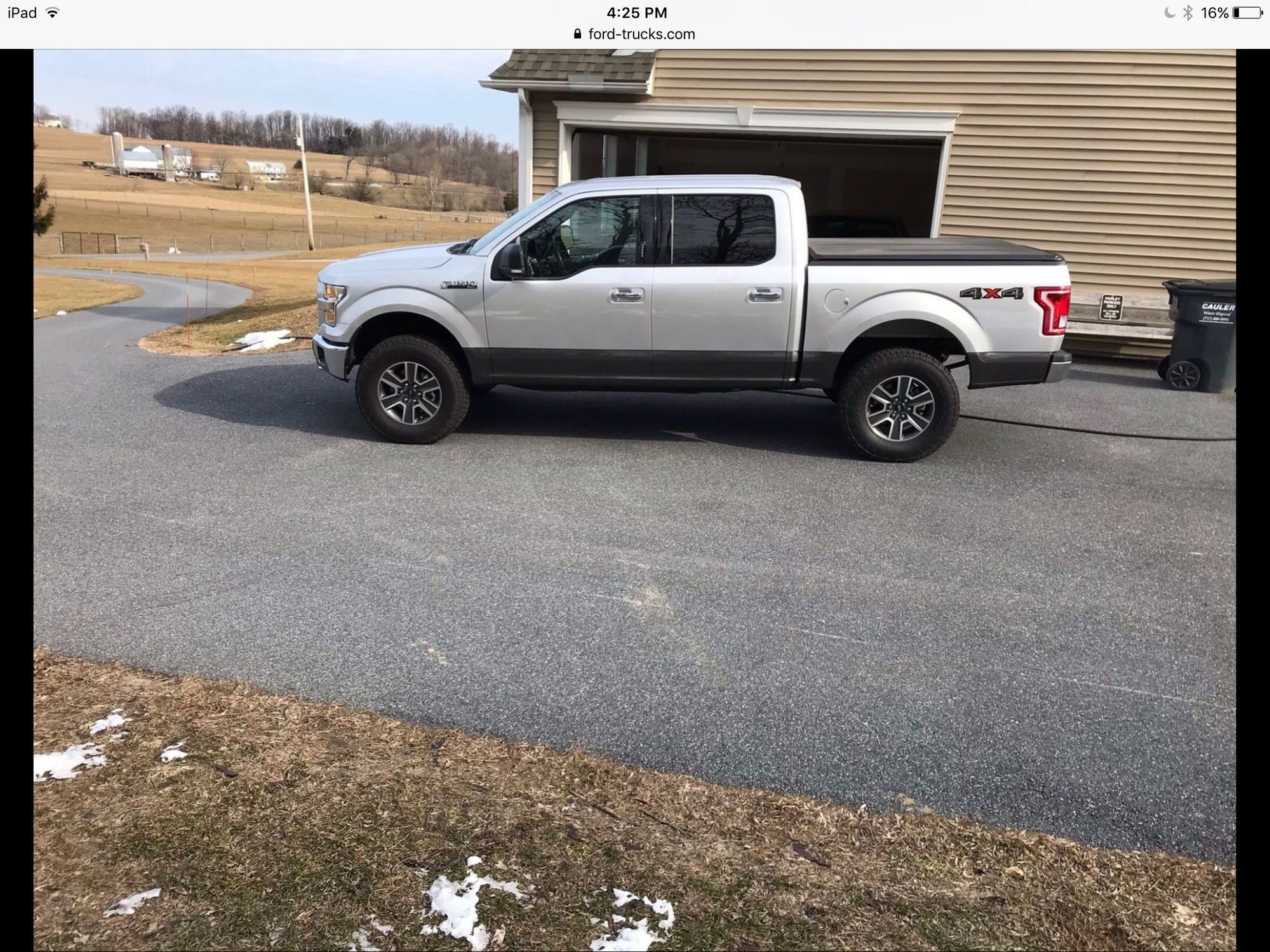

From: Lancaster county, PA
I did a ready lift 2.25" inch up front.....then removed the rear block and did a 3" block in the back...it lifted it a little bit then also gave it that "factory looking rake".....
